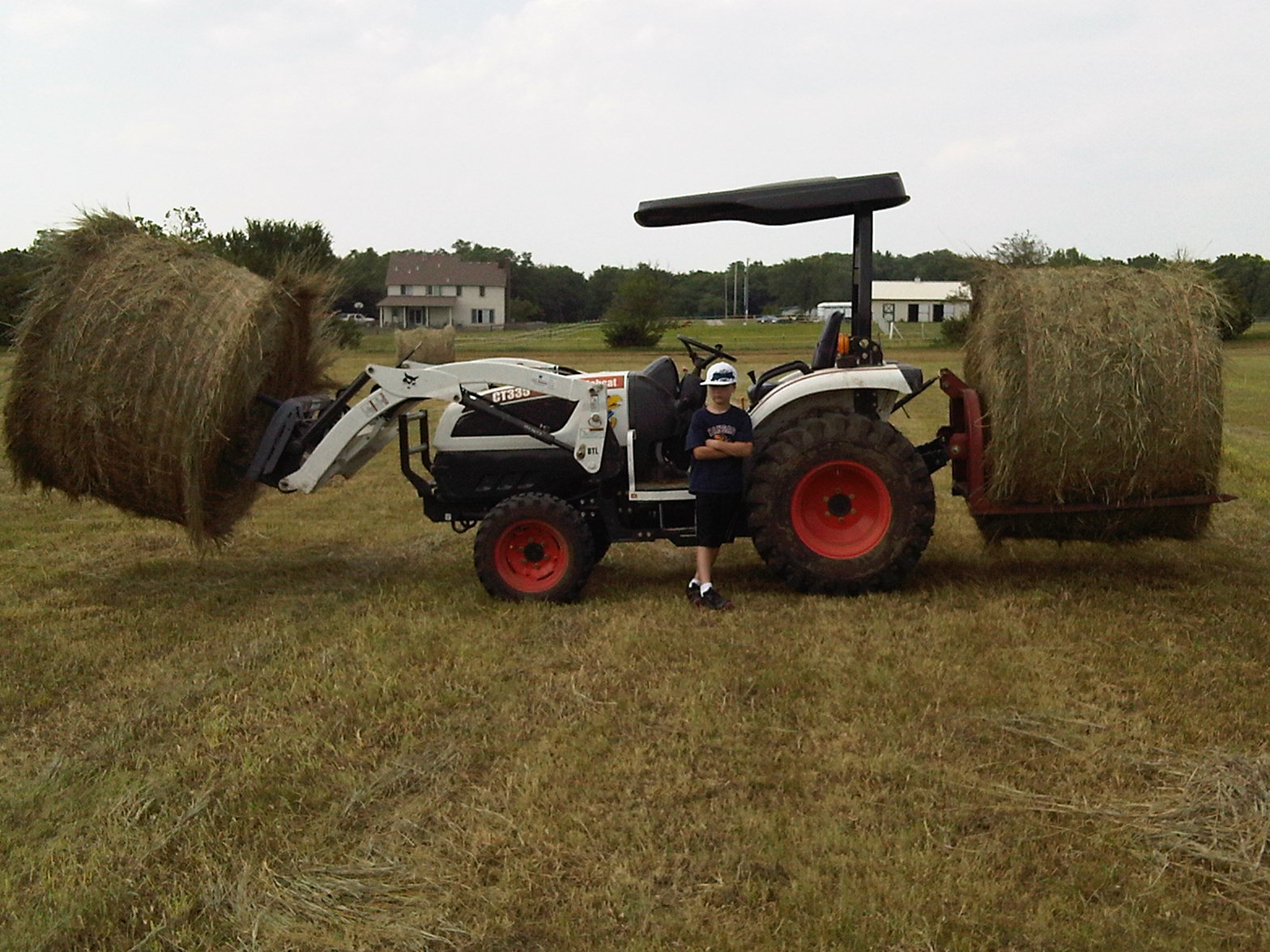

This is the bobcat cousin to the DK35....and my trusty assistant. I am not going fast when moving these but it is not problem on level ground. These are probably 900 pound bales. I run a 5 foot bush hog easily. That is what I had when I bought the tractor so cannot justify getting a 6 but would not hesitate. good luck.
