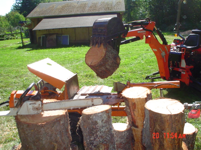

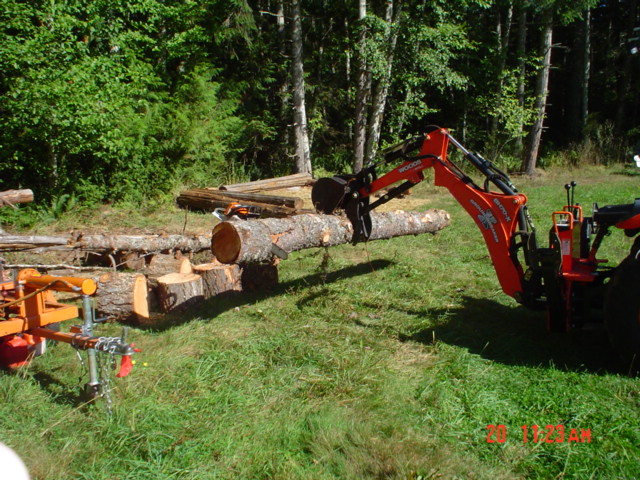

I have a Woods BH70-X on my CK35. Really like it and has the 7 postion thumb. :)
