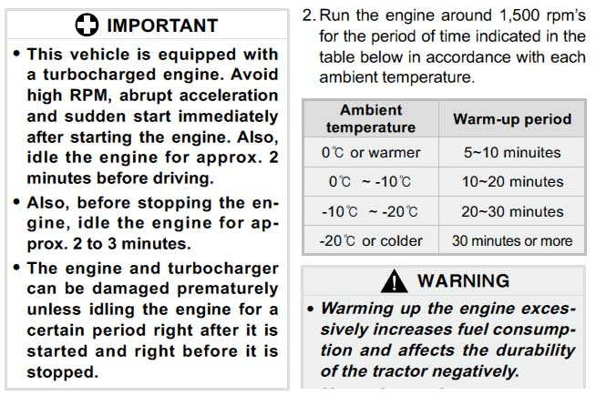

The manual for my non-Tier 4 RX8030 (excerpt below) is very specific regarding the importance of warm-up/cool-down periods.
But how do you guys with Tier 4 turbo-charged engines reconcile the requirement for extended warm-up times at low rpm, with increasing the frequency of regens? Or is that just "the cost of doing business"?
That says if you don't warm up the engine after you start it you can damage it, and then the warning says if you do that, you'll damage the engine. Damned if you do and damned if you don't.
