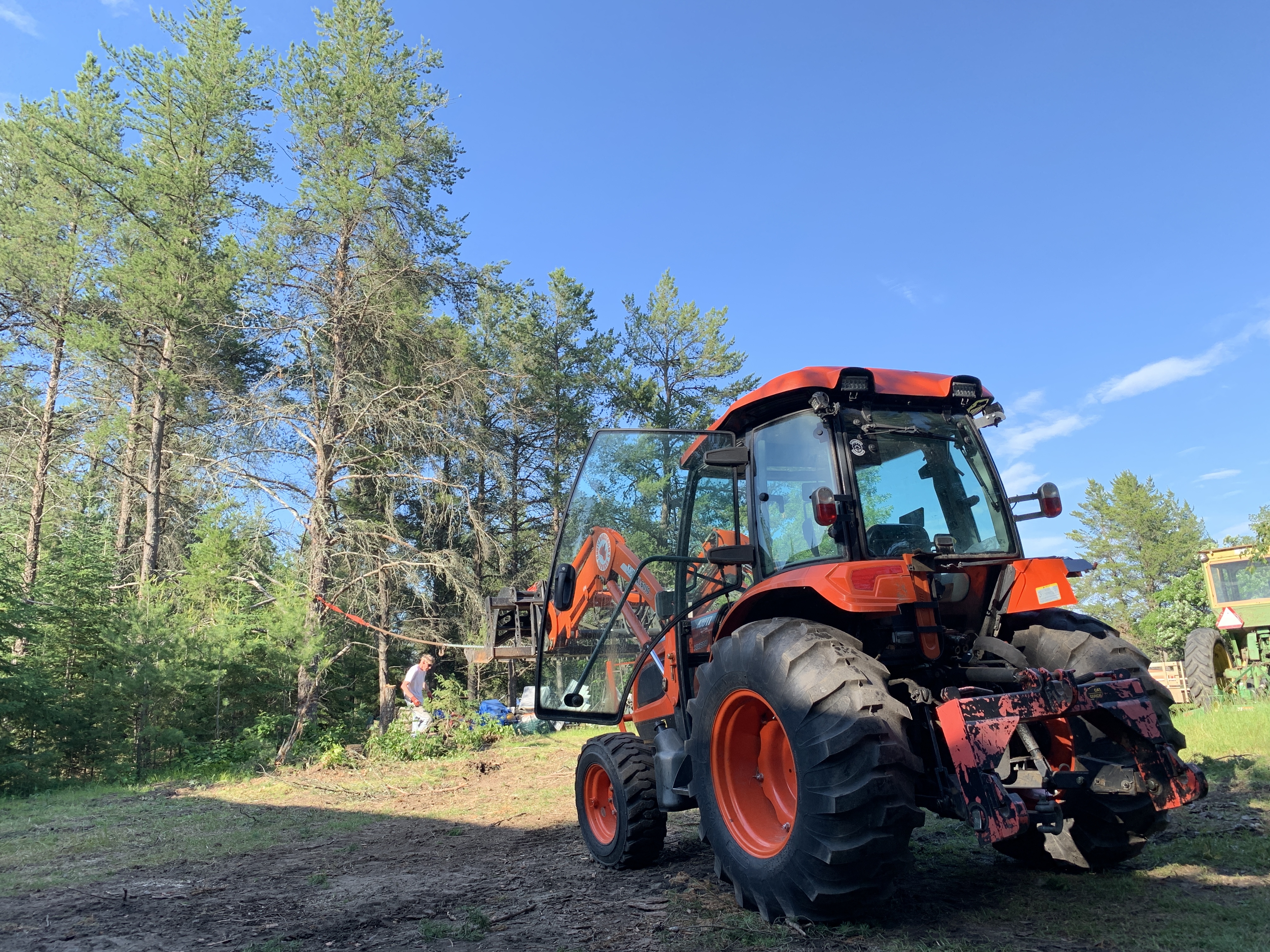

Any thoughts on LED light upgrades on my nx 6010. I will be using for Snow removal and want to upgrade from stock. Thanks.
   / Kioti nx 6010 LED work light upgrade #2
I replaced the factory incandescent lights with 36W 6.5" LED flood lights on my NX6010. Easy to install if you remove the six nuts holding the cab top on (no need to remove the cab top, just loosen it so you can lift it out of the way) and pop the air selector plastic nub off that is right above your head (you'll see why if you swap out the factory lights).
