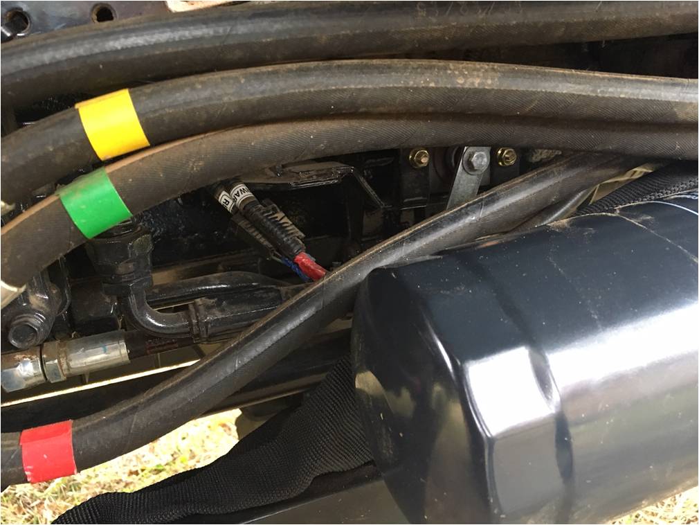

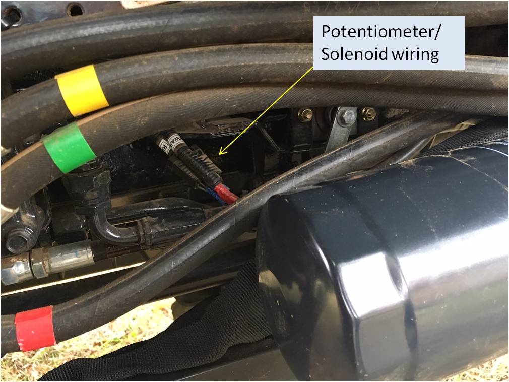

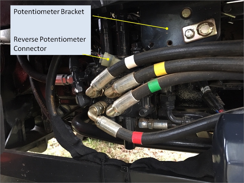

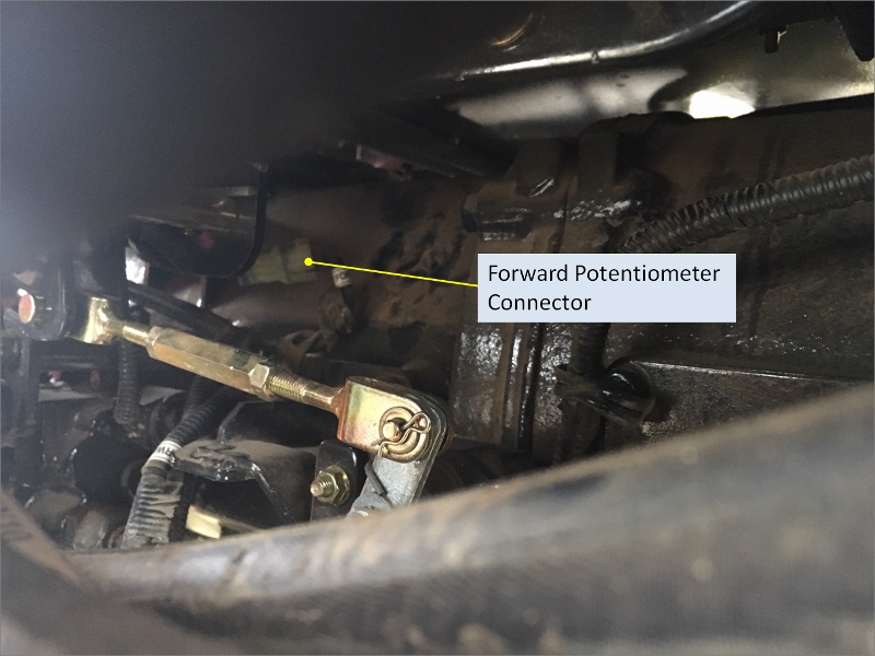

On the right side of the tractor you can see the wiring that goes from the pedal potentiometer to the HST solenoids. They are located near the big hydraulic filter and if you have a front end loader (FEL) you may need to look through the loader's hydraulic lines. Look here first for a loose connector or damaged wiring. If the wiring looks to be intact you could have a Forward Relief valve sticking open but on such a new tractor this would be unlikely.
As I thought about this some more, I am thinking you could also have a servo spool that is just a bit sticky and will free itself by just alternately pressing the forward and reverse pedals a few times. It may help to rev the engine up while doing this and move the range lever through its positions as well.
Every once in a while my HST does the same thing, it won't respond to one or the other pedal input when I've selected a different range, but the condition only lasts a few seconds.
