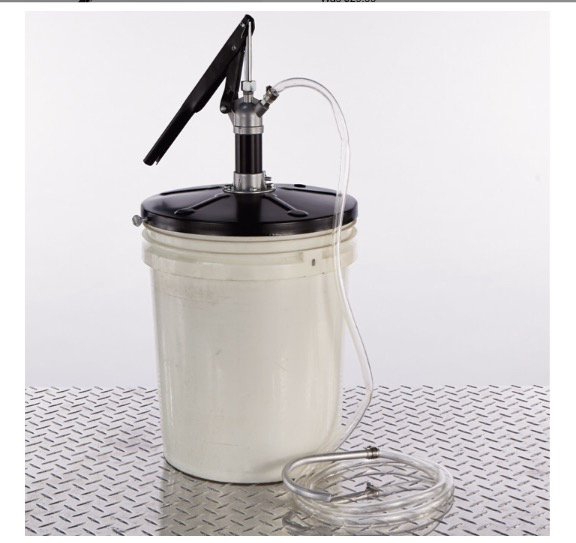

The G-Gun looks cool, especially if you do your greasing "in the field." Some folks love those battery-operated grease guns but they are costly and I assume the battery will always need to be charged before you can use them (if they are anything like my battery drills). I normally drive my tractor up to my workshop for maintenance and I have a compressed air hose at the workshop. So I bought a pneumatic grease gun like this one, and added a lock-n-lube coupler, of course. This gun has a provision for bulk fill but I just use ordinary grease tubes. So far it has served me well. I find it really helps to be able to pump grease using just one hand (vs a manual lever gun which requires both hands).
