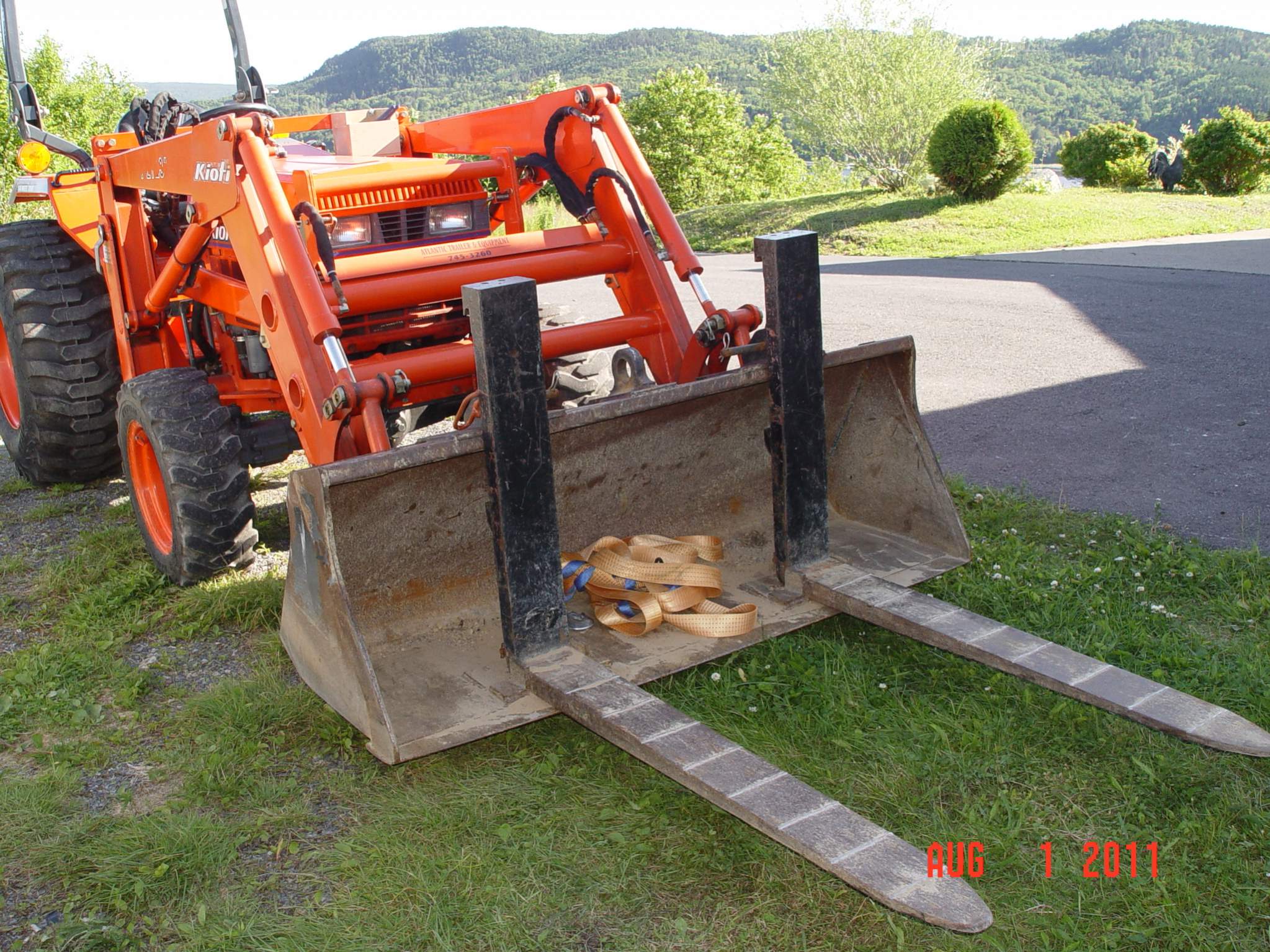

Thanks Joel,
The pallet forks i have are way to heavy,looks like they came of a big forklift and brackets made to fit FEL ..they were with the tractor when i bought it.
My BH is a China made LW6,trying to make up brackets to keep the pump from moving on the PTO...Any tips on doing this? It was in a crate,got it all together,except the pump frame.....anxious to try it out..
