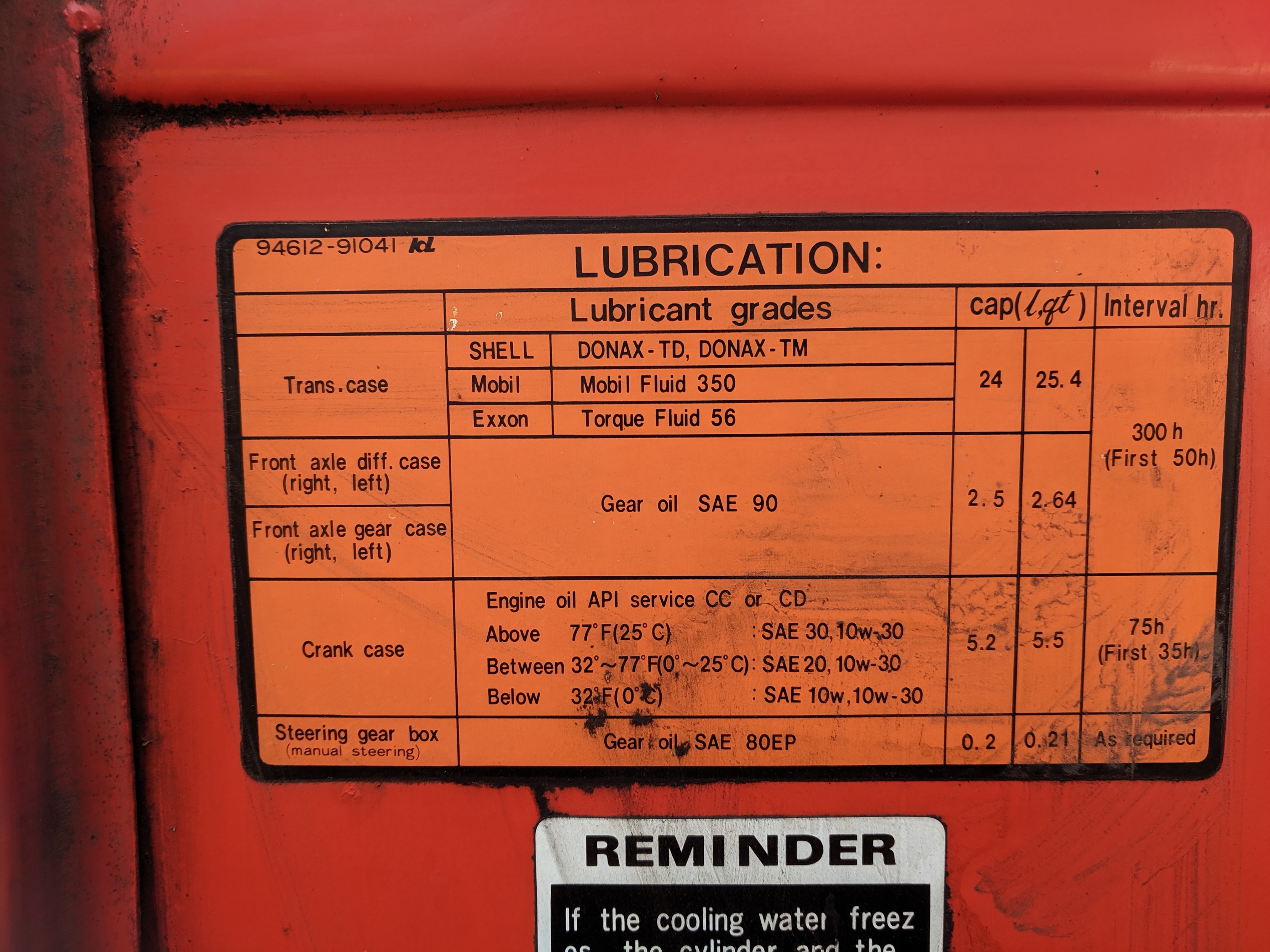

I just picked up a Kioti LB2204 with loader. It's in really good shape, but there are a couple of questions I have that I was hoping someone could help me out with. I've been searching this forum and Google the past couple of days and can't seem to get a solid answer.
1. The tractor is from 1986, so I figured the trans/hydraulic oil brands listed under the hood (attached) would be discontinued. Should I be alright with Mobilfluid 424?

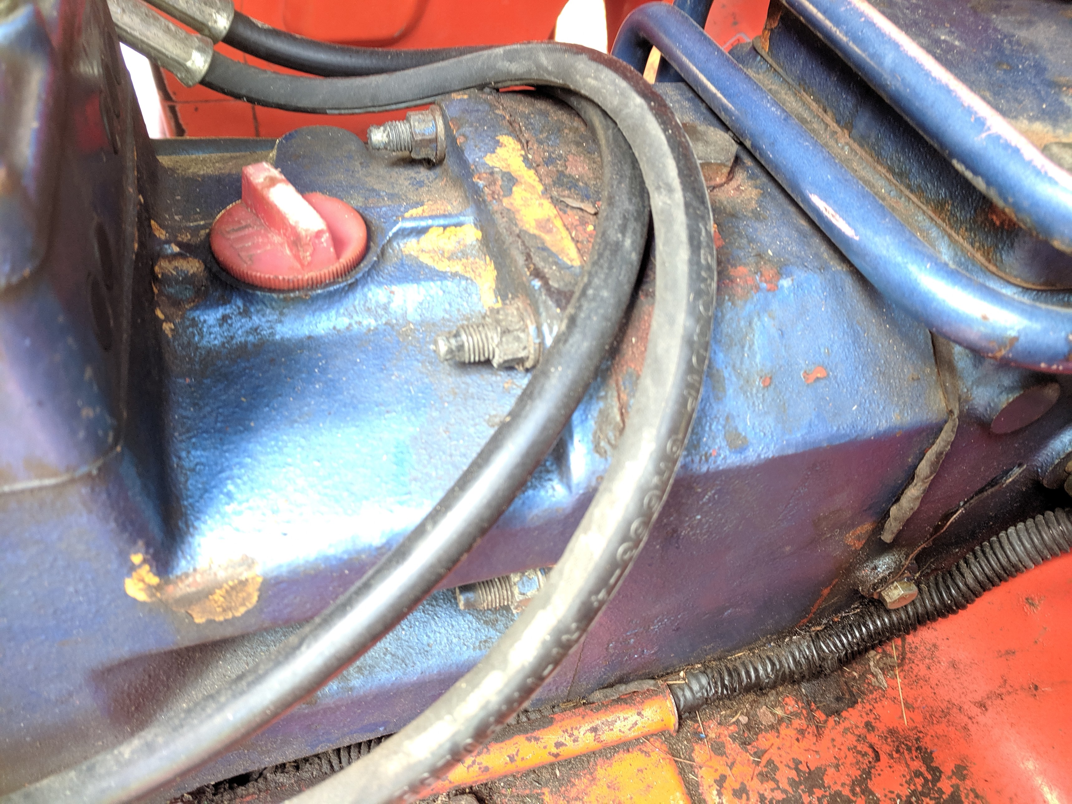

2. I'm not sure where the fill level should be for the trans/hydraulic fluid. The fill cap is pretty obvious, but there is no sight window. There is a bolt on the left side of the transmission case that has an aluminum ribbon on it. If I had to put money on it, I'd guess that's the fill level. If anyone can confirm that, I'd be appreciative.

Answer to the first question is yes that should be fine.
Second question, I thought for sure there was a sight glass on the left just before the clutch pedal. So not sure on this one.

Congrats on the "new" tractor! I think you'd be fine with any premium tractor hydraulic fluid. If the knob doesn't turn, hopefully it's locked in the "open" position. Otherwise, like K5 said, your 3 point won't drop.

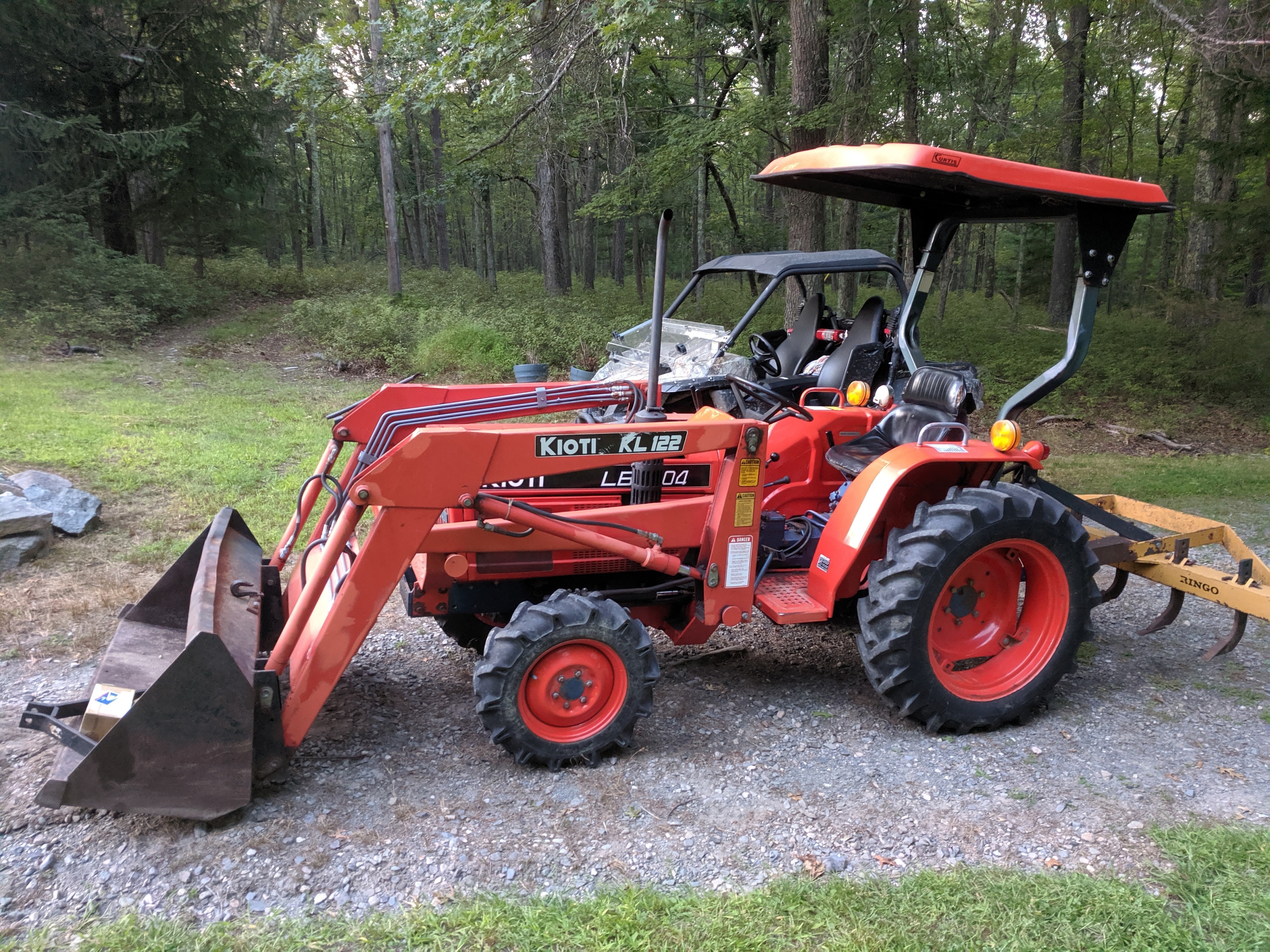

Tractor looks to be in great shape! Think you'll get a lot of good use out of it.
