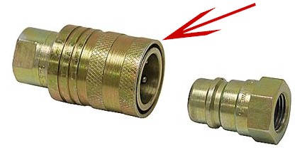

Looking for a little help. I am looking to put a snow plow onto my tractor and am wondering on what the KL130 hydraulic quick connect fittings are called that are setup near the loader. My plan is to disconnect the tilt/dump cylinders and hook up the new lines to the angle cylinders on the plow. I see they have a 3/8PT on them but when I went to buy one it didn't fit the same. Is it different due to a Korean brand? Any help would be great. thanks
I was thinking of ordering a setup on line with the quick connect and hydraulic line.

I see the Surplus store carrys a ton of stuff, and am wondering if it would be one of these? I think it is called the S45-3 type? But unsure if that is what I already bought at my local TSC, which wasn't the right size. Thanks for looking.

You won't find them at Surplus Center. The plugs are 3/8" ISO 7241-A plugs. You can order them from your dealer or some on-line sites. They cross reference to the following:
Parker 6600
Snap Tite 61
Aeroquip 5600
The Safeway 25 and 45 series do not fit these quick connects.
Hope this helps.
