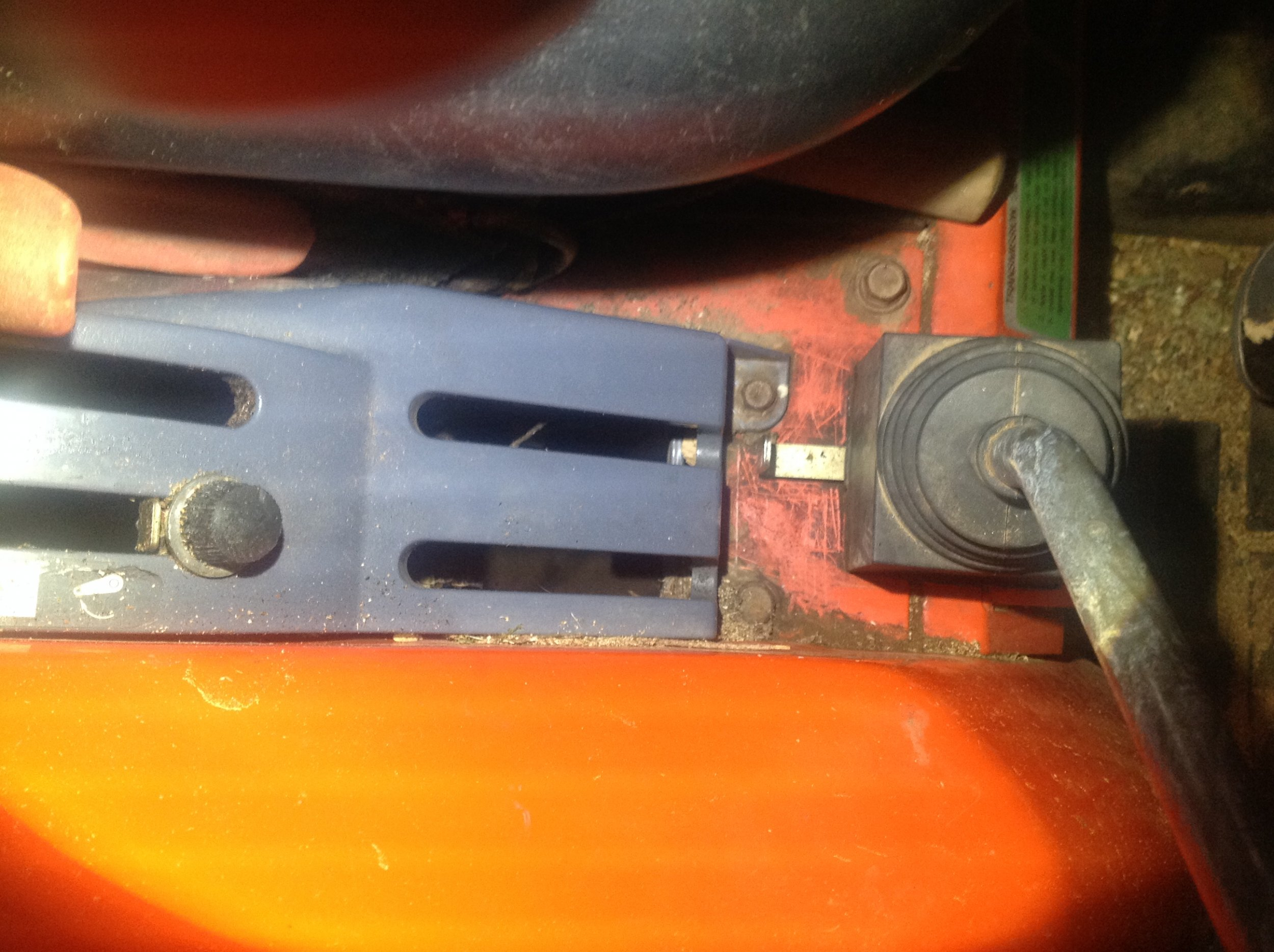

Hello to all the happy Kioti owners. My question is about the slide leaver at the bottom of the joystick on my CK25hst. while turning my body to the right to backup, well my leg pushed on the stick and dropped a bucket full of split firewood! I tried to lock the stick, but it will only lock in the curled position ( down ). Anyone know if that's correct? Thanks in advance!✌🏻

It should lock all movements. Have you tried wiggle the joystick slightly, while trying to engage the lock at the same time?

Yes I tried that, no luck wasn't even close! My mistake it will only lock in the down position.

Can you lift the rubber boot or take the cover off and inspect all the linkages? The lock is a simply a mechanism. It just that metal tab that slides over some grooves on both spools.

Like ptsg said, it should just slide into a couple of gooves. On my LS, I do have to push down lightly on the joystick to get it to lock.

I’m trying to remember, I’ll have to check tomorrow, but I believe mine has 2 lock positions. First locks curl function, 2nd locks up and down. Only time I use it is when I remove loader.
I tried to take the rubber boot off had no luck....Any idea how to do it?

Thanks everyone for your help👍🏻 it was a loose cable that kept the groove from lining up with the metal tab! All better now. ☮✌🏻
