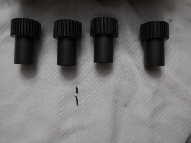

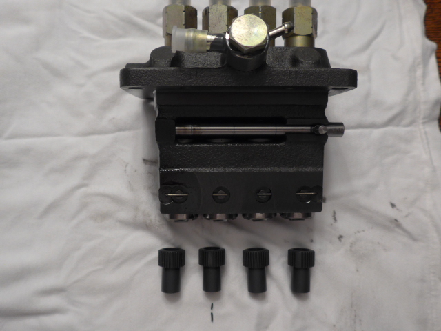

Most of these IP gear tooth failures occur when the tractor is shut off normally and the IP rack jams in the full-off position. In that case the tractor won't restart. But sometimes the broken tooth fragment is lose enough to allow the engine to restart and the IP rack gets jammed in some other position. The IP rack will try to move to the max fuel/max power position as soon as the stop solenoid retracts (key turned to on) so an IP jam at high power is likely in this case.
I recall two cases where the IP jammed at high power. One was a gear transmission where the owner was able to stall the engine with the brake and clutch, in high gear. The other was you (GaryRo). With a hydrostat, you probably did the best possible thing by cutting the fuel line. The manual shutoff lever operates on the IP rack just like the stop solenoid; so if the stop solenoid didn't work the manual lever probably won't work either. Cutting off engine air is risky. If the rag (or whatever) gets sucked into the engine it WILL damage something. Besides I wouldn't relish removing the air cleaner on a screaming, out-of-control engine. If I had a hydrostat tractor (mine is gear) from the vulnerable period (2005-2008/9?), I think I'd install a fuel shutoff petcock in the fuel line, just in case.

Update.......Took out my FIP over the weekend. Almost like sherrym described but not only did i have to take off the intake manifold but i had to take off the fuel filter and bracket to get the manifold out of the way to get the FIP out. When i tried to pull the pump up and out it would not come out. It was hanging up on something. Noticed a tube looking part on the left side of the FIP and took it off. This part is called the Idle Adjusting assembly. It says it is preset at the factory and do not take it apart. It has a little rod on it like the engine stop solenold which was sticking out and hanging up on the FIP and that was why the pump would not come out. Also, like sherrym my pump is not a Bosh/Kenzel, it is a Doowoon/Kenzel. I do not remember if i said this is a second pump that was replaced at around 186 hours. Took it to the rebuilder and he took it apart right in front of me and one of the four gears that run on the rack had broken, just like everyone else that has reported this problem. The rebuilder and i agreed we should just go aheard and replace all four gears since there seems to be a problem. He has over 26 years of experience rebuilding FIP and could not figure out what was causing the teeth to break. My total cost was just under $200. I was shocked because some Kioti owner on this fourm has been paying around $500 to $800. Now i do not know what parts they replaced so maybe they replaced more than i did. I live in Northwest Missouri and my rebuilder said he would be happy to help anybody with this problem. I have posted some pictures as i have seen some of you like to see what happen.
