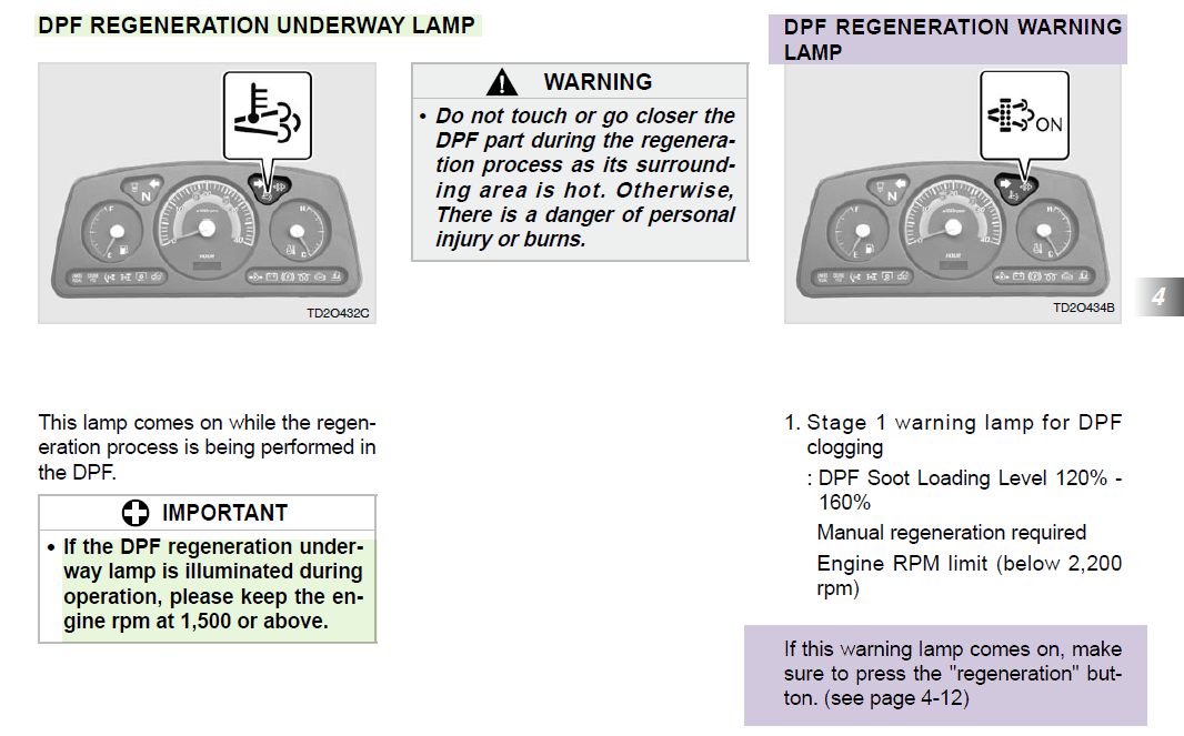

I have a 2018, bought in 19 DK5510 shuttle shift tractor. It has 162 hours on it now and it just did its second regen. Now I know some will say I just missed it, trust me I did not. I’m the only operator and when it regens the dash light comes on and motor goes into a limp mode. Did it first at 70 hours then just a couple of weeks ago at 160 hours. Don’t use it much just for food plots and collecting firewood using the grapple, also keeping my gravel road in shape and flail mowing a couple of fields. Is this normal regeneration times?

Why do you idle down to hit the regen switch? The light comes on only to tell you that it is going into regen. I have never hit any button, I just let 'er rip. You should keep working at PTO speed or increase to 2600 or let ECU take care of it. Maybe you have been cancelling the regen?
EDIT: The manual is not very clear but there is a distinction between the "DPF Regeneration Underway" and "DPF Warning" lights. The first says to keep RPMs above 1,500. The second (warning) is where it says to park in and do manual regen.

On mine (JD), there are 2 different lamps indicating a regen. One shows it is doing a (passive) regen; e.g. continue using the tractor as normal. Easy to not notice that. Parked regen is when it will illuminate an additional lamp(icon), show a message on the dash, and require the brake to be set and the trans in neutral. Nobody would miss seeing that, but if your engine speed was already above 1500, a passive could go un-noticed.
That being said, I have read of others who's tractors seem to do regens every 75 to 100 hours, so you may be absolutely correct that it has only done 2.

Have you read the Operator's manual? The HP difference is strictly software, the engines are the same. Again, there is a difference between "DPF Regeneration Underway" (automatic/passive) and "DPF Warning" light where it was unable to perform the active or passive (auto) method.

Yes, for a manual regeneration you do bring it to idle, set brake, neutral, etc
This should only occur if for some reason the tractor was unable to complete an "active" (aka automatic, or passive) regen during normal operation. Normally, the "Regeneration Underway" light will come on when the ECU initiates an active regeneration based upon differential pressure across the DPF among other things. If for some reason the condition worsens it will give the "DPF Warning" light. At that point you are required to do a "parked" Manual regeneration. If you neglect to do that, or if for some reason it doesn't resolve the condition, it will go into limp mode. I think at some point it may require a visit from the dealer to do a forced regen and reset the ECU but I am not completely sure on that part.
