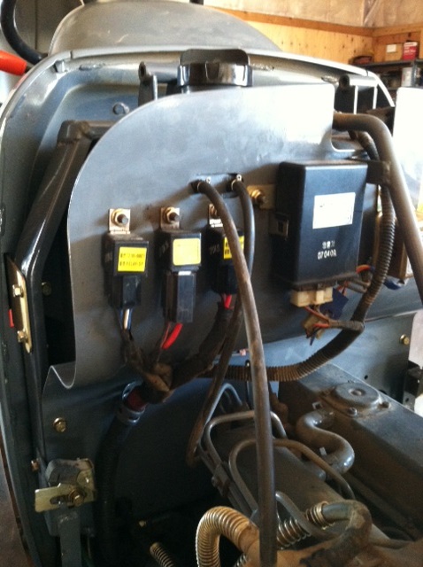

tank.JPGNew tank went in failrly well, I used the links posted around the forum for hints and tips. Took the loader off, left the exhaust on and the tank and its frame rolled out up and to the right as you face forward. The new tank fit the housing much better, even clearance all the way around the vent line connections. Appears the original tank was molded wrong. Having the tank out provided a great opportunity to clean out all the built up dirt etc from the bottom of the firewall and top of the transmission.
