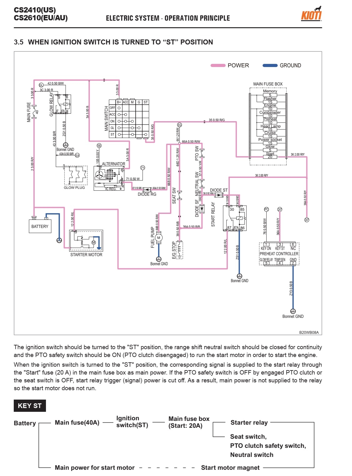

   / Kioti CS2610 difficault to start
#9
See below the electrial schedule for starting.
Honestly I don't know what to do.
   / Kioti CS2610 difficault to start #10
Change the ground cable. Clean the connections with sandpaper, apply di-electric grease, at frame and post. Heck if you’re doing one cable, why not both?! Shouldn’t cost you $50. Report back…
