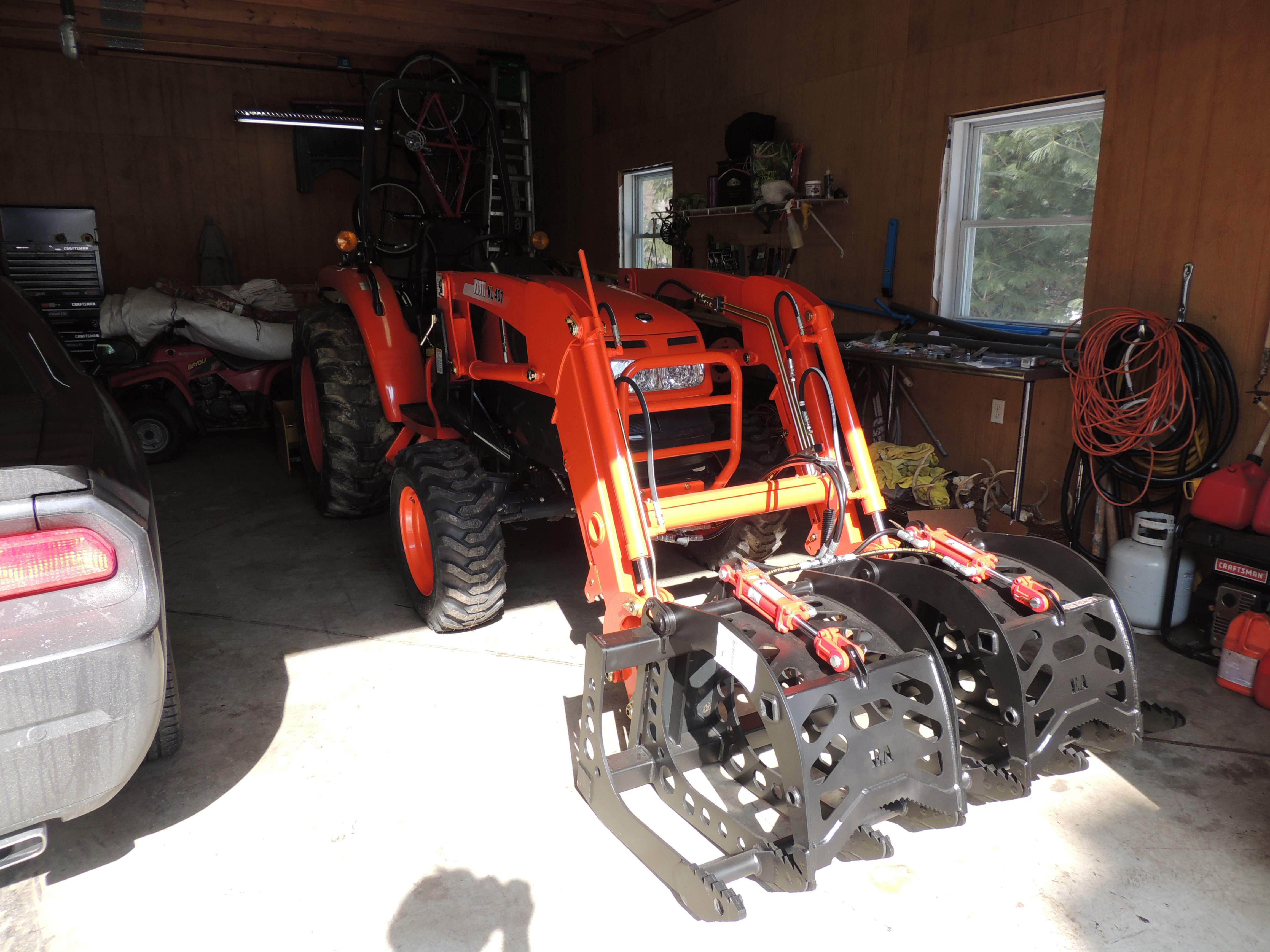

My DK40 fits thru my garage door
You just need the right size door :laughing:

My door is a typical 7Hx9W door. If there was a mouse on the tractor canopy, he'd get crushed, but the tractor fits.

The Kioti won't fit through the garage door without lowering the ROPS, but the 9 footer on the polebarn is no problem!
