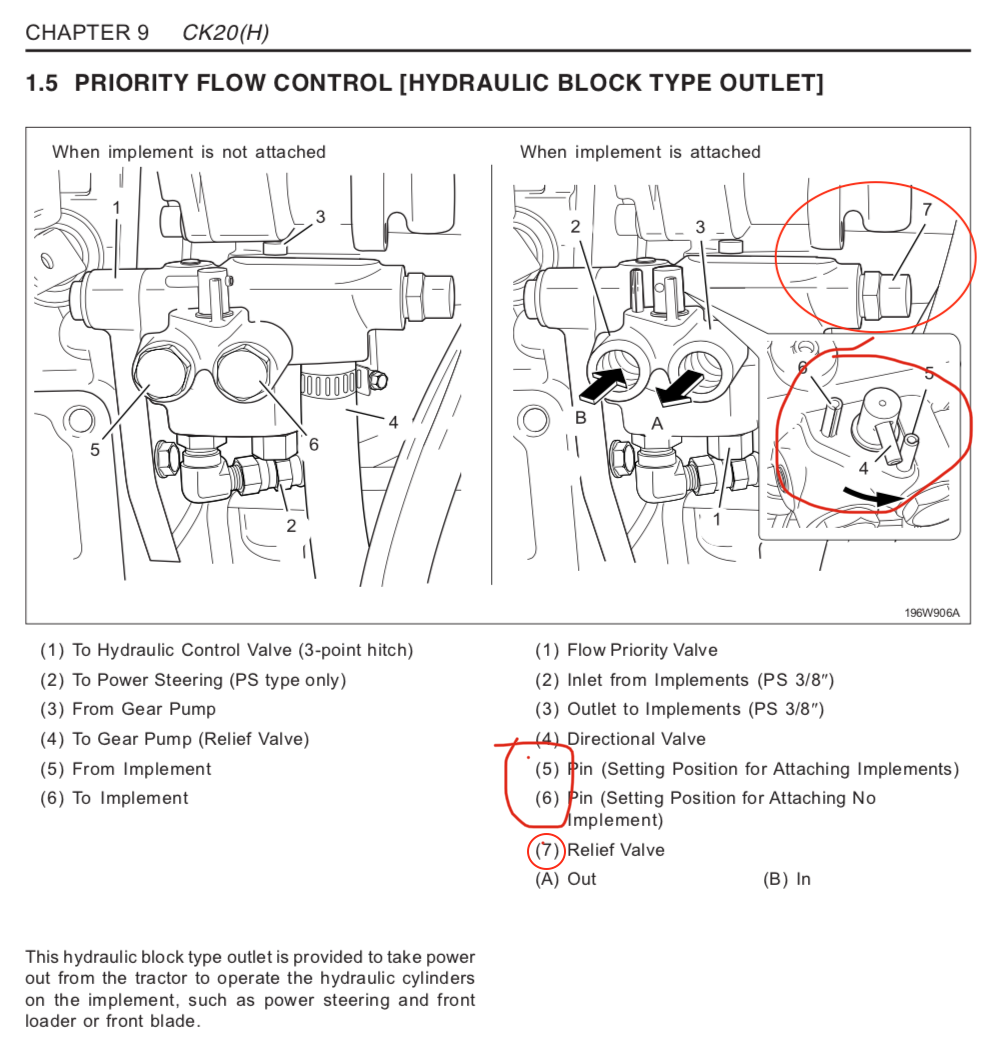

My cousin dropped of his CK20S and says please figure out what my dad did to this tractor. apparently the hydraulics were running slow on the both the back hoe attachment and the FEL but they were working.
His dad went and got all new filters and oil and changed out hoping to fix the problem of being slow. Well the tractor drives but has no hydraulics or power steering. I did some reading and wanted to know if the fuel cam gear or shaft was broke. I pulled the front loader off and misc. stuff to get to the pump. I pulled the inlet tube off and I can see down into the gear pump and it is turning and I can see some gears and hydraulic oil and the gear pump is spinning. Does this mean my pump is good and I have some other issue? Is it the gear pump bad and doesn't have the ability to move fluid? Any ideas what to do next since I verified the gear pump is turning?
any help on what to check next would be helpful.
   / Kioti CK20S Hydraulic issues #2
On the bottom of the pump there is a priority flow valve for adding a loader. Check to make sure the valve is turned towards five circled in red below.

thank you much after going out and not seeing that feature on my pump I took it off the tractor and I found metal shavings when I tore the cover off the pump.
The pump is shot the sleeve in the bottom of the pump shaft and pump shaft are all torn up.
I ordered a new pump this morning. I will let you know how it goes.

OK so I have replaced the pump and got it primed but I only have partial hydraulics and when the front end loader or back hoe move it has no power and you may have to help it move by hand.
I pulled the valve spool out and tore it all down looking for a blockage in the system. I also tore the flow control valve apart looking for metal shavings. I am wondering if I had screwed up the pump running the tractor before I figured out how to prime the pump? Is it possible that the pump isn't pumping enough fluid?
Any suggestions on where to start? I mean at least I have some hydraulics but the FEL wont lift it will only tilt the bucket and that will barly move. The rear back how will not lift but will move side to side but I can hold it from moving. The level feet will move to the ground but when you want to lift them will barley lift an inch off the ground and you have to help lift it back in the up position. Do I have a plugged or restricted hydraulic port somewhere or is my new pump bad? my power steering does work now that I got the pump in installed.
Is there a pressure relief valve somewhere that could be stuck in the open center position? any help please

I bought the pump from Michigan Iron and Equipment I also live in Michigan. The Fuel cam isn't broke as I checked the pump was spinning prior to removing the old one and I checked that it wasn't broke when I had the pump off. It is defiantly week and I am getting frustrated as this repair is for my cousin. all filters and oil was changed. Since I have lack of powre at both the back hoe and front end loader I was hoping to have a popped relief valve that wont seat or narrow down a blockage that might be in place since the pump feeds the spool and the spool fees the FEL and the Rear back hoe. my pump was bad so I could have metal shavings some where.
well after lots of extra work I caused myself I have it fixed. when I found the pump all tore up I went and took the priority valve apart and when I put it back together I didn't tighten the pressure relief valve in. Not sure how it wasn't leaking as it was only just started in the threads. I tightened it back in and everything worked. I wish I would not have screwed that up the first time around it would have saved me a lot of work. But it is working now!
