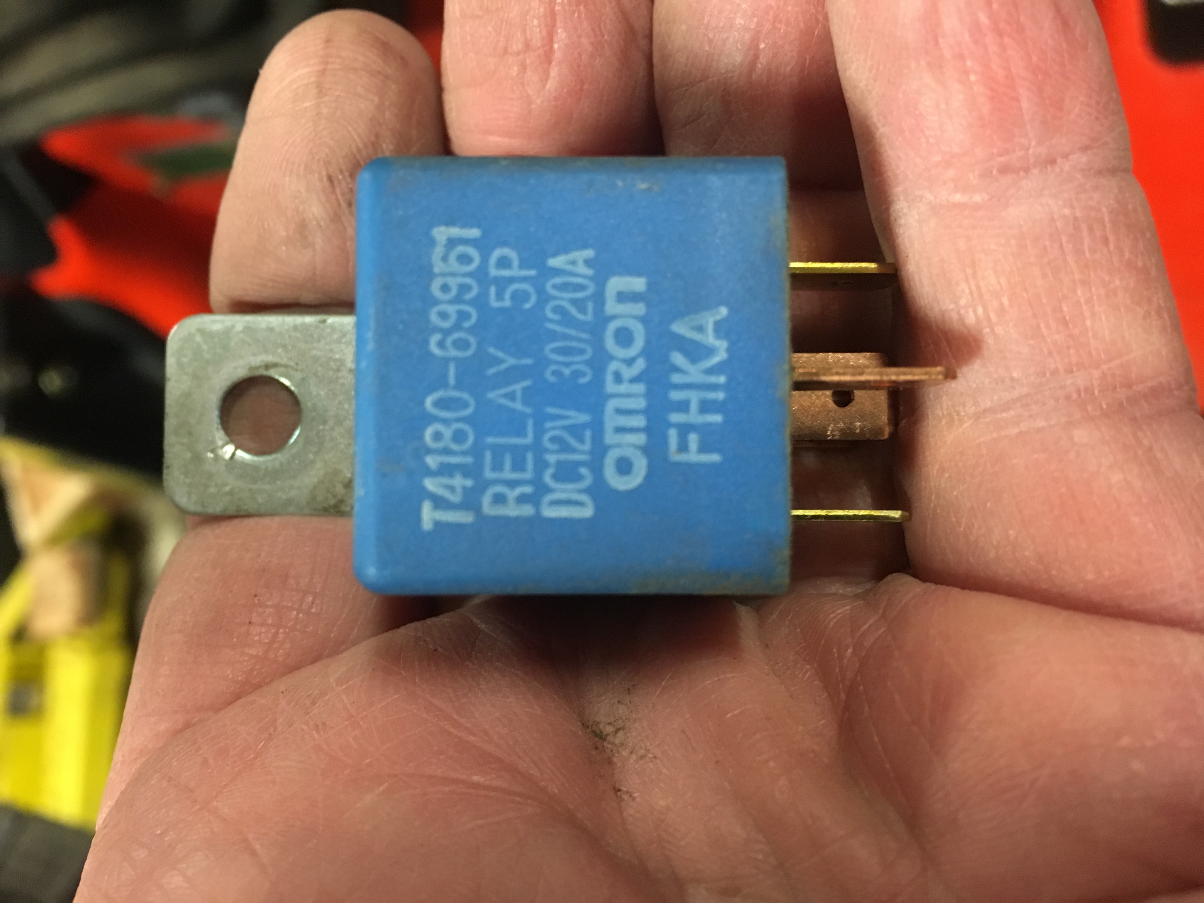

I pulled out the stop solenoid and did a quick bench test on it to check continuity. It seemed A-OK. Applying power on the bench snapped it back with a clack. The real problem (for me) wasn't the stop solenoid. It was the cheap Omron relay
It passed a continuity check, but wouldn't pass enough current to properly energize the solenoid pull coil.
