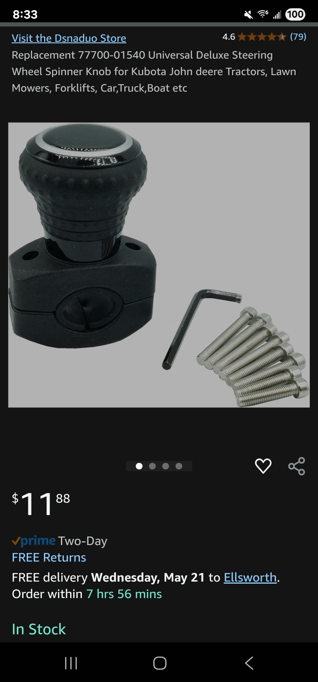

Fill the tires and get a ballast box if you plan on using the loader at all. Others will say just use an implement you already have, but a dedicated weight box will be much smaller and more maneuverable. Bright flood lights on magnets attached to the rops so you can point them forward and backwards depending what you are doing. Plus you can hang then underneath when you aren't using them so they don't hit anything like branches. The cheapest accessory that I use every time and wouldn't want to go without is a steering wheel spinner. 12 dollars on Amazon

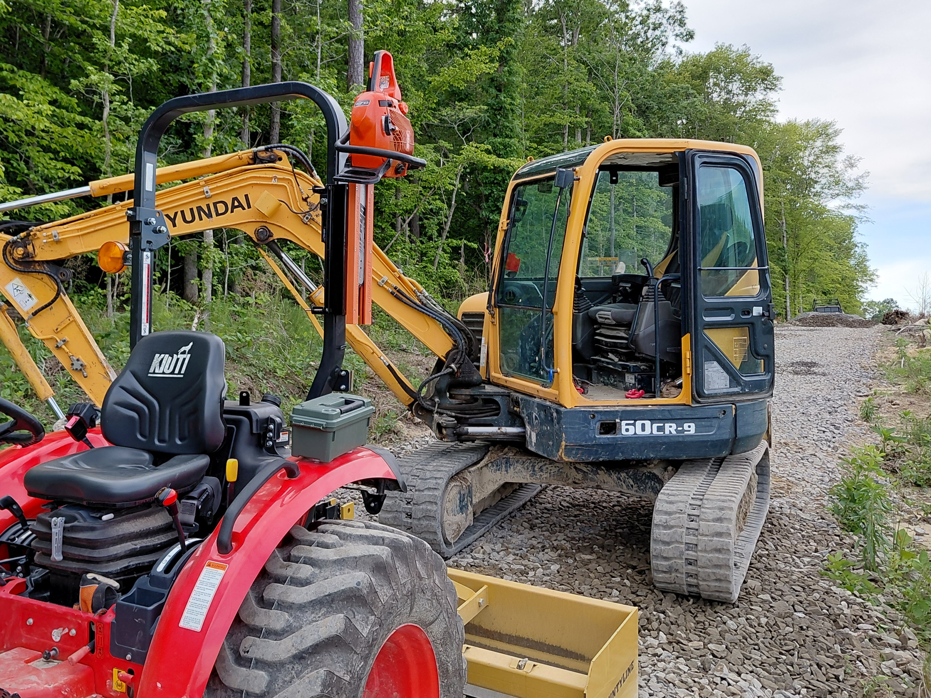

Filled tires and always have an implement on the back.
The chainsaw holder is one of the less expensive ones from Amazon but it works great.
I got the idea for the little toolbox and magnets from this site and it's worked great.
I have led lights for the ROPS but haven't installed them yet.
