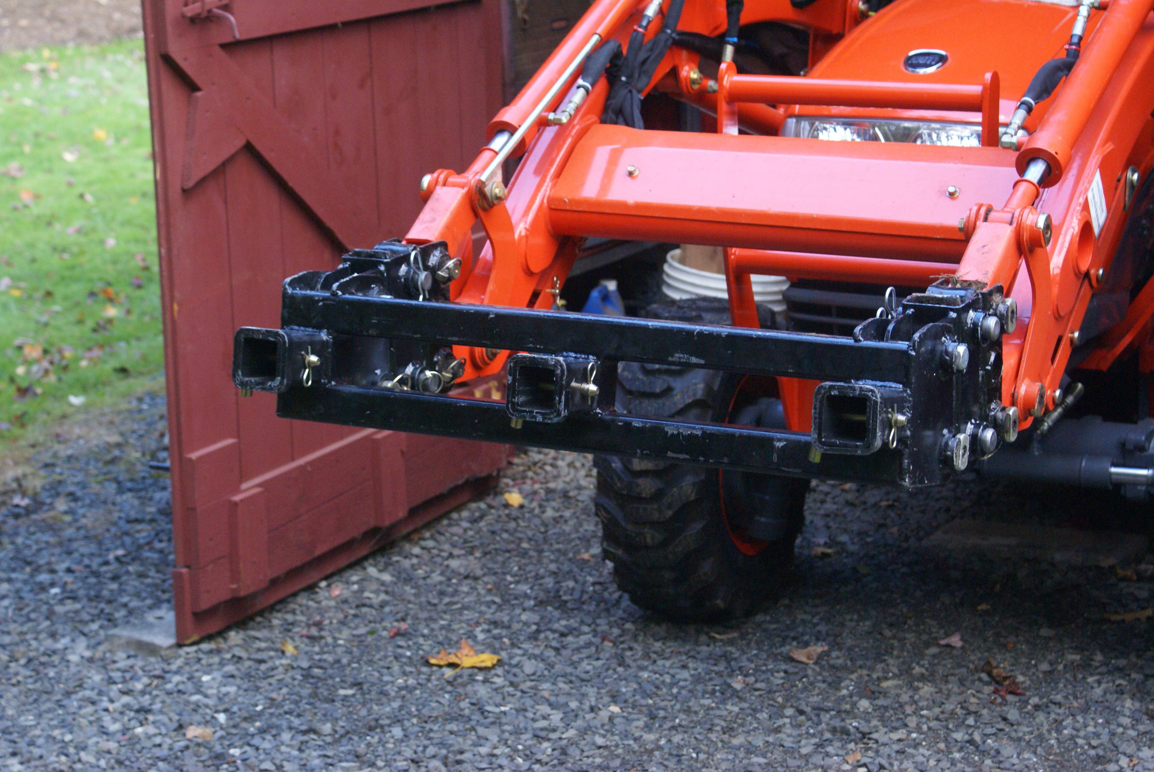

I bought a QA bar that replaces the bucket and it has three receiver hitches on it. This allows me to get closer to the ground, use hooks or balls in the receivers. I have a 20hst and I think the bucket is a little flimsy so I would have had to have a plate welded onto the top of the bucket and receivers welded to the bar. If I can dig up a picture I will post it.
/ Kioti Bucket Reinforcement #11
Found a picture of receiver bar. It has a lot of pins because it was modified to fit my Pin on QA

Gil Case, setup looks pretty solid, why 3 receivers?
/ Kioti Bucket Reinforcement #13
Well, three receivers seemed logical, one on each side and one in the middle. However I had a wild idea about using a 3pt hitch implement in the front of the tractor (set out several feet) to drag some weeds out of a pond. Someone fortunately talked me out of it----so far. However, the receiver hitch set up does allow me to use various inserts, D-Ring, ball, chain hook etc.
