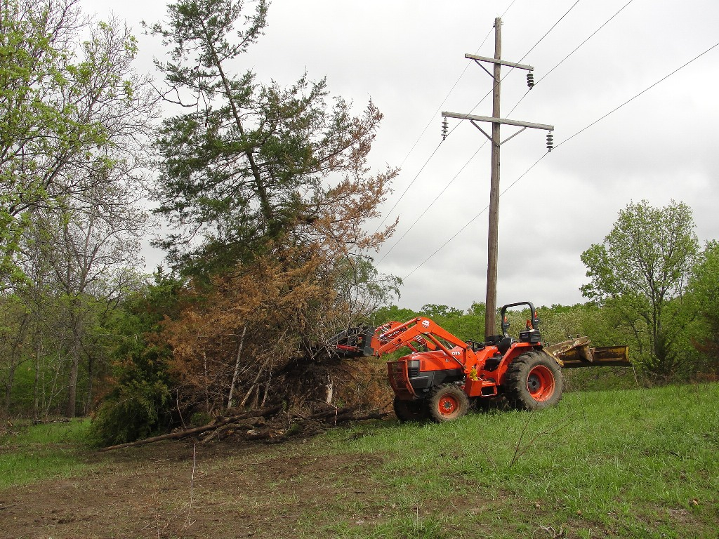

I am generally conservative operating machinery, but last year I snapped off the 3 point hitch lower arm connection point on the tractor case. I was pulling fence posts (set in concrete) with the 3 point and a drawbar between the lower arms. I bent the drawbar on one post that wasn't budging, so I used 9k rope with just the lower arms. Big mistake. The rope was pulling inward, drawing the pinned arms together, and it snapped the cast case connection point.
That cost me almost 2k. On the plus side, even considering that expense and a new ssqa hydraulic auger, I still saved over $2000 over having the fence professionally installed.

I was trying to pull a 6" diameter oak tree out of the ground with a fel mounted post puller. Push, pull and lift. It was probably the 100th tree I pulled. It just caught up with me and the tractor. Its pictured with a 3 point adaptor attached
Sounds like a completely normal day around here…lol
Sometimes you only have the pieces of equipment you have and need to finish the job. I relate to someone who gives it his all with what he’s got.
We were taking out brush and smaller trees like that for a customer about 10 years ago. He would keep adding more clearing as we opened up his property. Towards the end, he asked us to take a few more trees down like that and rip out the roots and small stumps. We were using a little M9540 and HD forks. I would dig the forks slightly under the stump on either side, drive forward to the back of the forks and pop them out. Got to the last few bigger ones and bent loader arm at front cross tube. Unknowingly, the customer called local dealer and paid him to have it fixed for me. I refused to accept payment and told him it was my fault and part of the risk of the job.
He became a lifelong customer and always “overpaid“ us.

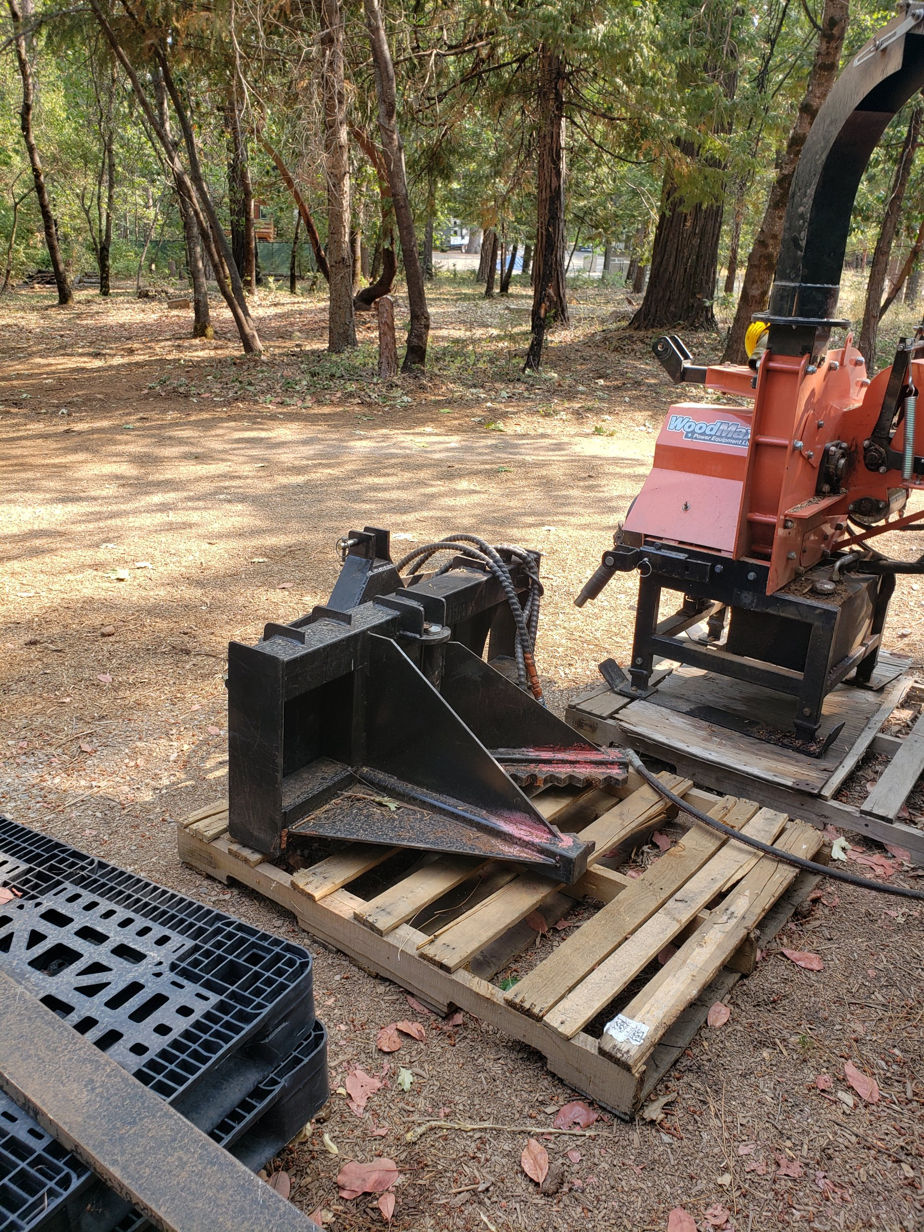

I would add an FEL mounted tree/post puller as the second attachment that's hard of a tractor and FEL. There are situations where you can apply an extreme amount of leverage on the FEL and tractor.
I built my puller several years ago and have used it a LOT.

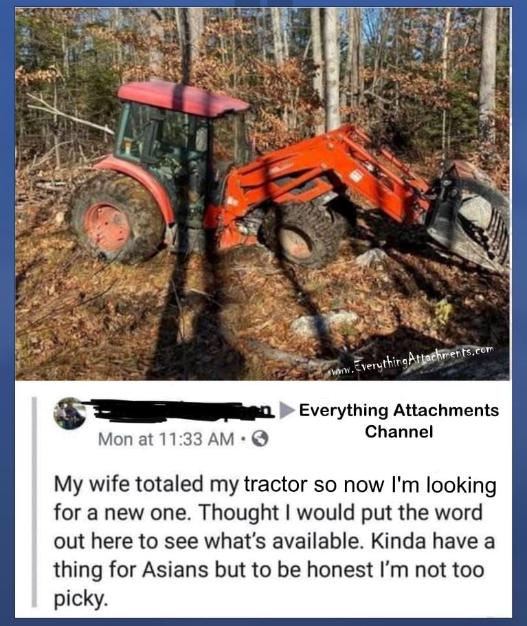

Here's not something you see every day. Browsing facebook and saw this.
Not sure what the backstory is.
The guy that did is was using the tractor instead of a bulldozer or skidder. His dealer and local mechanic both told him he was crazy and would probably break something but he decided to destroy the tractor anyway! He's posted it on Facebook with several different stories including the some of them about how he high-centered it on a rock, his wife drove into a tree, and the one he got made fun of the most on his how he babied the tractor since new. His local mechanic showed up on that post and called him out!! lol:eek:😂

The paint on the FEL is in much better shape the tractor. I'm guessing it's new. Grapple looks oversized too. Maybe FEL was altered to lift more then tractor could handle
