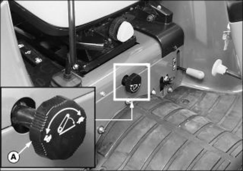

I have a Kioti CK20S that the three point hitch won't operate. I have changed the fluid and filter. I've turned the MLS valve all the way up. The fluid is full. I've also put weight on the arms and as one person told me, to slam them down. Nothing has worked so far. It doesn't have remote controls. Any advice would be appreciated
   / Kioti 3 PT hitch won't raise #6
if the MLS valve IS NOT the valve under your legs, adjust that one.
Mine moved one time and make the 3pt seem locked up. Just adjusting the know fixed it.

The one between my legs is the one I adjusted. I went both directions with it, and still no movement on the three point.

You still haven't said if you have a loader or rear remotes. If not try putting a very low air pressure in the fill hole with tractor running.

It does have a front end loader, and no rear remotes.
