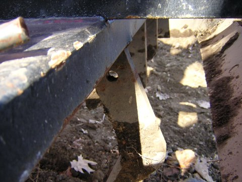

Last year I posted about my BoxBlade death due to user error. This spring it was injured again doing light duty work.
One of the tines was driven back, bending the back edge of the tine support, and pushing the tine 3/8" through the front of the support.
I will never waste money on KingKutter ever again.
The first picture shows the tine bent back. It took a 3lb maul to get it unstuck.
Notice the bowed section of steel directly behind the tine.

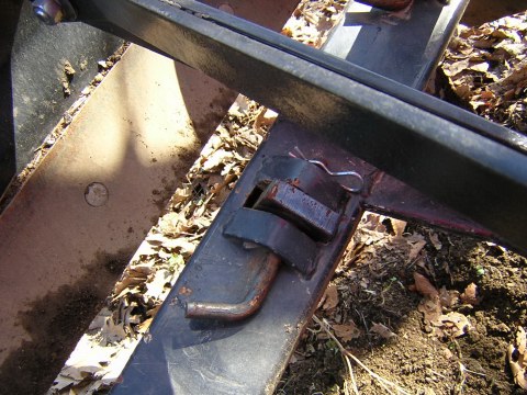

Here's the top of the tine. The front edge of the tine cut into the support about 3/8".

I'm sure you know this but without welding on some strengthening plate the bend will occur again only sooner this time as the whole thing is weaker. if you need to cut a piece of plate we can do it in my shop with the plasma cutter.

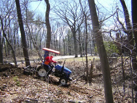

Here's the project I was doing, just grading an access path to get to the bottom of my gully.

Did the metal tear or did a weld break? Any idea if it was a single occurance that caused it or repetitive occurances (fatigue)?
I'm pretty sure if I snagged something firmly enough to rip the ripper out, my tires would loose traction first. Did you have all the rippers down or just one?

All the tines were down. All the damage is torn/bent metal. The tine itself is undamaged.

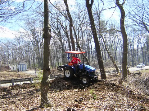

I don't know if it was a single occurance or fatigue. I was using them full down to tear up the soil and move it around. Then I wnet to pull them up to do the final leveling. At the beginning of the project, there was a 6' tall mound of dirt at the top of the gully, and the top was much steeper than the bottom, so I pulled the mound onto the steep section and leveled it all out. The first pass was so steep that the pucker factor was way outside of comfortable, and it took diff lock to get back up.

Ill agree with andy m you need to add steel to top front and rear bottom at the shank, also pulling down that hill gave the tractor an advantage on force applied to the box it wouldn't of had on the level.

Fixing it will be easy, I'll just add a small section of 1/4" plate to the main support member in front of each tine on the top and on the bottom in the back. That will double the amount of metal supporting the tines.
/ KingKutter BoxBlade, Never Again... #16
My Landpride 8' boxblade is also somewhat torn in from of the tines. If you look at the design of most box blades, it doesn't take much to twist a tine socket out if you actually grab something hard. Just too mcuh leverage exerting all it's force on a couple of small spots. Most BoxBlades appear to have no reinforcement at this point.

I have a kk box blade and the part the tines go thru is a box looks like made from 1/2" steel. Is the part the tines fit into on yours open on the bottom? and how thick is the metal? I have had mine about 10 years, maybe they are making them out of thinner metal now. I have handle mine pretty rough used it to ram stumps and big rocks and it looks like it might out last me.
