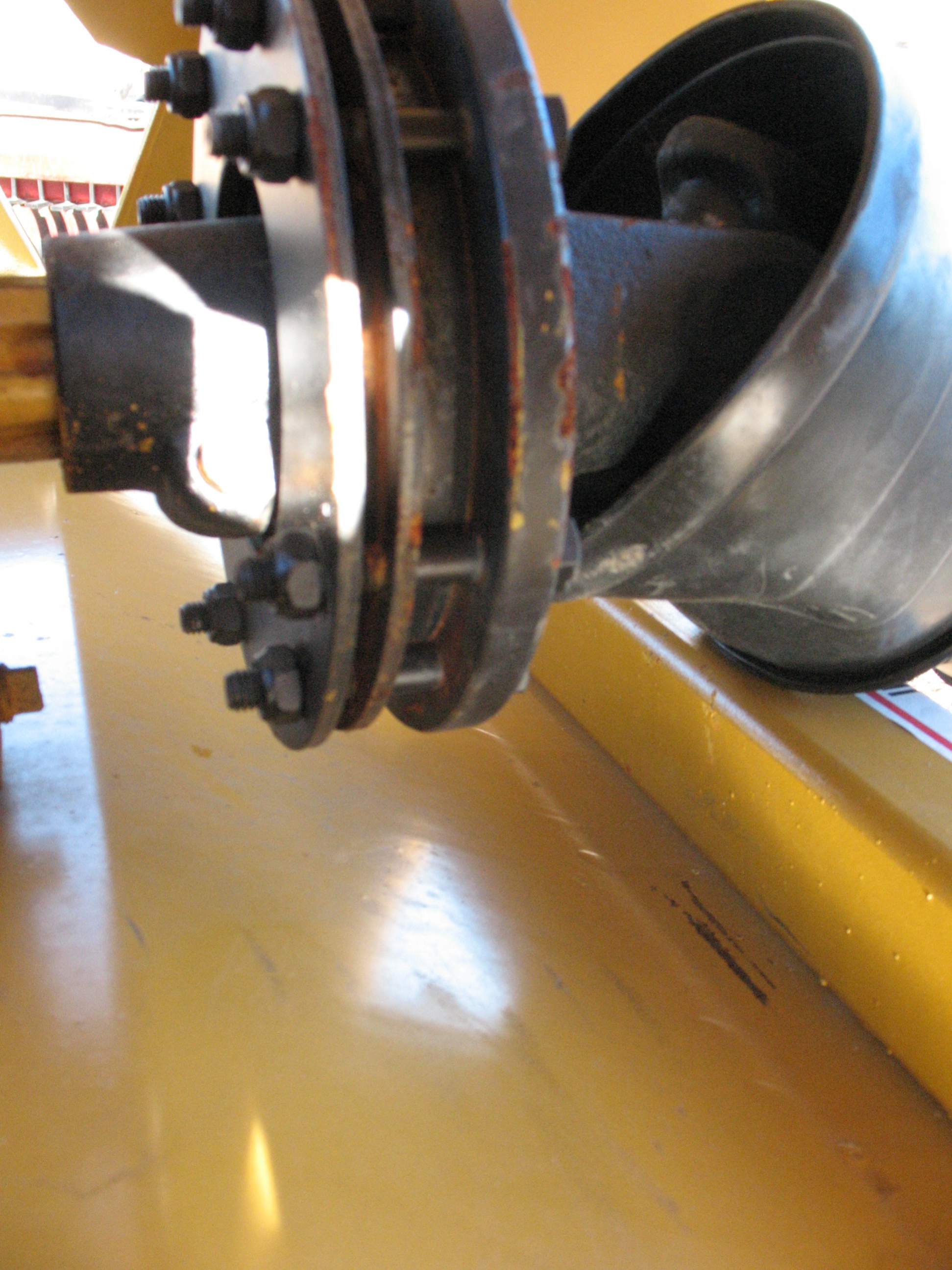

I have no idea if it is professional model or what. Here is a photo as you can see it has no exposed springs to adjust like the other type.
/ King Kutter tiller #8
Gary that is the same one I have. You can adjust it by loosening or tightening the bolts/nuts you see in the picture. It is a good idea to check them every one in a while. The manual gives instructions. Glad yours worked right out of the gate, as I said mine was rusted from sitting outside in a parking lot. It is probably the easiest implement to work on. I love the gear driven tines
/ King Kutter tiller #9
I'm thinking that those slip clutches must have internal springs (or other compressible objects).

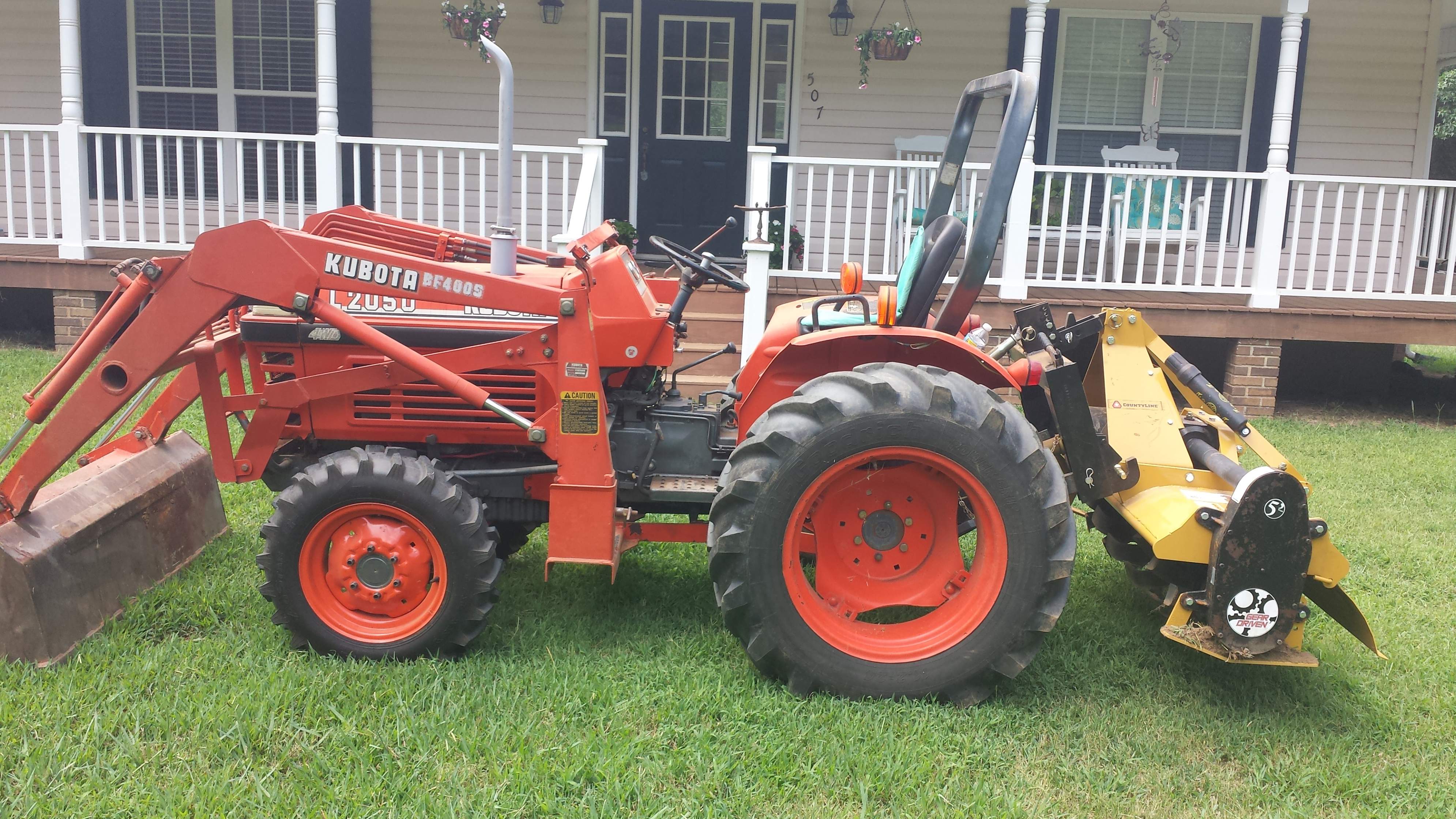

I really enjoy my Tartar 60". (County LIne at TSC) And once I've gone around my place and cleared roots and rocks out I've the option of reversing the direction of rotation. But I can't imagine ever needing to do that.
