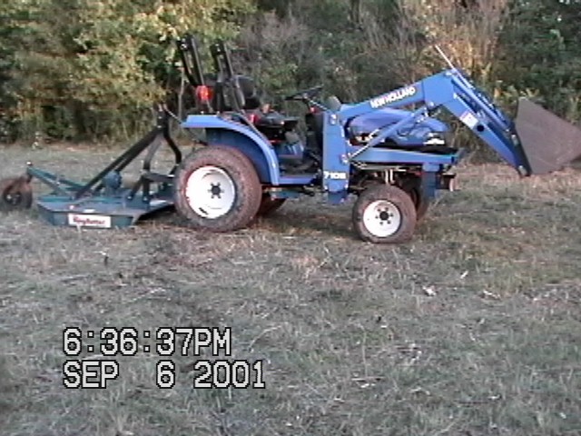

I have the 48" KK brush cutter on my TC21D. Works great and the tractor handels it just fine. Ide do the 5' on my tractor, but i like the 48 so to get inbetween trees. Power wize the tractors got it no problem.

Tried adding a attachment in edit mode to my reply and the site wont do it so here it is

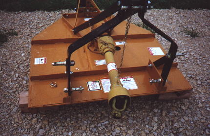

I have a 48 inch KK on my B2410. That would also be the most useful size for your B7500. See the threads on modifications to rotary cutters. You will have to drop the pins to the lower bolt holes to make the KK work.
Those First Choice look nice. J

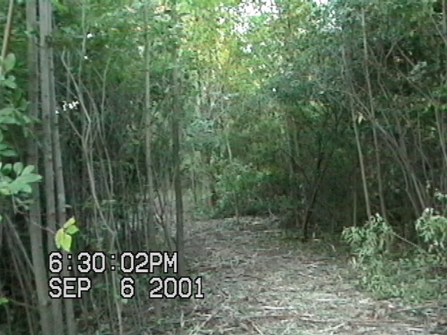

1" Trees are no problem. Ive done 2" plus, but i push them over with the loader then slowly back the hog over them at a high setting then lower on to them. Turns them into spliters if ya do it right. Take the big ones slow. It will spliter the stump down to about 2" high and rot off by the following year as ya mow. I rarely staul my tractor bush hoggin. here is a pic of a path i bush hogged into my woods.
