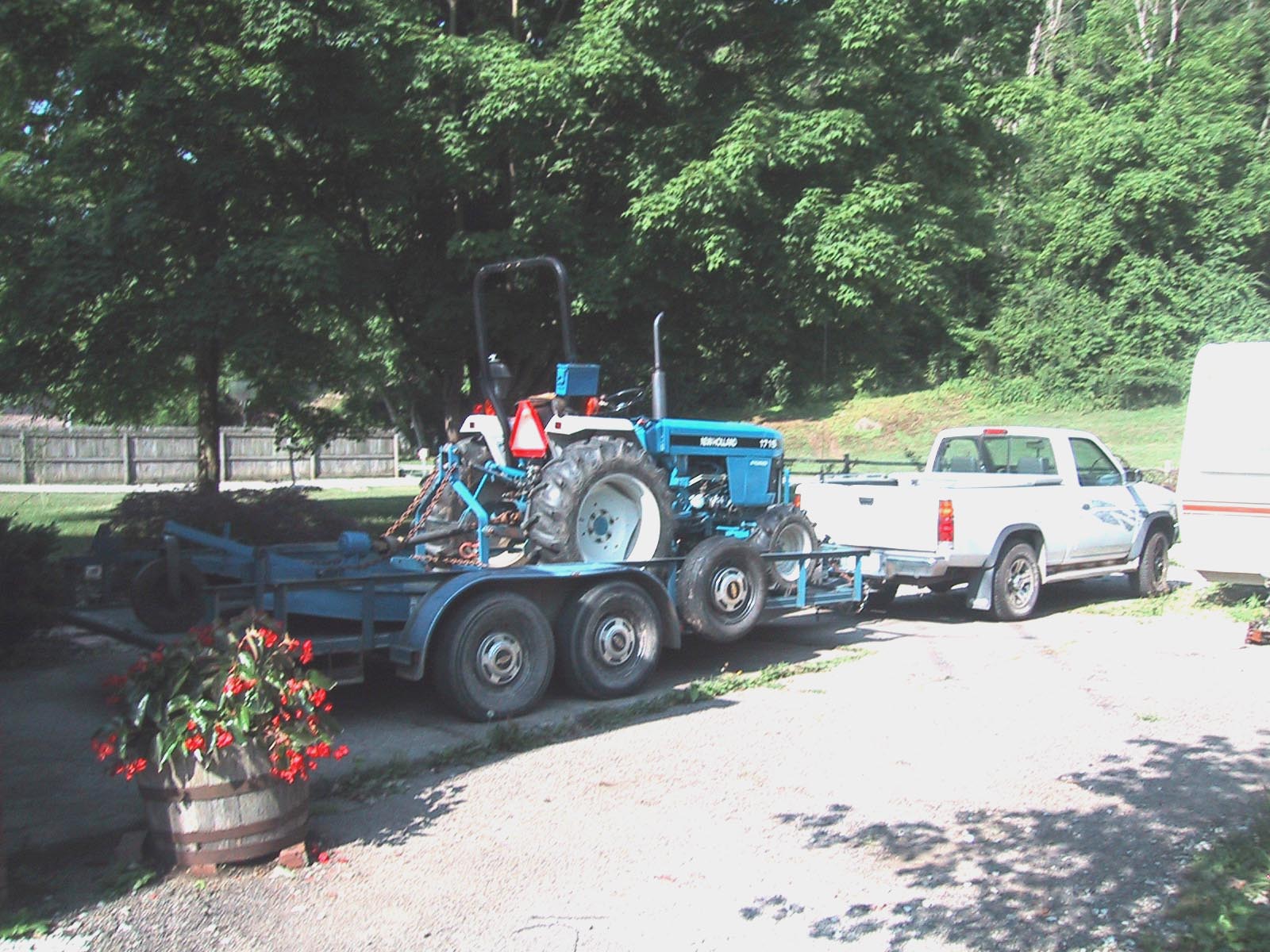

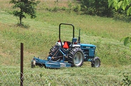

I have had one since 1996 and still use it is a hay side 5'.
