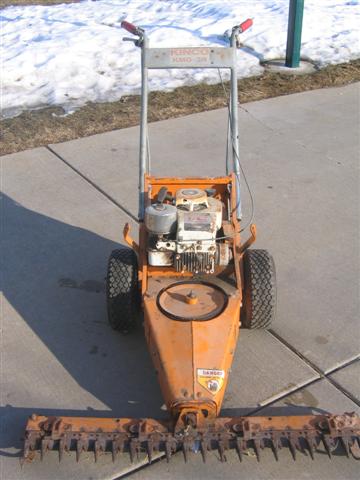

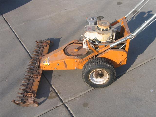

Hello,
I'm new to this board... lots of good stuff here. I recently acquired a Kinco KMG 38 walk behind sickle mower. I found some info on the manufacturer, and gave them a call, but there facility in St. Paul, MN was still closed for the winter. I'd like to get any available owners/service/parts manuals that might be available. If anyone has this info, I'd gladly pay for a copy of it.
On a related topic, the tires are 4.10/3.50 - 6. They're shot. I've found some Carlisle 4.10 - 6 lugged tires. What is the difference between a 4.10/3.50 - 6 and a 4.10 - 6 ?
Thanks in advance.

Hi,
I've been searching the net for info on my Kinco KMG-38 and ran across your post. I have been able to get all the belts and tires locally. Tractor Supply had the 4.10/3.50 - 6 tires for about $20 each. The belts came from Bearing, Belt and Chain. I pulled the motor apart to get it cleaned up and it is almost running, but I need to replace the carb. It is not rebuildable.
I think the blade sections are availbable at Tractor Supply also. I saw some Combine replacement blades there that look similar. As far as the rest of it, the bearings and things are all standard sizes. The sliding pivot, under the big pulley, was frozen up. But after figuring out how to get the aluminum bar off (I had to remove the 6 bolts that hold the nose one, where the blade begins) I was able to clean it up and make it work like new.
The last thing that I need to do is get that new carb. It's a Tecumseh 3.5hp engine and the parts and carbs seem to be available. I'm anxious to get it going, it looks like it will do a good job on tough weeds and grass.
Good luck with yours, it looks like it's in better condition than mine was.

It's been awhile since I checked in on this posting. Great to hear that there are other Kinco owners out there.
JD316, I spoke with someone at Kinco in St Paul, MN, he indicated that the sickle sections for Jari Mowers are an exact fit for the Kinco.
I used my machine quite a bit this summer mowing mountain bike trails. The little machine is quite a mountain goat and will climb just about any hill.
My KMG28 has a Briggs and Stratton 4hp, so I can't be of help on how the governor linkage is set up on the Tecumseh.
