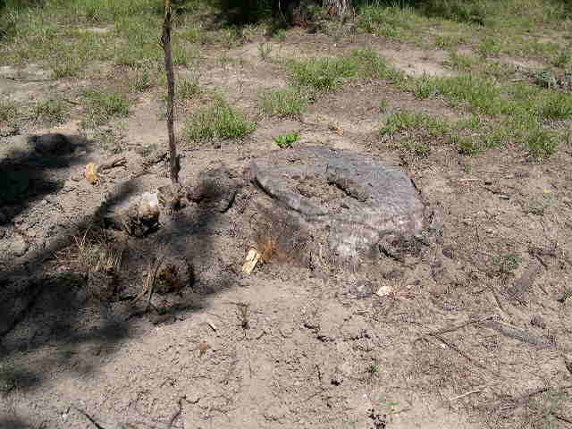

i was considering renting a stump grinder to get rid of some old oak stumps that stick up a little too far to comfortably mow over. i didn't like the idea of using the stump grinder (DANGEROUS) and found out about these chains made by RAPCO INDUSTRIES and intended for stump cutting in the dirt. carbide tiped and bad***. i have a landscaper friend that has cut over 500 railroad ties with one. i keep a can of contractors dayglo marking paint (sprays straight down) on the tractor when i mow and if i find a stump or rock that needs addressing i give it a shot and go back later and make it go away. about 125.00 but iv'e spent way more than that on chains and sharpening before.

to cover with dirt you would need to fill 6 to 8 feet around to make it gradual slope. if not, when you mow, you just mow the dirt off and hit the stump anyhow. i picked an extreme example to attach. took about 10 minutes to cut and chain is just as sharp now as when i started. from my past experience, this stump would have killed a 20.00 stihl chain and had to be sharpened twice to cut it. see exibit A.

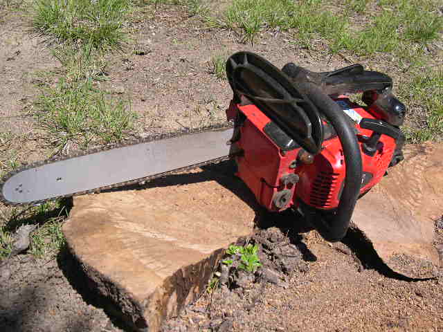

i use it on a redmax arborist saw and a redmax pro saw to cut the tree. i have used stihl and husky. they all have held up well and no problems with the bar. the regular chains would not hold up. dead oak is one step below concrete on the hardness scale. exhibit B
