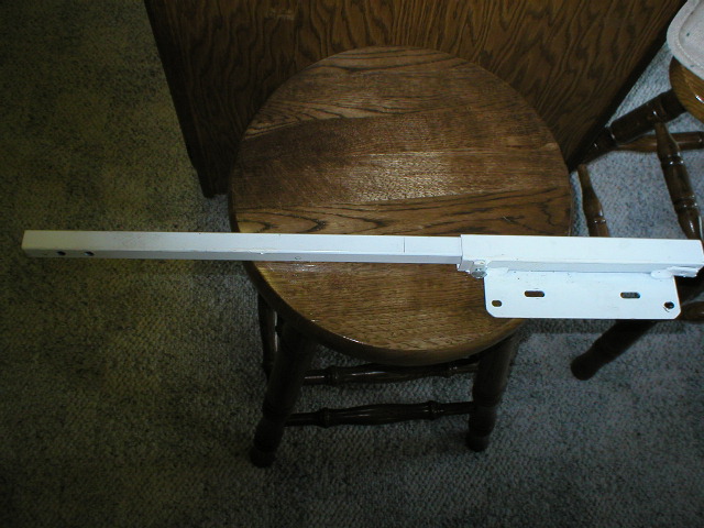

Found this in my junk pile today......it's an adjustable support for a shelf/facade for retail shelving. I can use a square U-bolt around the horizontal support for the the back blade. I'll need to weld a foot on it and drill holes for a hitch pin or pins to keep it at the desired location. I can use the place that the set screw in the picture is at now. The longer leg slides up in the the other square tube. Lower the support for removal from the tractor, and raise the leg when attached to the tractor.

Jim, your's look nice. I saw a stand by Freedom Hitch a while back that looks like Kodiak's to me. They probably make it adjustable since it's not custom made for one implement.
http://www.freedomhitch.com/index2.html
This link is a FH page, then you have to click on Models, Category I, Accessories and finally Adjustable Leg Stand. I think I was quoted $29 for it but never got it. Still using a wood tripod I built.

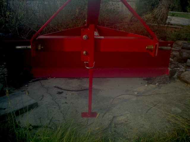

Take a look at what it looked like <A target="_blank" HREF=http://www.tractorbynet.com/forumfiles/5-194748-P9160023.JPG>Before</A> and look at it now. I welded a foot on it. Attached it with a 3'square U bolt. This is in the down position. The picture of it slid up in the 'travel' position didn't come out.

Although I do like Jim's idea better. It mounts at one of the lift pins, so it should fit a lot of attachments. but if you look at my Wallace blade, it wouldn't work too good I don't think.
