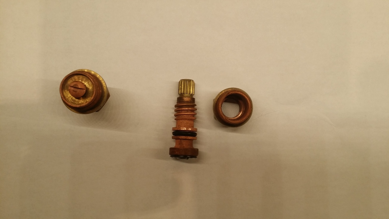

Yes, we use about a teaspoon in the rinse dispenser. It works far better than the commercial products. We were using a commercial "spot eliminator" that was not doing the job, thus the question to the repairman. I looked up the record when we bought this stuff (I use Quicken). We bought 30 pounds from Sure Crop Feeds in Grindrod for $85.50 including tax(probably around 12%) on December 1, 2005. We still have a couple of small pails of the stuff and gave samples to friends.
It is great for cleaning scale and sediment off copper plumbing fittings, garden sprinklers, etc. If you put them in a dish with a strong solution small bubbles start immediately and the fittings will be completely cleaned.
Here's a photo of a couple of tap fixtures I cleaned just for fun when I changed them last year. I don't have "before" photos but they were completely covered and gummed-up with green and white scale:
