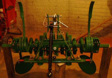

   / Keulavator VS Garden Bedder #5
A friend of mine gave me his soil ripper off his old JD M. I had it converted to 3ph.
The soil ripper is very similar to a Keulavator with some cultivator tines attached to it. Attached is a picture of mine when I had it.
After the soil ripping, I mounted 2 opposed discs on the bar instead of the cultivator tines. This made very nice raised rows. Attached is a picture of it.
Later on, I bought 2 smaller diameter discs and mounted them and some cultivator tines onto the bar. Found a picture of it, too, attached. Never used it.
Because I was using no till, I never used the soil ripper and discs again and gave them to a friend who had a tractor just like mine.
He was going to share it with a couple other guys. Would you believe one of them asked whether I had a operators' manual for it? My friend has a very high IQ but I wonder about his friends.
Ralph
