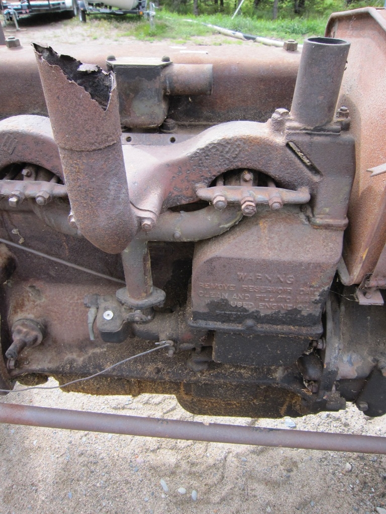

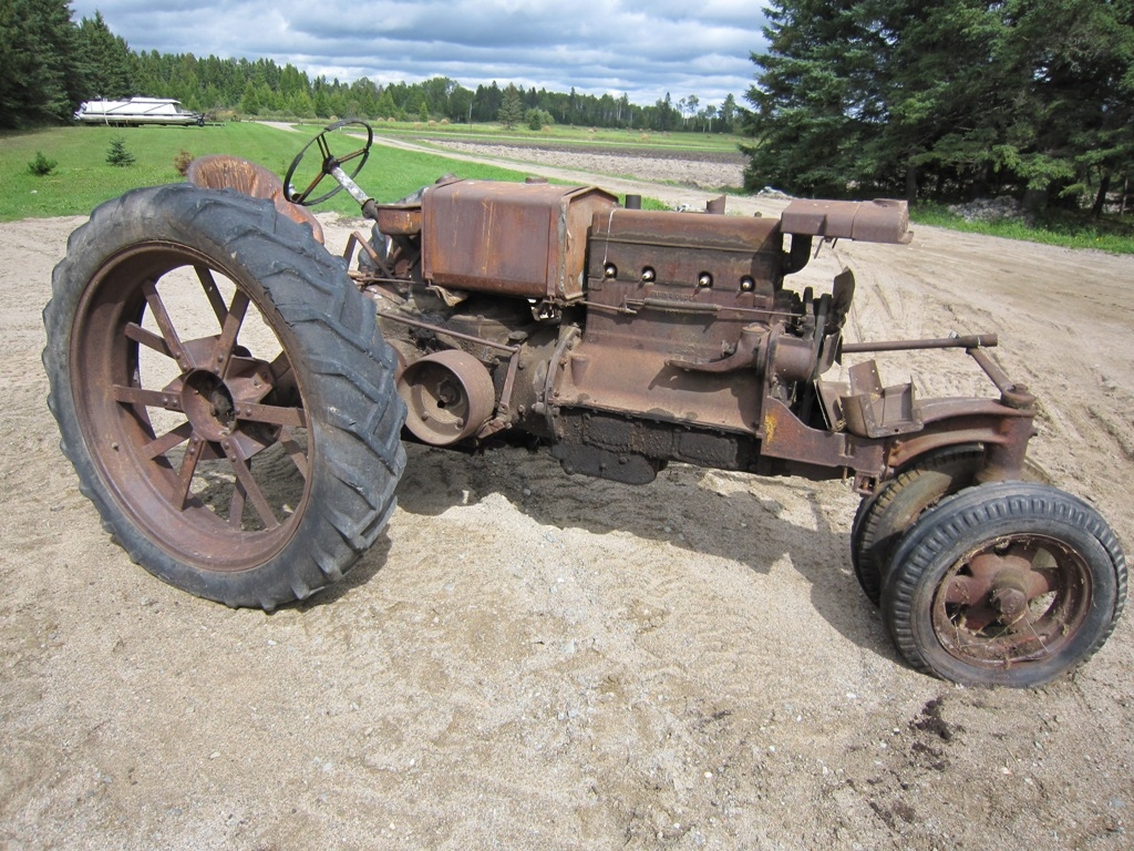

Earlier I mentioned my 1928 Case CC starting on gasoline and switching to kerosene. Here are pictures of the tractor after I recovered it from the trees. The fuel tank has 2 inlets - one in the middle for kerosene and if you look at the rear of the tank, a second portion with the slanted filler for gasoline. The second picture is a close-up of the intake showing the exhaust manifold partly incorporated with the air cleaner to clean and heat the air before exiting to the carb. I can't tell you about the lever and wire going to the carb area - this tractor was parked in the trees long before I was old enough to drive tractor. I learned on a 1951 Farmall Super A. The engine still turns over but radiator and magneto have been robbed. But this gives an idea of what it took to run on distillate as a main fuel.

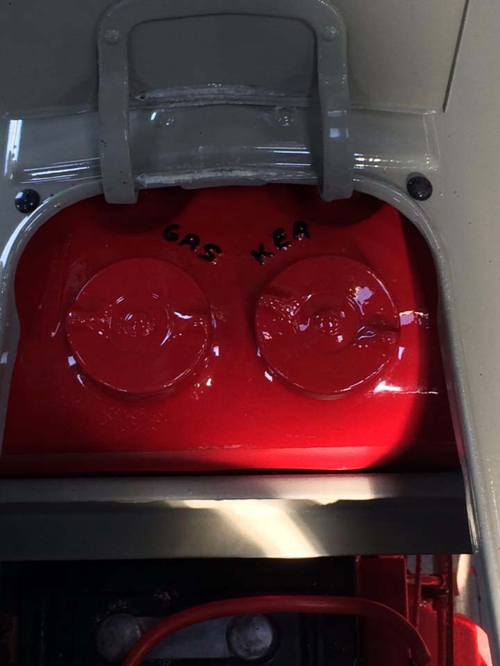

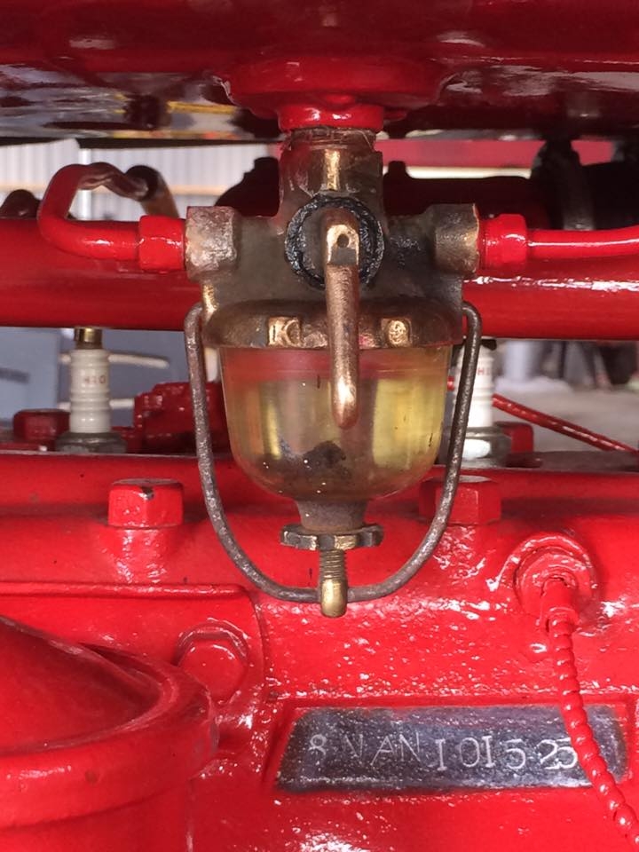

Back in the early days of tractors most were made to be able to run"tractor fuel" as it was referred to, now we call it kerosene. Some manufactuers referred to the as "all Fuel" Why? it was only a few cents a gallon and was cheaper than gasolline.
For the manufacturers to make a tractor run on kerosene they had to do a few thngs. Lower the compression to avoid knock, install two fuel tanks, a large one for kerosene and a small usually a gallon or so. Some even used water injection to prevent knock.
To run a tractor on Tractor fuel first you open the valve for gasoline to fill the carburetor, start the engine leave it warm up, close the gasoline valve and open the tractor fuel valve. Now you are ready to work.
To shut off the tractor you turned off the tractor fuel valve and allowed the engine to use the fuel in the carburetor. Next time you went to start the tractor you would be able to start it on gasoline, most would not cold start on kerosene. Even then if you shut it offon kerosene there was usually a drain on the carburetor bowl to drin the tractor fuel.
During the fifties most owners just filled the tractor fuel tank with gasoline and did not bother with the tractor fuel. Even most farmers converted the engine to gasoline only. Diesel was also being introduced and became popular about the same time.
Why use tractor fuel? price and sometimes was easier to get than gasoline.

Spark ignition engines that ran on kerosene or "tractor fuel" typically had a lower compression ratio head than the same engine designed for gasoline only. Many also had adjustable shutters on the radiator so that the tractor would warm up faster and allow the operator to adjust as necessary to maintain the operating temperature. When running on kerosene, the fuel was more likely to work past the piston rings and dilute the oil. Some tractors had multiple oil level plugs in the sump to drain off the fuel. The thinner kerosene would tend to sit on top of the motor oil in the sump. Each morning the operator would remove the lower level plug to drain off the kerosene, and then refill with new motor oil up to the upper level plug. Quite a bit of extra work was necessary to run the lower cost fuel. The Case CC tractor picture that MHarryE posted above has the multiple oil level plugs in the pan visible on the right side of the engine. That tractor is very similar to my Case DC tractor, although mine has the higher compression "gasoline only" head and no radiator shutters.
