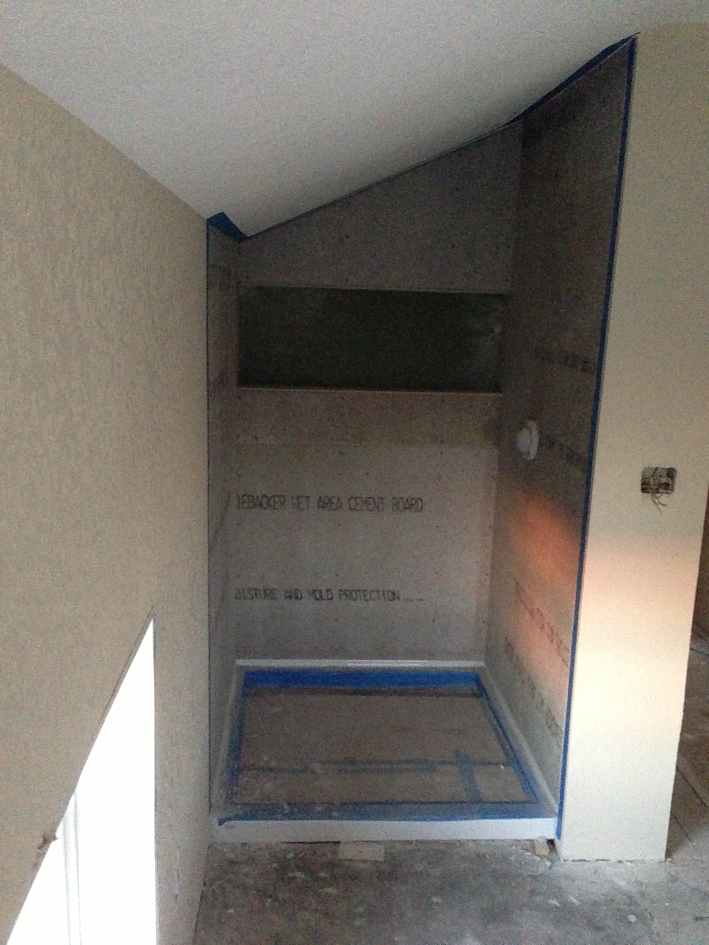

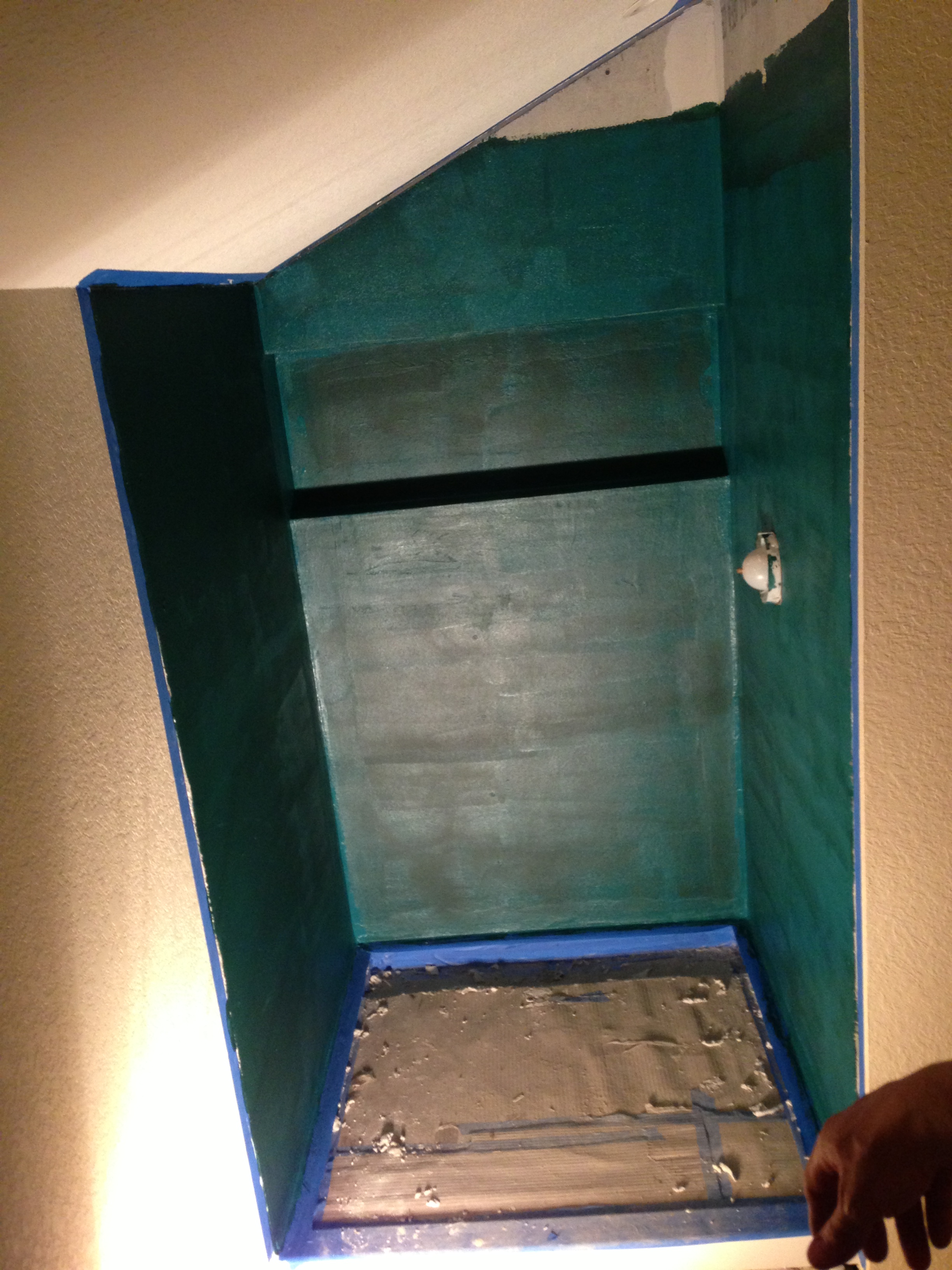

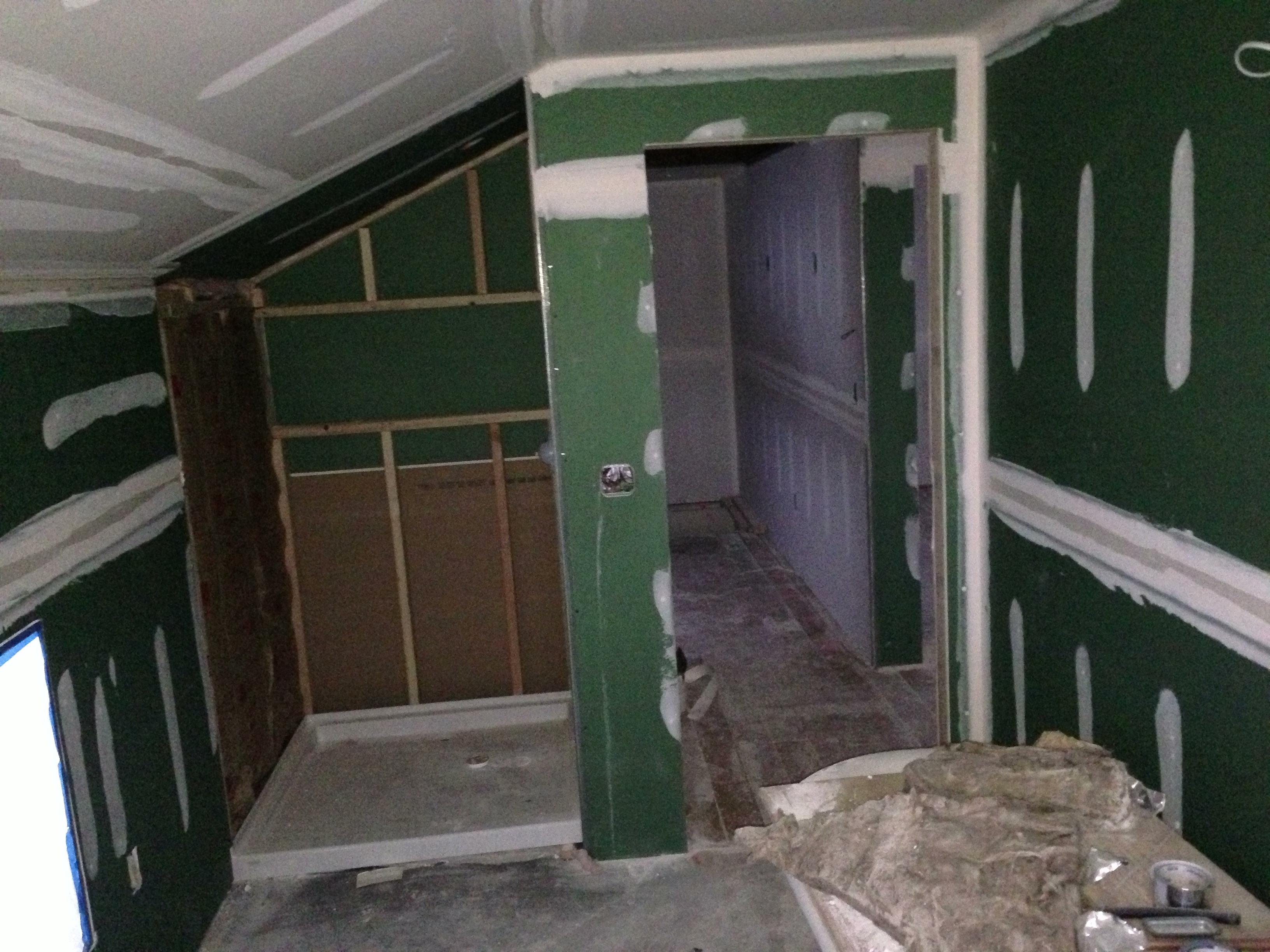

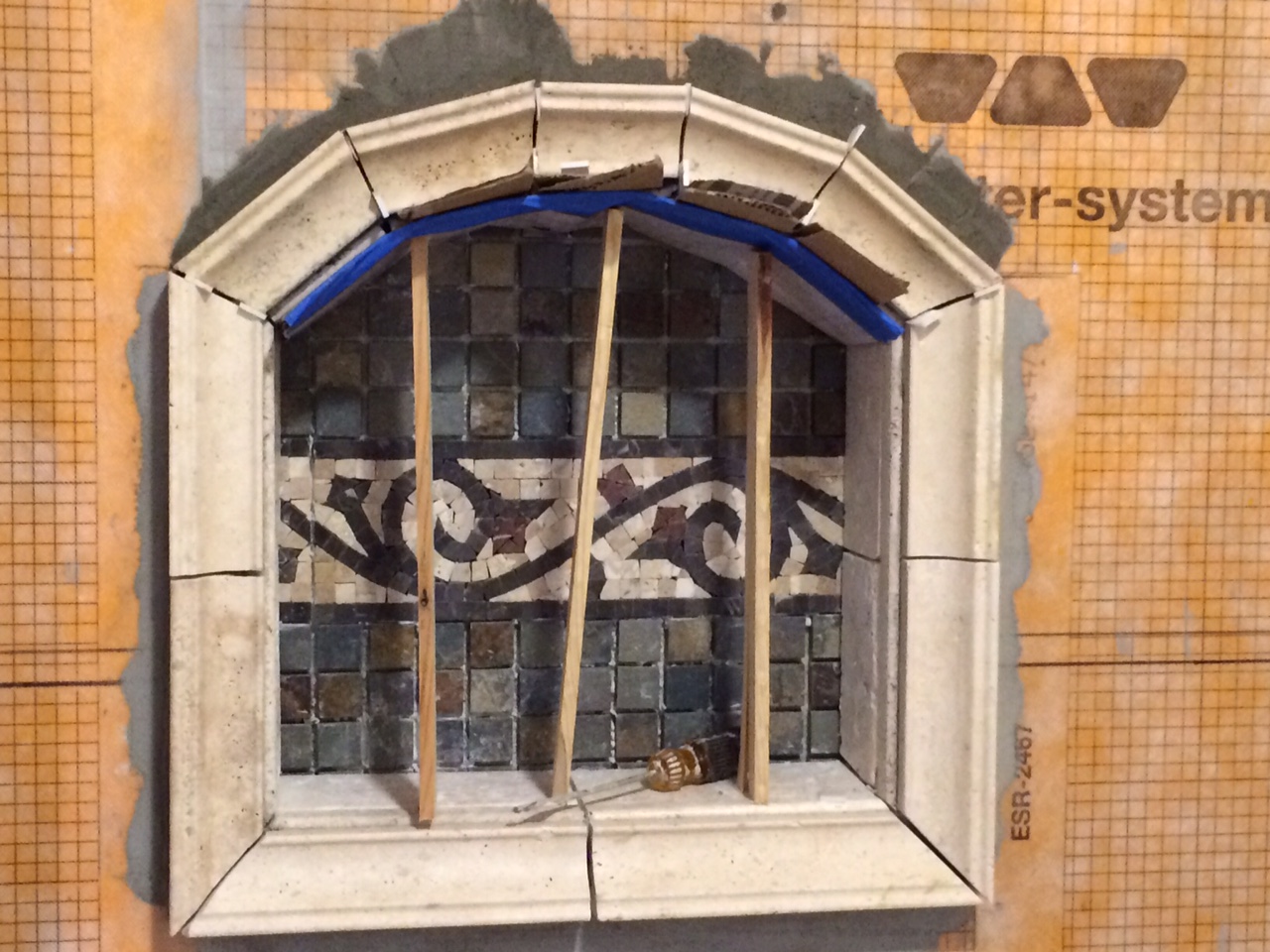

I just did a fairly complicated corner shower stall, curb with 45 degree angles, stub walls to attach shower glass etc, and I am definitely a do it yourselfer not experienced at this sort of thing. I got the ideal I could tile because of some floor projects that turned out to be very gratifying. I avoided the short cuts so many are tempted to do and got some floors that looked better than I could have afforded to pay for.
But the shower was more of a project than I wanted it to be, and the main reason is that there are so many ways to mess it up. I could do another one like a breeze but getting my mind straight in figuring out about the modified, vs modified thinset, the pros and cons of concrete backer board, how to meet corners and lap joints and still keep a flat enough surface for tiling all turned into time consuming things to deal with as I moved along.
I used concrete backer board, and yes you can wet it and let it soak a bit before applying the membrane and no problems with the thinset curing so it will hold. My drain was off center so I poured a mud bed and used the kerdi drain kit. Figuring out about the floor mud for the pan brought come confusing reading but I actually got it done and shaped very well, just had to think it through, and plan my moves for maintaining shape. If you do not keep the mix dry enough it simply will not maintain the slope you work so hard to build. As you work packing one portion to the proper slope the disturbance will cause the other portions to move down hill away from the wall creating a swag. If you get it dry enough to hold slope then you have to absolutely make sure you packed every square inch by tamping it with your screed tool. Easy to do if you have the experience, but first time learner is probably going to be having to spend a lot of time researching to make sure they understand what is going on.
I created a bit of a mess for myself in applying the membrane. I some how got it in my head I could wrap the membrane around the vertical corner about two or three inches and then lap the other wall over that. I would not advise doing that. I would use butt seems everywhere and use the kerdi band to seal the seams. The combination of overlapping seams and wrapping a inside or outside corner just is not wise unless you are expert at getting the right amount of thinset under the membrane and have a mix thin enough to be able to squeegee the excess thinset out. Even then it is going to create a bump that if is is in the wrong place can be a headache. Around a corner it is just about impossible unless the thinset is very soupy and the corner is perfectly straight. My wall had a bit of a otherwise not noticeable bow. I had high spots that I had to apply every tile setting trick imaginable to make it come out where as if I had simply butted every seem and used the kerdi band things would have gone much faster.
If I ever do another one I would not be afraid of using drywall. One mess I had to deal with using the hardie backer board is that the 1/2" stuff was actually about .4 inches so the thickness did not match. I had expected to just but the concrete board up to my drywall and tape the joint but the thicknesses did not match so I had to modify my build to have the junction behind some other design feature. Time consuming to the nth degree for a first timer. Some people love this kind of stuff, and I like problem solving pretty much but then this bath room took over my life for too long. The niches etc just took a lot of time. But it looks great already and in a few days I will be grouting.
Have fun.
My recommendation: use the drywall assuming you have the proper studding, and butt joint the membrane in all situations except wherever it might not matter with a thickness variation. The floor is another whole story. What ever you do follow a consistent scheme. I first was going to use kerdi membrane for walls and have a shower floor using the vinyl membrane between the to layers of mud used in those systems, since I was not clear about how the offset drain was going to work out for keeping all the edges at the same height. Iit would have worked but this is not a matter of buying some material and slapping it together like building a dog house or something. You know that I am sure but perhaps something I have said will help in deciding how much tolerance you want to bring to the table for working our situations as you go along. It will be a somewhat uphill learning experience if you want this thing to be trouble free and something you are happy to look at.

As I mentioned above, do not use drywall in the shower. It doesn't have enough stiffness to support the tile. Use a cement board product instead. Also, the bathroom should use a green board drywall which has a little more mold resistance than regular wall board. Also, don't lap the cement board over the shower flange. Butt the board to the flange and then fill the gap with thinset. This will keep the tile from tipping in at the joint.
I agree that a mud set shower is the best shower base, but you can use a shower pan if you want something a little simpler (but more expensive). Personally, I like shower pans because they are warmer on the feet. If you use a pan, be sure to bed it in some mortar. The mortar provides full support under the pan creating an incredibly solid floor and also allows you to perfectly level the pan so it drains properly.
While we are on the topic of techniques, be sure to "back butter" your tile. If you've ever seen tile that just pops off the surface, that's because it wasn't back buttered.

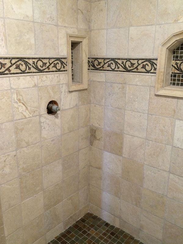

Nice job Bobcat. I had a similar experience, at least my wife said it took 6 months. It may have been. The one I am currently doing is not at the house where I live so I have totally worked less than 30 hours over the last couple months including demo of the old bath. Tile should be up this weekend and grouted the next. It is a lot of work but I like the work.
/ Kerdi shower system, a do it yourself project? #13
Thanks. Yes, if you like doing the work it makes a difference. I hate, absolutely hate tiling. I messed up the first time I put up the wall board. After it was up I found out how badly the wall bowed. I had to rip it all off and buy a power planer to plane down the higher studs. The low studs I sistered another stud along side it.
On a wall not in the shower, a wall I didn't build and because of plumbing limited what I could do with it, I had to buy special drywall mud that can be put on thick and float on 1/2" to 3/4" of drywall mud to get the bow out of that wall.
The second floor room in which I installed the bathroom didn't originally have plumbing. So I guess all in all it was a lot of things that added up to it being a ton of work. I guess an existing bathroom might be easier to start from.

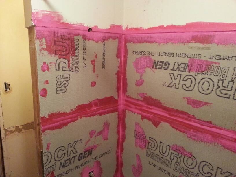

To seal the Hardie, I like to use Redgard waterproofing membrane from Home Depot. Cord mentioned something similar. Just tape your seams with heavy duty fiberglass tape and thinset, then the next day, paint on the Redgard. I just paint it on the seams and a gallon is always more then enough.
Then I paint a concrete bonding agent onto the rubber liner and let that dry for the night. The next day I mix 5 parts sand to one part portland cement with VERY LITTLE water. You want it as dry as possible, but wet enough that it sticks together. This is a bit of a pain to mix up because of how dry it needs to be. I do it in small batches with a coffee can to measure each part into a five gallon bucket, then mix it with my drill.
Getting it sloped and smoothed out is extremely easy once you have it in place. A regular concrete trowel works perfect for this. Just start in the farthest end and work your way back out.
When tiling, I start on the walls first. It is a lot easier to clean up anything that falls on the mortar bed then onto the tile floor. I do the same when grouting.
Back to Kerdi. I know several guys who own tile and flooring stores, and several contractors that all use Kerdi. They went to the free school that Kerdi puts on to install it properly, and they all became dealers. Their markup is very high on it, and I feel that's a big part of why they push it. Their argument that it makes the shower waterproof is kind of silly since a shower isn't designed to be waterproof. The tile sheds all of the water down to the pan, which is water proof, but there is always a hole in the shower wall where the water valves is located that will never be water proof. Why spend so much extra money on a product that claims to be water proof, when there is a hole in the wall for the water valve? To me, it's like spray foaming your house and having skylights. One defeats the other.
/ Kerdi shower system, a do it yourself project? #16
Water will always, always find its way through the tile to the hardibacker or Durock underneath the tile unless steps are taken to prevent that. That is why it is recommended (by the manufacturer) that plastic (poly) be put on the wall behind the durock or hardibacker. The idea of the poly is to contain the water and get it down to the pan. Durock is not water proof either. It has cracks in it, etc.
To me, its silly to contain the water after its passed through the wall material. I think the idea of poly behind the wallboard is utterly stupid.
That's why smart people like you use redgard or some other water proofing material to keep the water from going through the wall board to begin with. Just a note -- when using hardibacker, you should leave a 1/2" gap between the floor pan and the hardibacker so that water on the floor doesn't wick up the hardibacker. Then fill that 1/2" gap with silicone caulk.
Redgard is okay but as a painted on membrane I don't trust that it won't crack. Whereas, kerdi is a more durable membrane. It's harder to install then a painted on membrane but any home owner who does their research can do it if they are generally good at building things anyway. Plenty of youtube videos show how to do it.

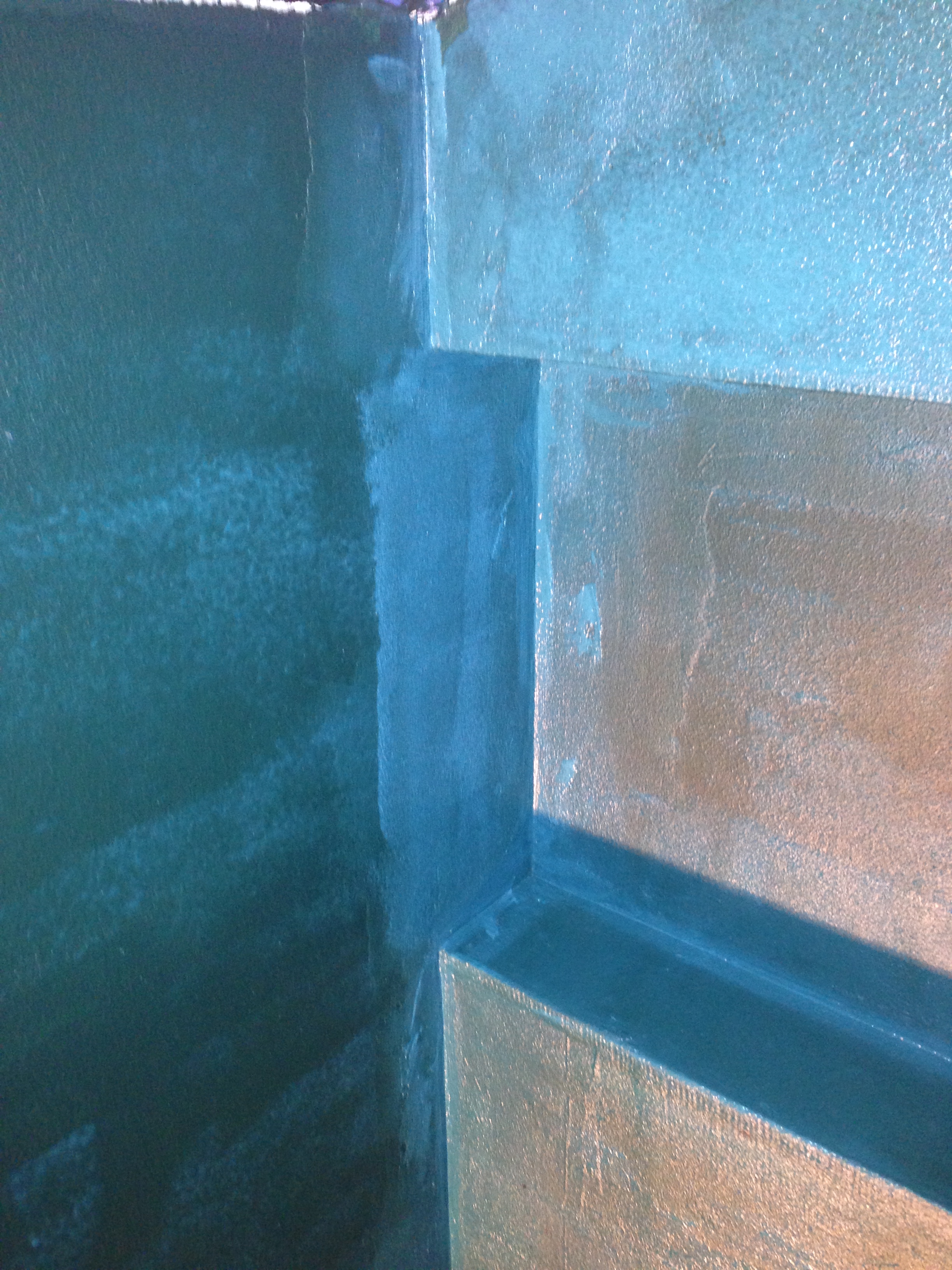

Redguard is the toughest stuff once dry that I've ever seen. This stuff is amazing. uploadfromtaptalk1461870210417.jpg
/ Kerdi shower system, a do it yourself project? #18
Redguard is the toughest stuff once dry that I've ever seen. This stuff is amazing. View attachment 466531
Warning, cement board (specifically Durock) is NOT waterproof. Per the Durock literature:
Water Proofing: "...if a vapor retarder or waterproof construction is specified, a separate barrier must be applied over
or behind the USG Durockョ cement board. If waterproofing is desired, use USG Durock Brand Tile Membrane or
USG Durock Waterproofing Membrane." http://www.usg.com/content/dam/USG_...durock-cement-board-system-guide-en-SA932.pdf
When building a shower, you want a "water proof" installation. If that was a tub alcove, then the installation would be acceptable. For it to form a water proof barrier, the membrane must be applied continuously.
