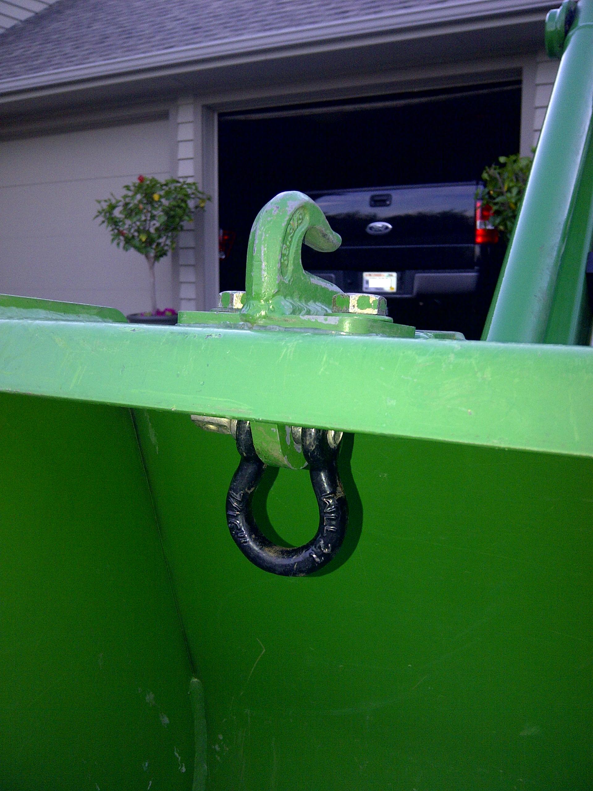

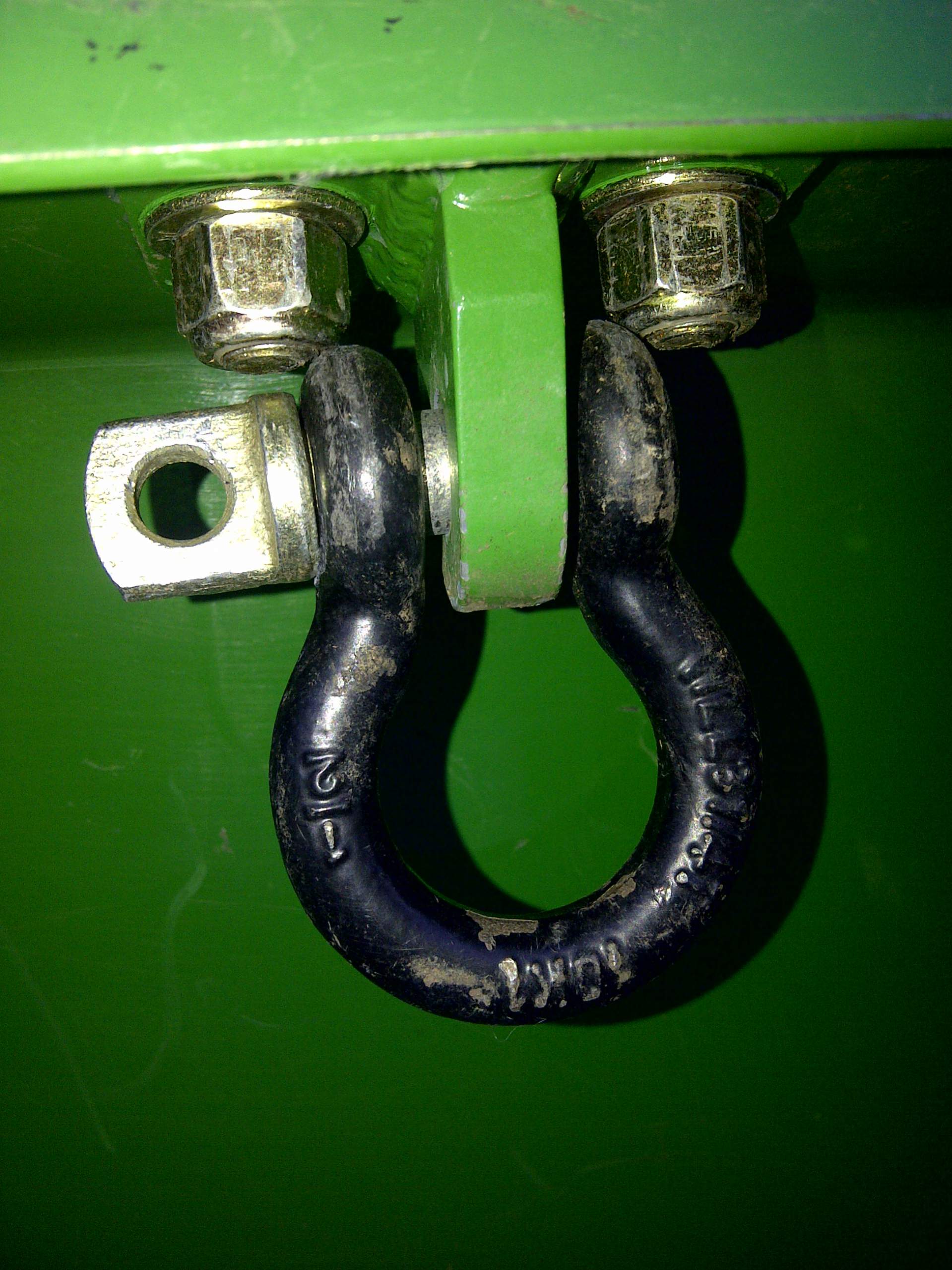

Lost, I have a question: How did you fasten the clevis mounts in bucket? Do their holes line up with the hook-mount holes? If so, that would be very handy. I am considering doing the same thing to my bucket.
   / Kens Bucket hooks Price worth it? #52
FYI, I put three grab hooks across the top of the bucket and used the clevis hook as the backing plate on the center grab hook. I also put backing plates on the two hooks that line up with the loader arms. The whole set up came out very nice and I've used the heck out of it in the month that I've had them on. If you email Ken, he can send you a pic of that set up.
   / Kens Bucket hooks Price worth it? #53
Creek...
As bullopa mentioned above, I also used the clevis mounts as a backing plate for the hooks. The template for the bolt on hooks and clevis mounts are the same.
I hope this helps.
   / Kens Bucket hooks Price worth it? #54
Thanks for that info. I checked with Ken also. Then I checked my bucket and it turns out that where the hooks would mount there are 2 layers of metal with space between them. That means my bucket can't use Ken's bolt-ons after all! So I'll have the hooks welded on.
Question: should I first weld a backing plate (1/4" thick?) to the top of the bucket and then weld the hooks to that?
