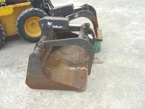

Mike, when you build your grapple bucket, or if you buy a separate bucket, you might want to consider having one with a solid back to prevent limb impalement damage to the tractor. Your project looks great!

Don since most of my work is done with the original NH bucket I'm thinking on something that bolts to it that can easily be removed if need be. Similar to the ATI product but possibly with 3 or 4 tines that are hydraulically operated.
The fun part is designing it, the hard part is making it work as intended.

Mike, A feature I like about the Bobcat grapple is that the four tines are controlled by TWO hydraulic cylinders connected in series (still uses only one set of hoses). See attachment.
When I grab an uneven load the grapples adapt to hold both sides tight.

Don guess I haden't even considered that point, I'm learning a great deal about grapples from folks like yourself. If you look at the picture of the grapple that I am using it also has two cylinders. Didn't even consider why until you made the point, so far I have only used it to move and stack some downed trees. Haven't had the opportunity to grab something like a boulder with an irregular shape yet. Thanks for the heads up, I'll give it a try!

Wouldn't the cylinders need to be in paralel not in series?

Yes Kennyd, the line "T"s off at the first cylinder, so that would be parallel. Thanks for the correction.
