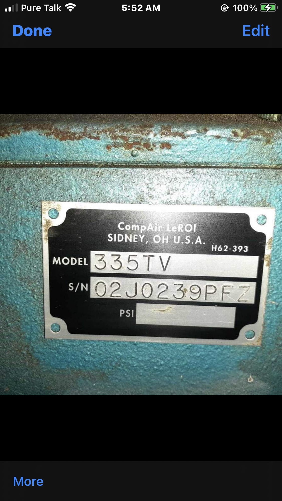

I’m going to look at a old compressor but it’s 3 phase and not hooked up so what should I be looking for? Anything particular?
I know I would need a single phase motor to replace the existing.

First thing I'd be concerned with is the tank. It's hard to tell in the pic, any water drain on it? Without it actually going it's hard to tell anything else......Mike
