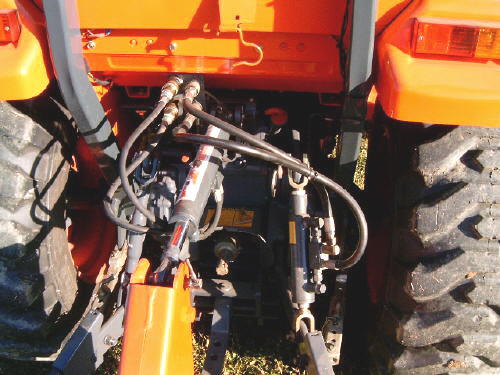

This question may have already been answered here, but I'm going to ask again. I have a 3PH log splitter that I don't use at the present time cause I've got a good old Lickity Splitter, but for a back up I'd like to have the 3PH splitter ready to go. If I install the remotes, (not the hose kit), and I move the lever to begin the flow of hydro fluid, do I lose 3PH lift? This would be Ok, but adjusting the height of the splitter would also be nice depending on the size of the log. I'm guessing that the 3PH is not affected with this setup because if you had TNT you would still need to raise or lower the implement, (box blade, rear blade, etc) ????
/ KB2375 assist #84
The 3 pt will not be affected by the remote.
Thanks. Let us know when you get them.

OK, I understand now. The loader valve diverter disables the 3-pt hydraulics. That's good to know. It is also NOT the case for the Kubota loader valves I have plumbed for b/hs. When I install this kind of hydraulic circuit for a b/h, I like to use one female and one male QA coupler not just so I can connect them together, but also so the b/h or other implement can not be installed backwards.
