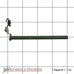

I have a Kawasaki FH680V 23 HP engine that the choke linkage has come loose. After searching and finding various diagrams I have not been able to find how the linkage hooks to the carburetor. It goes on the clip but how? Thanks for any help
   / Kawasaki FH680V 23 HP #2
The hook goes in the hole on the arm and the spring loaded clip snaps over the back of the link.
