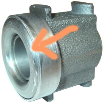

Nov 13, 2011 / Kabota B6100 release bearing #1 I IntrepidPD New member Joined Nov 13, 2011 Messages 2 Tractor KabotaB6100 Can someone be so kind as to tell me what side of this bearing should be against the clutch plate? I can not seem to find this anywhere. Thanks Attachments Kabota B6100 clutch bearing.pdf 40.5 KB · Views: 228
Nov 13, 2011 / Kabota B6100 release bearing #2 D DDM84 Bronze Member Joined Nov 16, 2008 Messages 57 The rounded side should contact the pressure plate. The picture shows the bearing already installed on the holder. Attachments image-1977540008.png 146.2 KB · Views: 197
