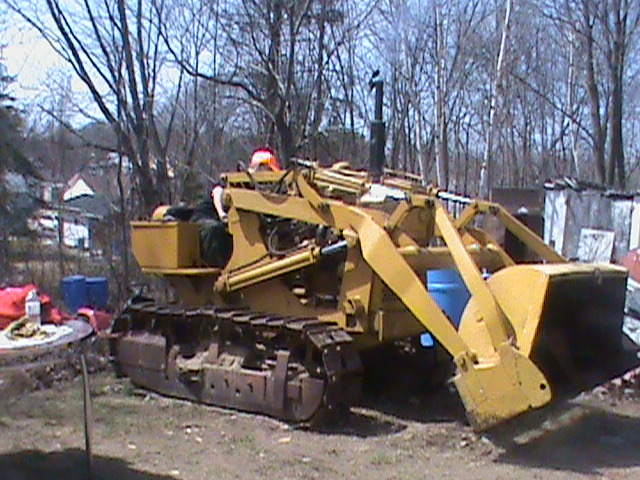

I don't know much about the newer Case machines, saying that my Dad ran Case his whole life and loved them, mostly 580 Backhoe CK series and a couple of 450 Dozers. They are easy to work on and run hard if you keep them up. At one point there were 5 in the yard, lots of different operators, as long as we maintained them they ran strong. When he passed away last April we still had 2, both late 80's and running strong. Too bad you had some bad luck with your new machine but I still feel Case are great. I just picked up an old Case 310-E last month and she is still going strong. Better luck next time DSC02367.JPG
