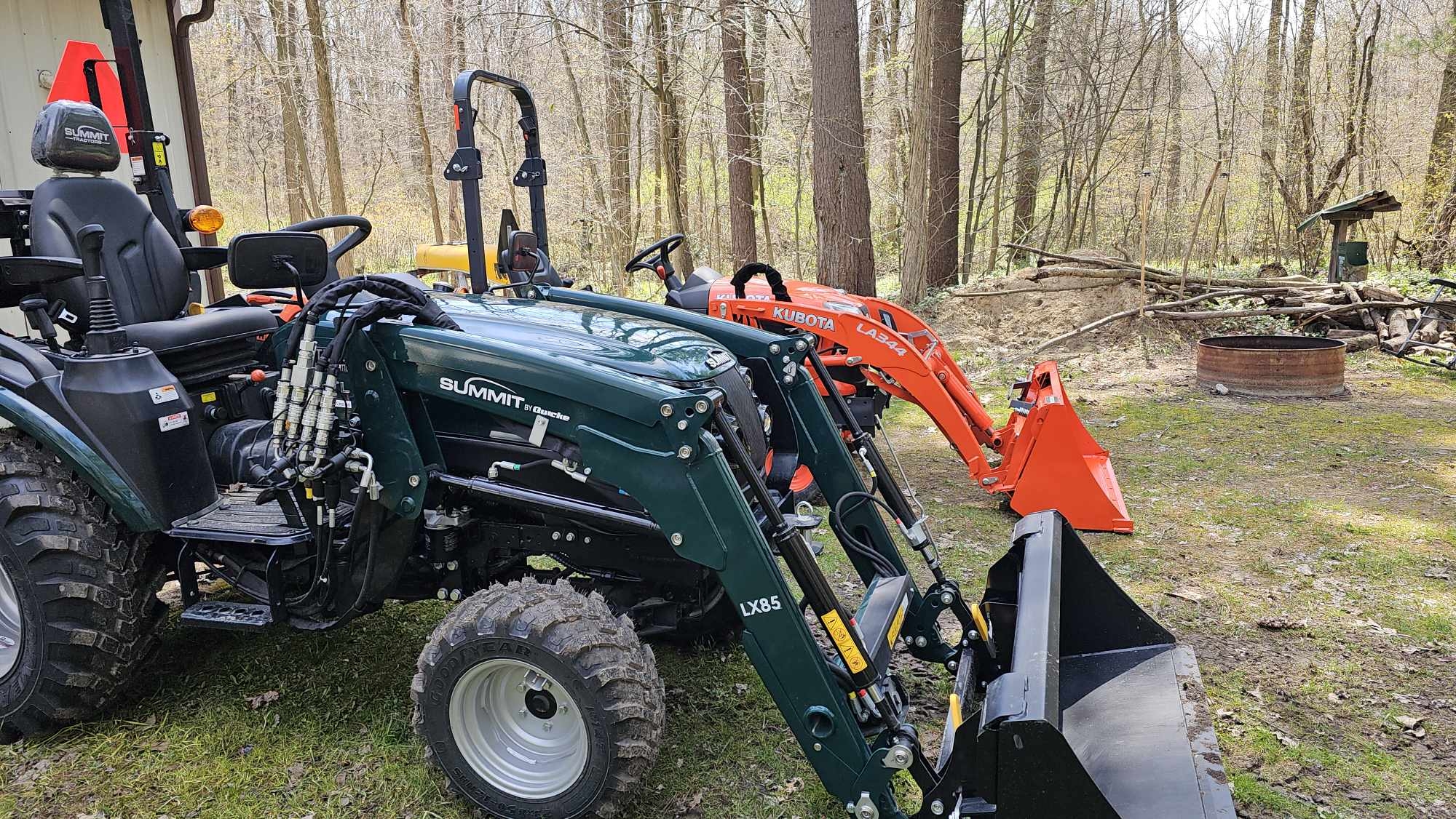

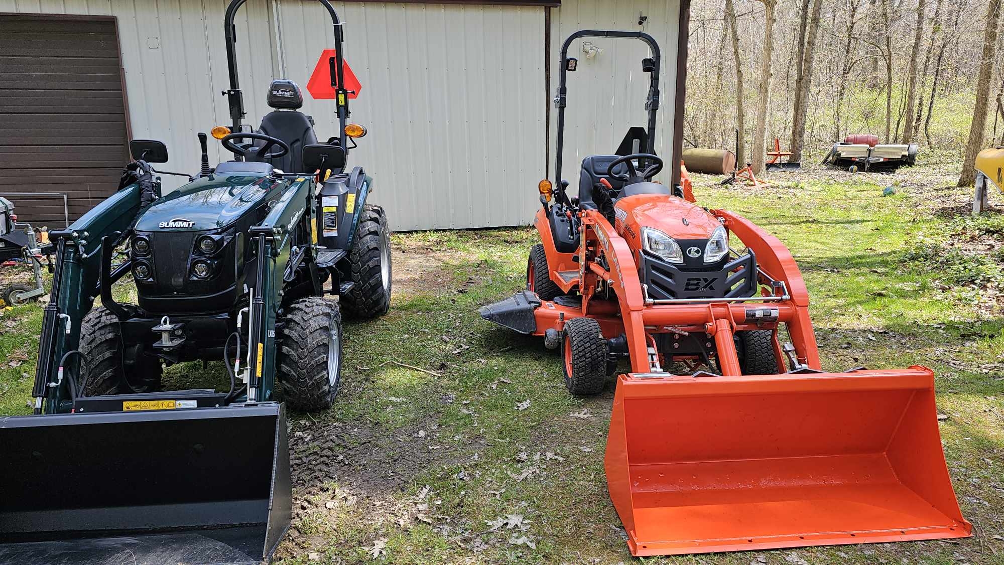

Just took delivery of my TX25. I am also a Kubota BX80 owner so I will be comparing these.

So I stopped by my local Family Farm & Home again, where I purchased my tractor. I checked all of the other tractors and ALL of them have the dipstick not installed all the way. @Summit Tractors Support you may want to notify your dealer network to double check the dipsticks. They are hard to insert, and it is difficult to see. This is the picture off one that hasn't sold, yet.
