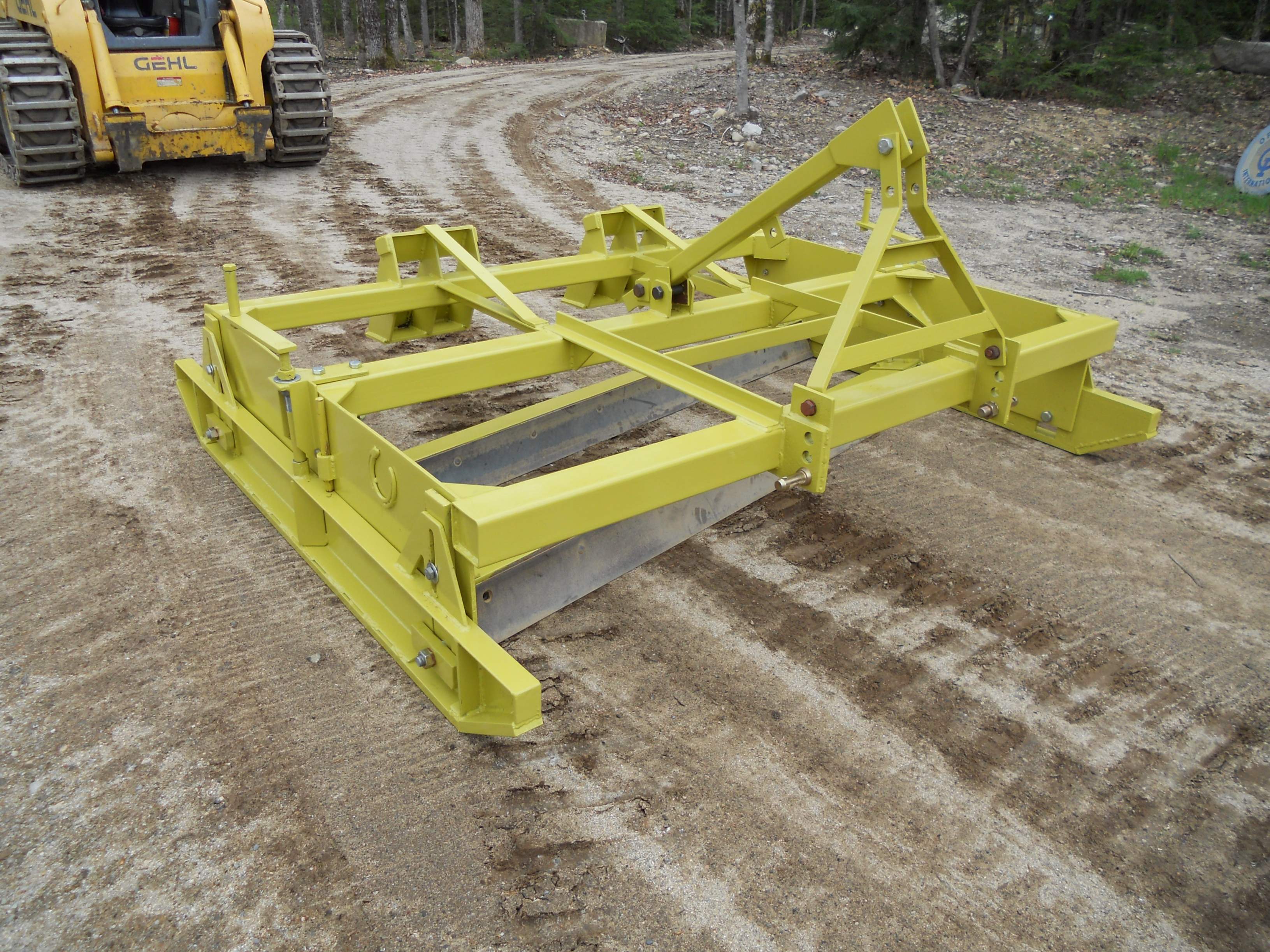

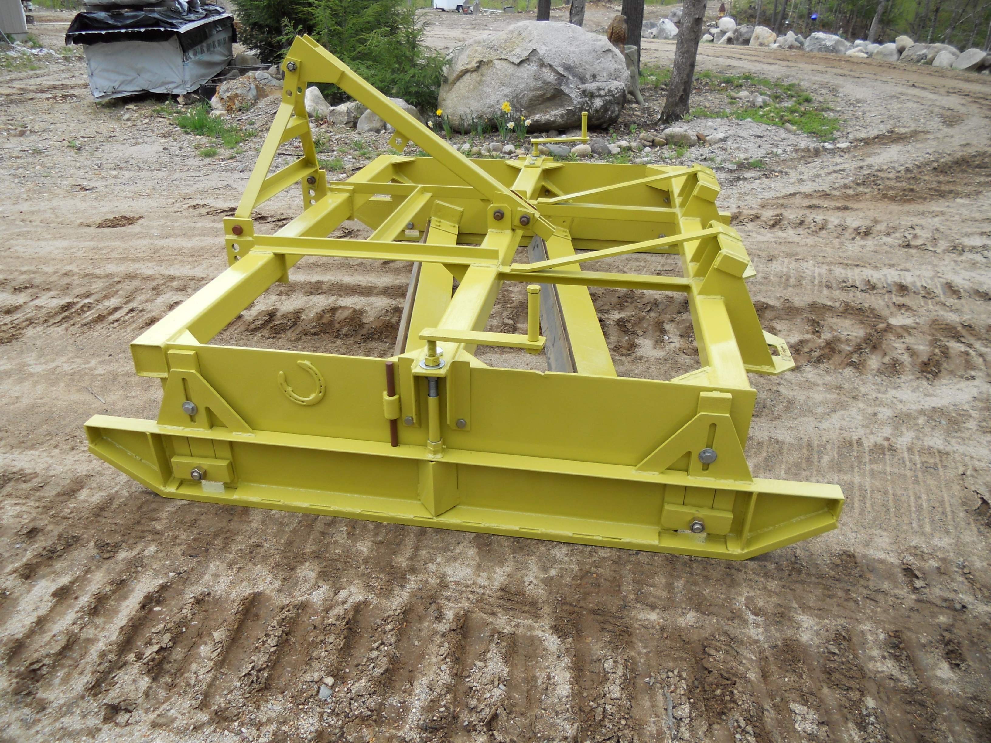

Here's a land leveler done that way, don't recall the poster's name but I got 'em here on TBN - if I ever decide to build one, it'd have a LOT of these features... Steve

I think you have a snow pusher in mind as the result of your modification. A box blade works in both dragging and pushing so you would need to be mindful of welding in a SSQA bracket and forfeiting part of the box blades function.
