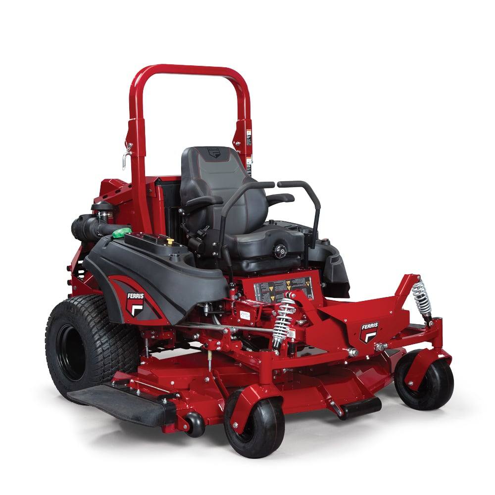

I had an eXmark last year. Brand new. Was 14k. I couldn't deal with the really rough ride. Thought my kidneys were gonna fall out. I sold it at a 1k loss and bought a Ferris with the awesome 4-link sprung suspension and was 4k less. So much smoother ride.
Ferris sells a 72" CAT diesel ZT for 36k

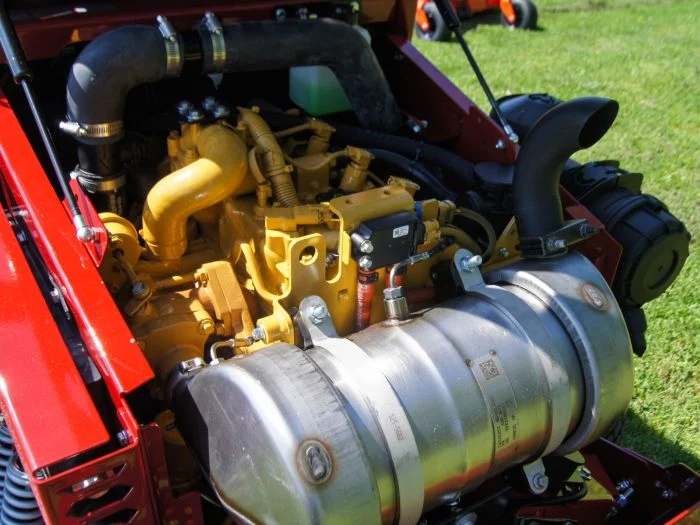

It's an Exmark Lazer Z 37hp diesel. No fancy cab with AC. Looks more or less like any other zero-turn I've seen.
I'm hoping someone who knows more about these things can answer a question for me. Is there ever an actual business case to be made for a mower that costs as much as my 75hp tractor? I just can't make sense of it.
