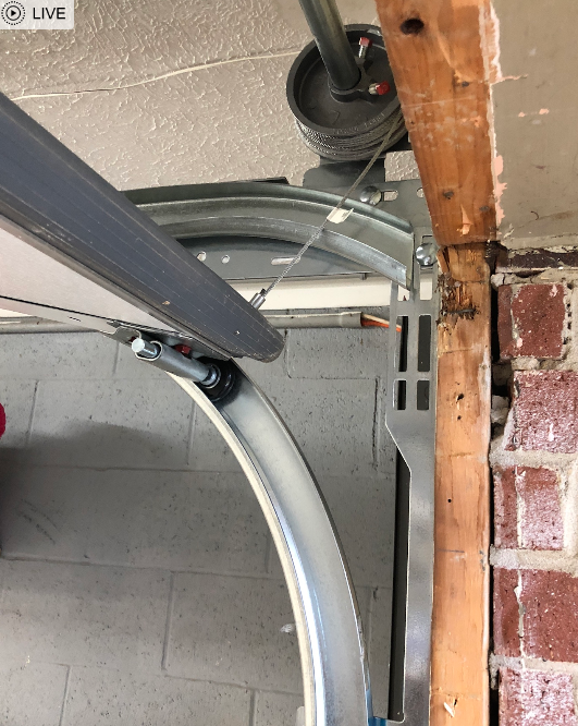

Also, the cable that is attached to the torsion rod rubs on the track. I can't seem to adjust it any way for it to clear the track. See third picture.
When I see that, it looks like the door is being allowed to roll too far back and up. The cable should not swing back that far from vertical.
   / Just replaced a garage door and have some odd issue's. #24
Door has to be pulled back by the opener for this to happen. Normally vertical will be all you get from springs and cable.
#25
It does. I think that is due to the low headroom kit and the second track. If it didn't pull back like that, it would hang down too low.
   / Just replaced a garage door and have some odd issue's. #26
I cant believe that door didn't come with struts to go across the middle of each panel to keep them from swaging over time. If I were you I would invest in some to attach to the door now before the panels buckle in the middle.
My 18 foot door has different type of rollers also. They mount in the middle of the joint with a hinge connection and attach to each panel for support. Yours look to only attach to one panel at the joint. I don't know how that will hold up.

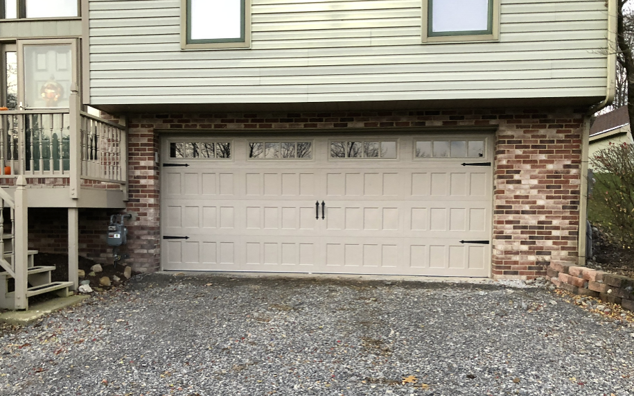

Here is the finished project. I love the door. Made a huge difference in the appearance of the house.
