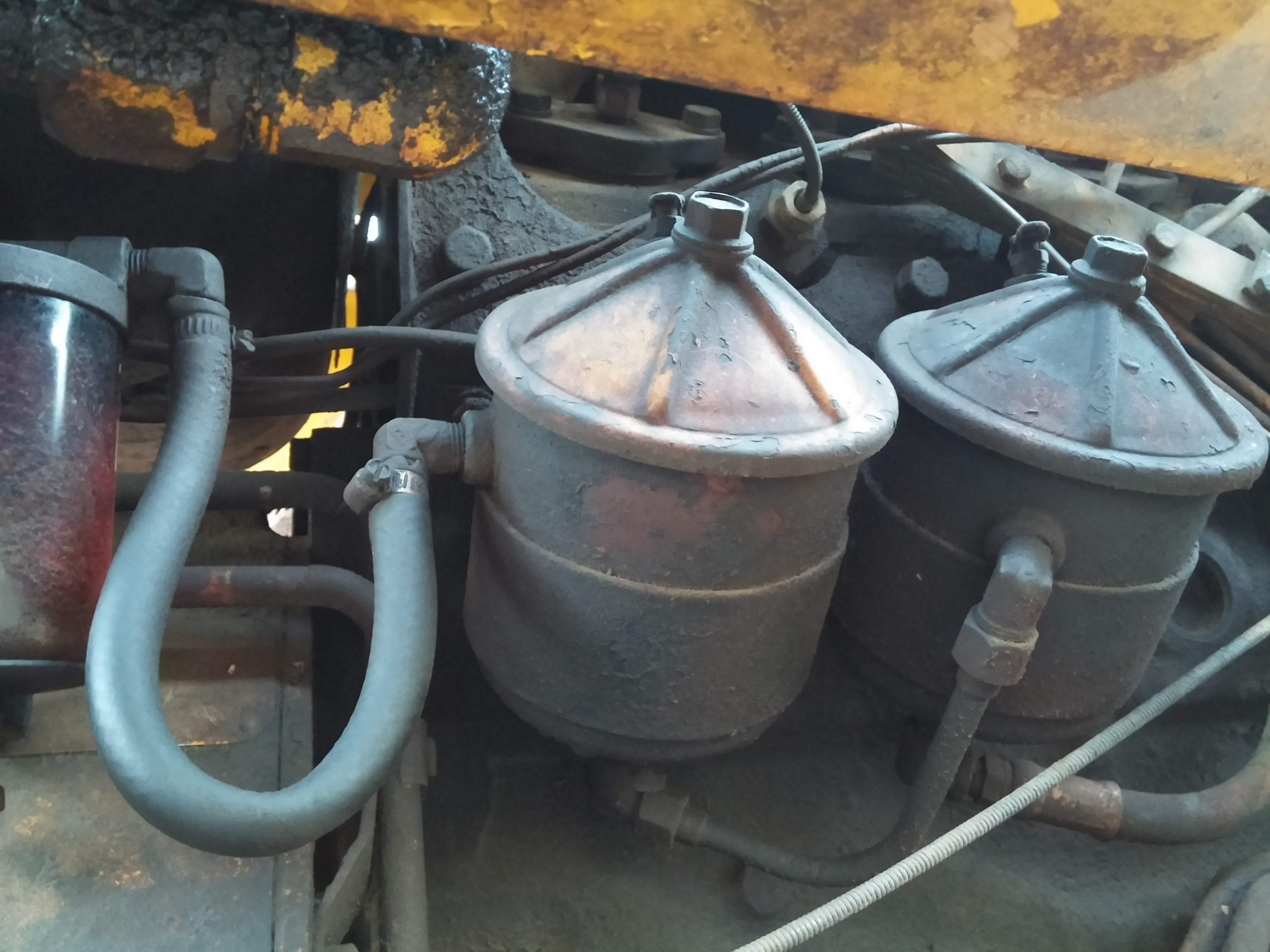

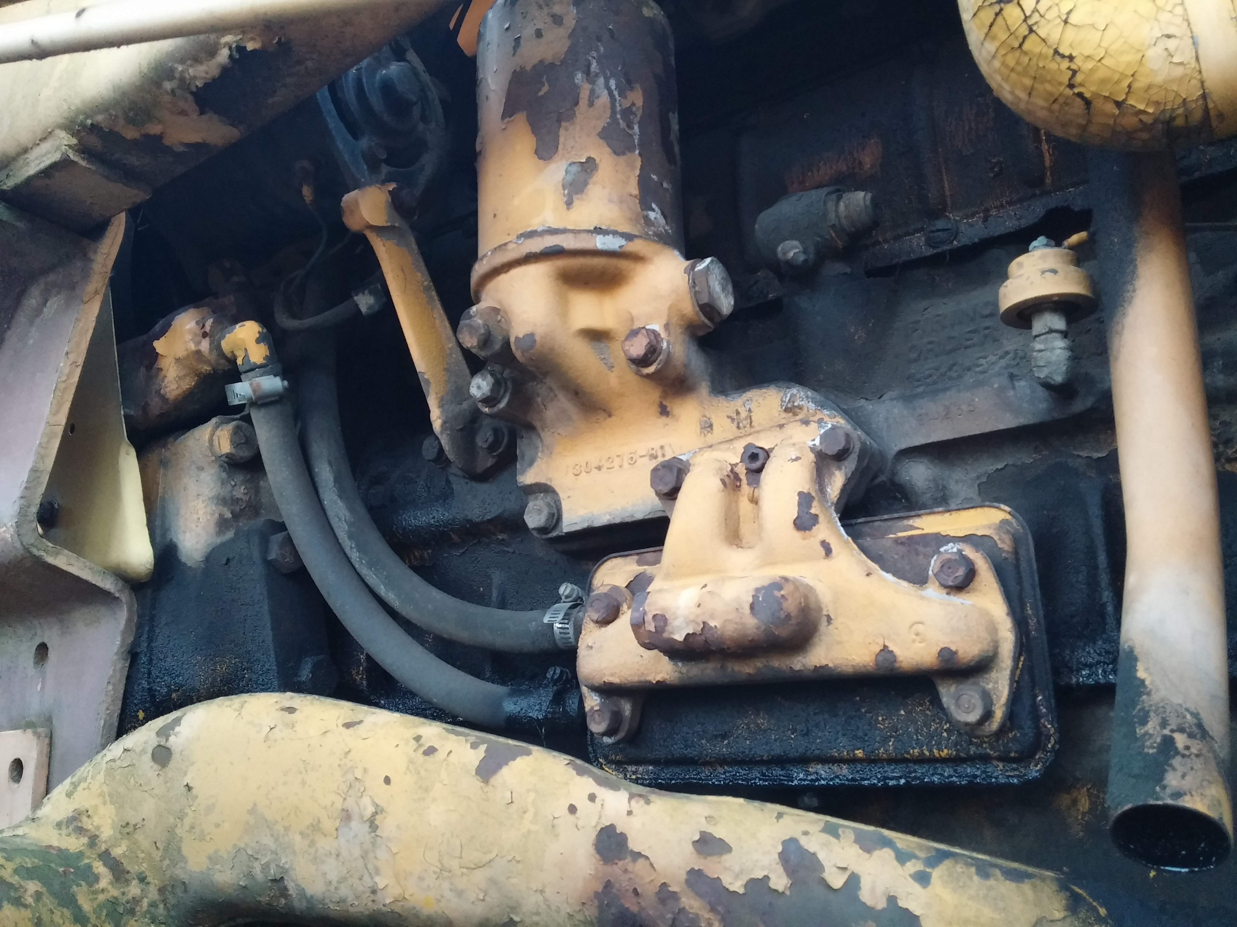

Also I found all of the filters: Engine Oil filter, Air Filter, Hydraulic Oil and fuel filters. I am going to remove them and see if I can get replacements at Messick's Farm Equipment. It will also give me a chance to check the hydraulic fluid. I also believe I found the fill and drain plugs for that.

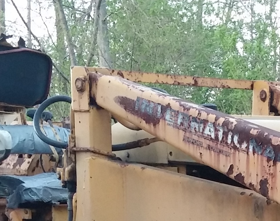

I forgot to get a pic of the Hydraulic Fluid filter but it appears to be located behind the right upper support arm of the loader. you can just see a tiny bit of it's edge under the I in International on the side of the arm in this pic.
