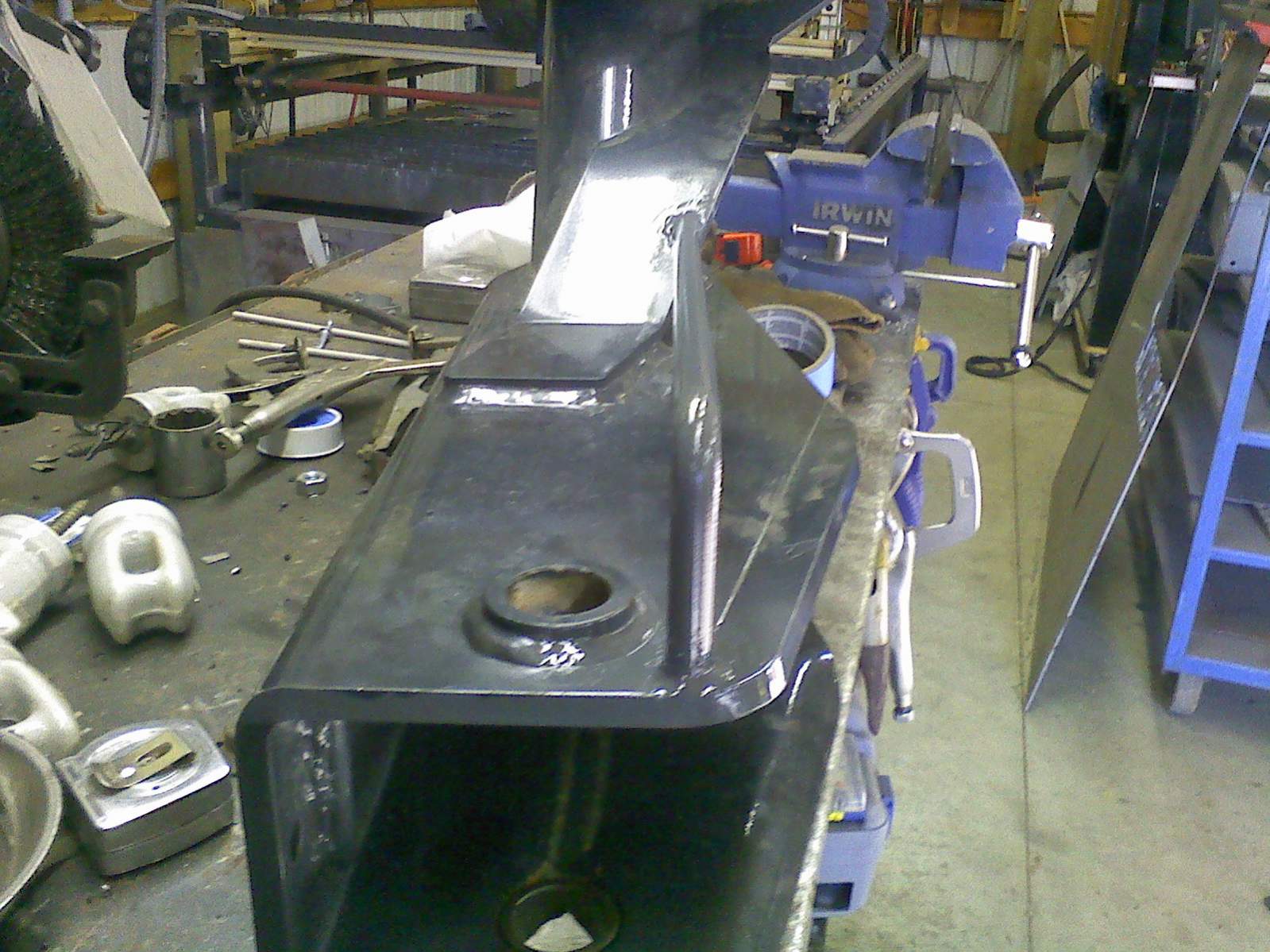

I removed my loader the other day to do the 50 hour maint, and i noticed some minor scratching happening on the gray engine cover and the hood on the side that has the hoses.
After i reinstalled the loader, i watched as i raised it to full height and lowered it to the ground... guess what. The hoses are rubbing on the metal.
This sucks. I tried ziptying the lines, but they need too much travel and movement. The zip ties snapped.
Guess its time to put on my old thinking hat. I cant leave it like this. if theres already scratches after 2 months...what will it look like in 2 years.

im worried about both really. there mot too long, at full extension there tight.
I think i know what ill do to fix it. will play with it today.

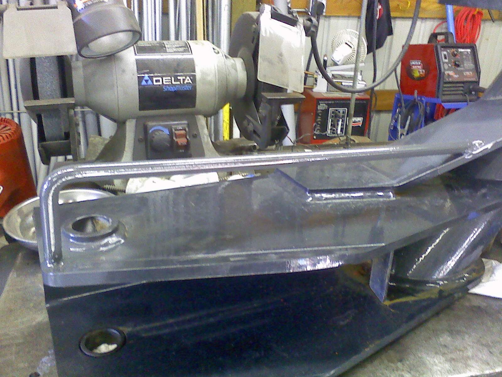

ok, its probably just me being ****, but i had to fix this issue.
Was actually pretty easy to do...took about 1.5 hours. I removed the loader support arm on the right side and installed a 1/2" diameter rod to work as a guide for the hoses. Works slick, and the lines no longer rub on the tractor metal. They also no longer contact the latch pin .
I noticed that the hoses were rubbing on the loader latch pin. this could of caused wear and tear no the hoses over time.
Now i just wish i could get a better match for the paint.

Kioti dealers sell spray cans of the orange- yours is the second generation paint color. Also can be bought by the quart, etc. I used automotive hardener to add to the paint when my body man repainted my damaged DK-35 hood.
There should be a hose protection sleeve fitted over your hoses to keep the chafing from happening- is there anything on them?

mine have the sleeve, but it was causing scuff marks anyways. its only 2 months old.. there was nothing to swivel. they go straight into the couplers.
when i raised and lowered the loader, the hoses were rubbing during the entire operation.
Now they don't get within 1/2" of the metal.
