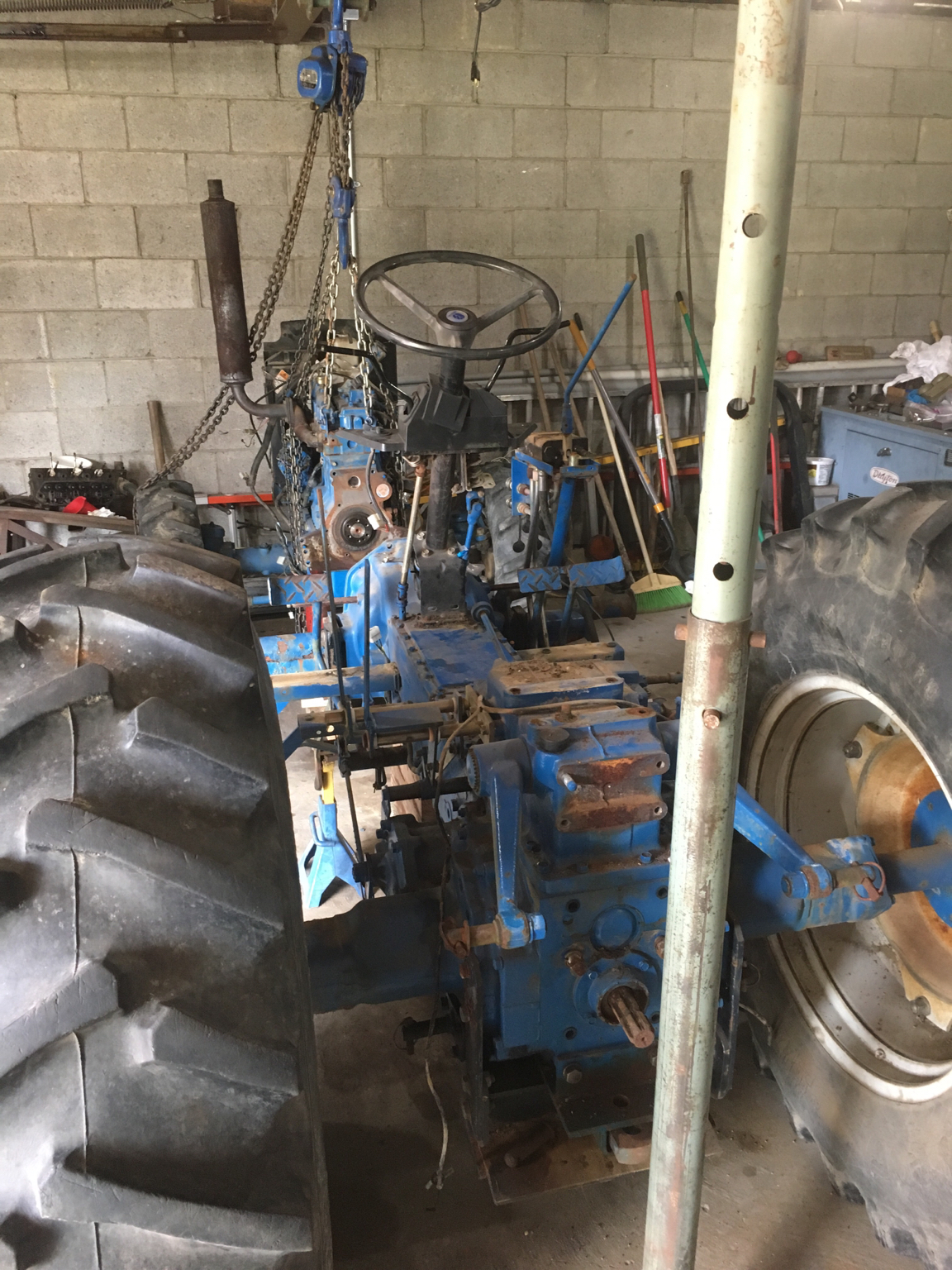

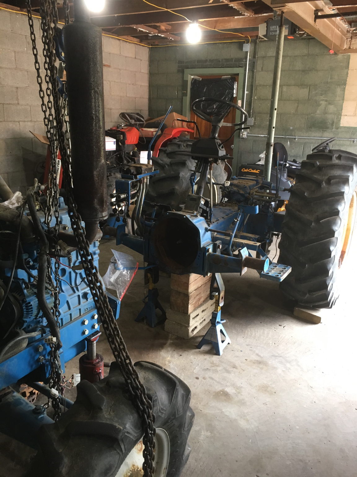

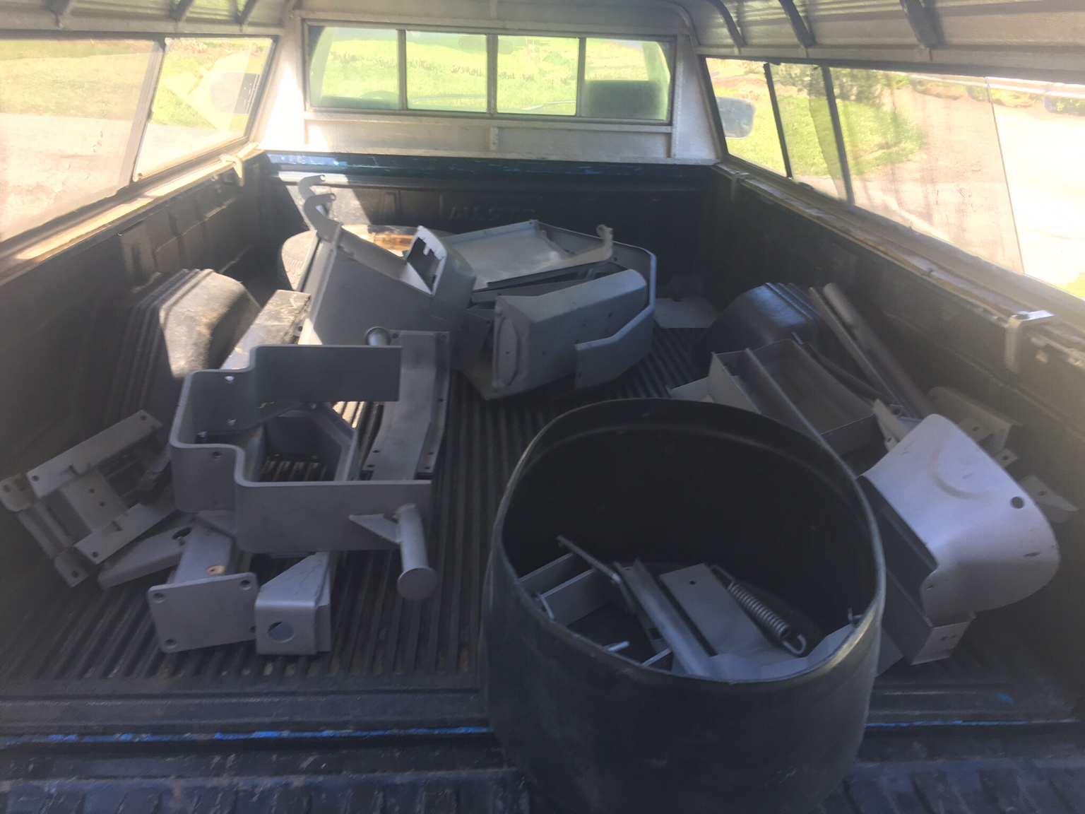

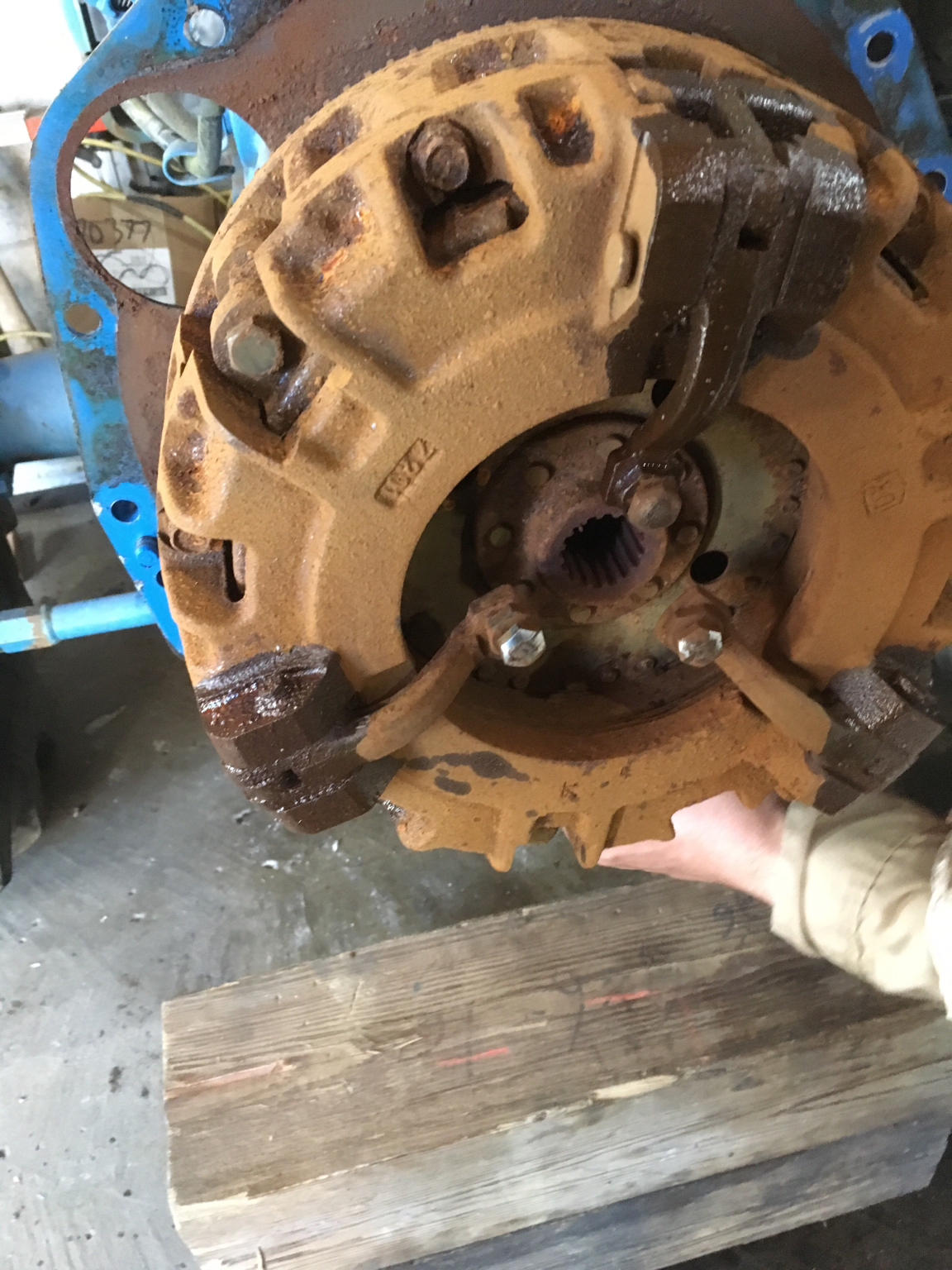

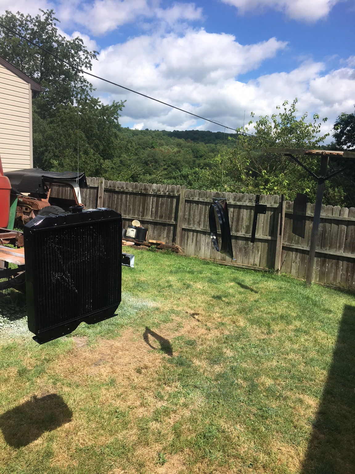

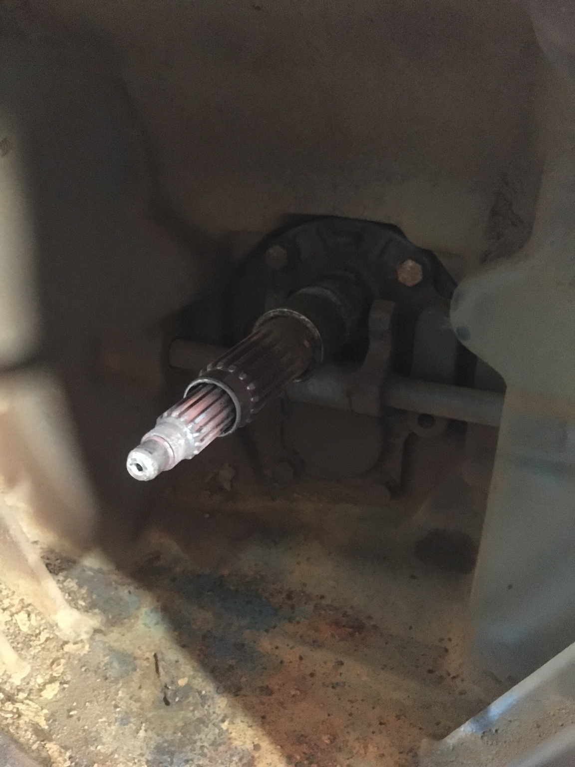

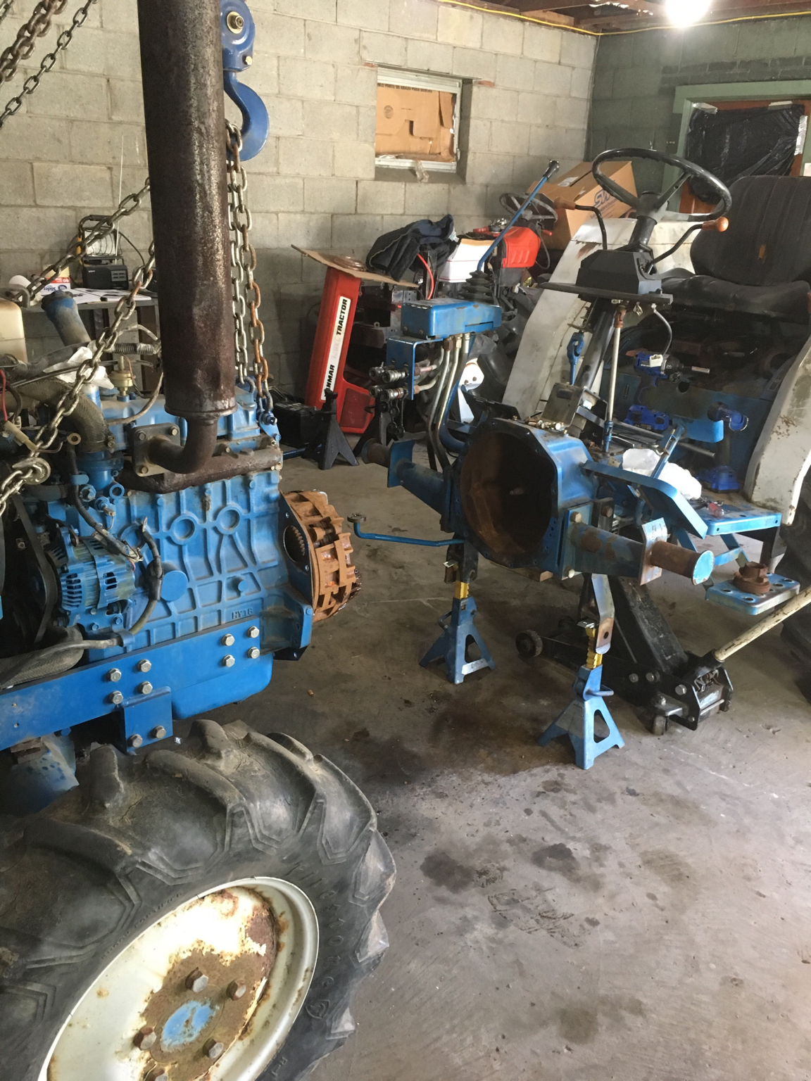

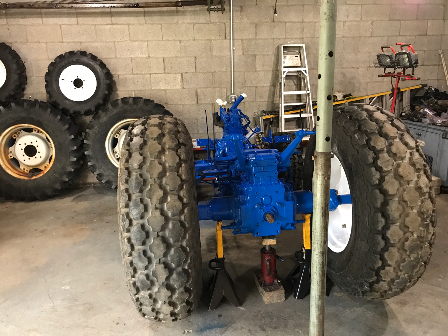

Well a ling overdue update the clutch was one solid piece of rust and the roll pins in the fork where sheared. Fly wheel turned new complete clutch and new shaft and fork. It back together but then pulled front axel off to remove oil pan and take a peek in side. All the tin was taken off and blasted. Needs primed and painted. New water pump thermostat and hoses and belts need done too. Attaching some pics of the progress IMG_5831.JPGIMG_5832.JPGIMG_5833.JPGIMG_5840.JPGIMG_5841.JPGIMG_5842.JPGIMG_6012.JPGIMG_6013.JPG

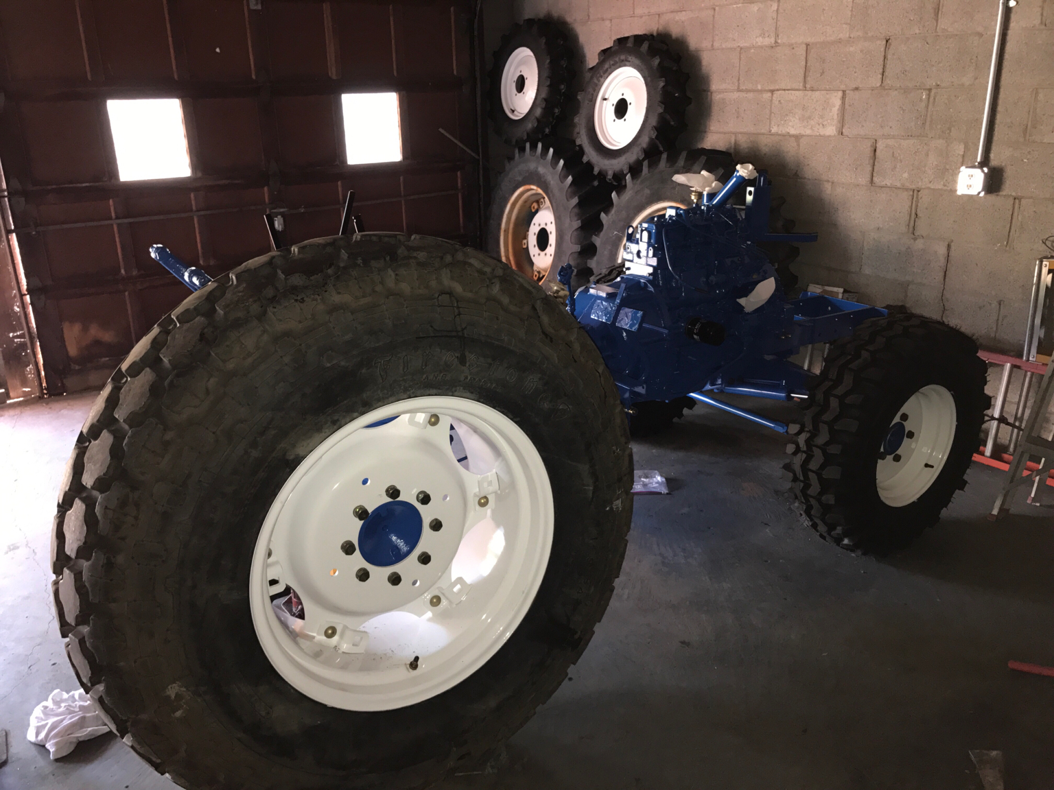

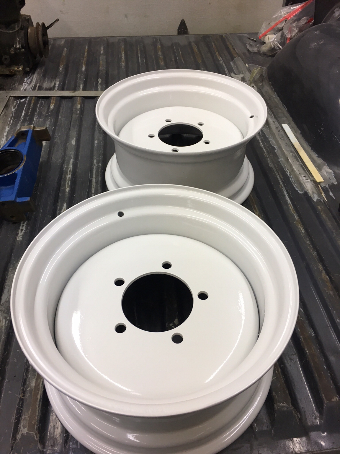

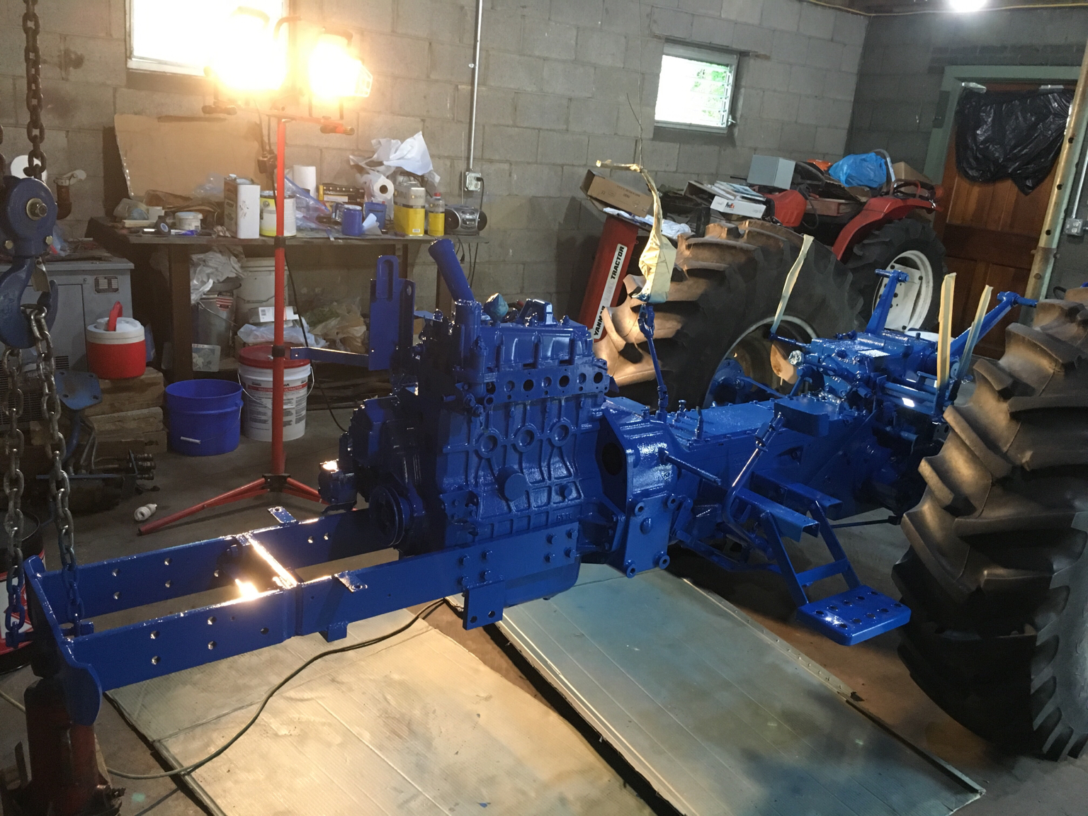

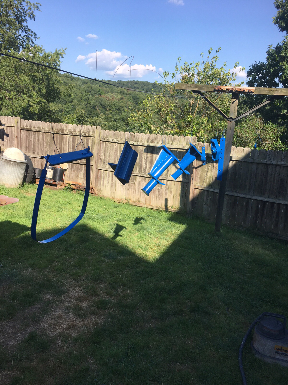

Well it's been a while but it's starting to go back together IMG_6317.JPGIMG_6318.JPGIMG_6378.JPGIMG_6380.JPG

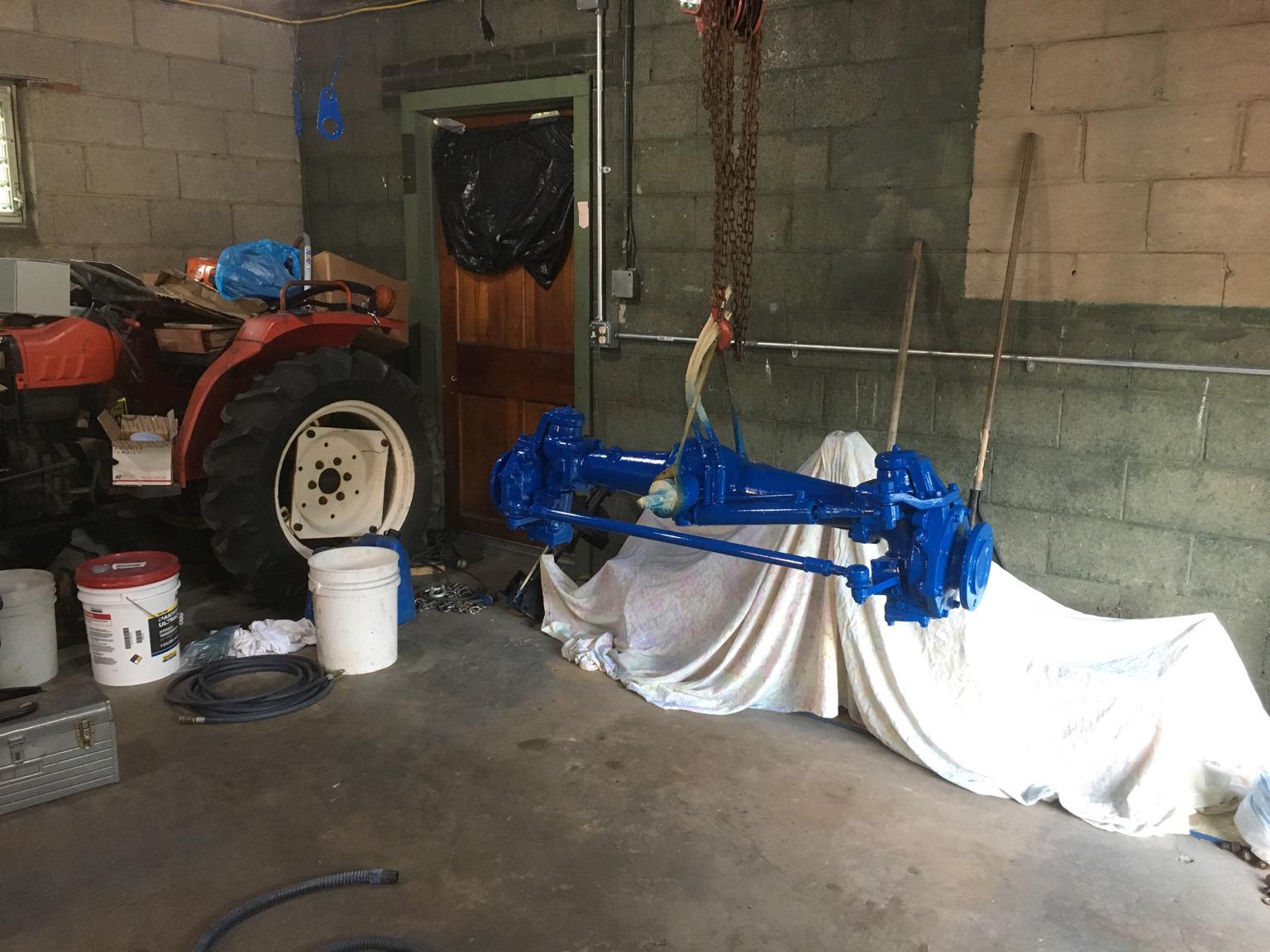

And a few more IMG_6382.JPGIMG_6384.JPGIMG_6383.JPGImage1502836425.967865.jpg

You are doing beautiful work!
My 1989 Ford 1920 4x4 (1056 hours ), has a very different rear wheel bolt pattern.
There are many more wheel to hub mounting bolts in my rear wheels.
I did a complete refurbish, and paint job two years ago, but did not do as much disassembly as you, because in my case, it was not needed.
Mine now has what I believe may be a broken clutch fork, so it will be split again, next month.
