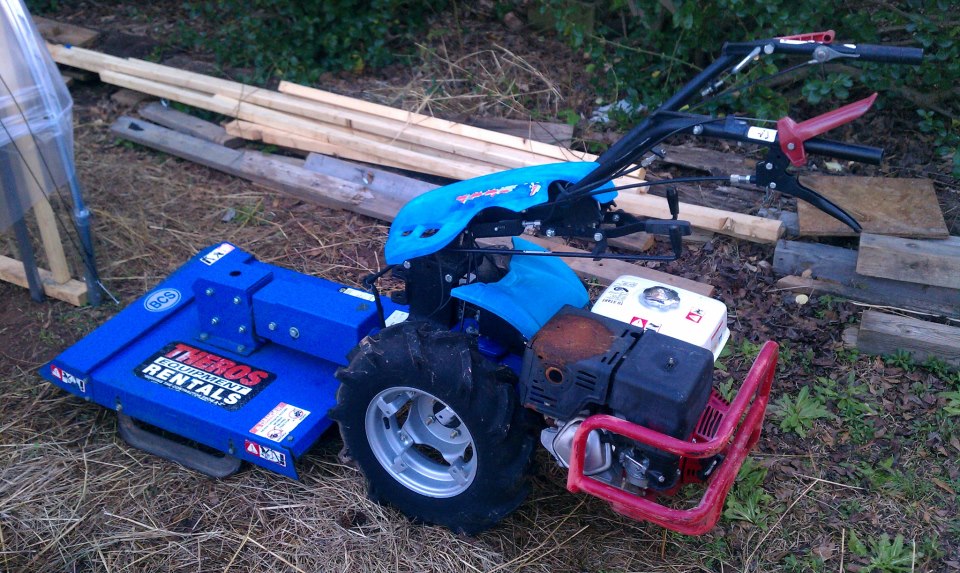

It is awesome, got it with the brush mower for just above $1000 after TAX. I got it from Theros Equipment Rentals in Virginia, after lurking in these forums and someone mentioned them.

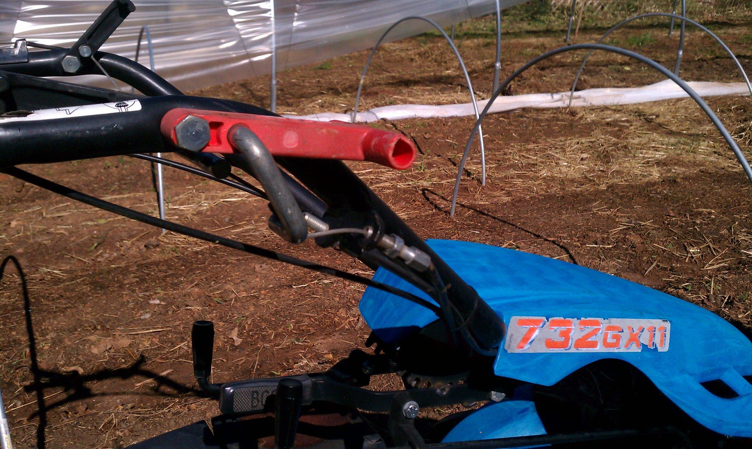

I am trying to figure out how to get it into reverse though. The red lever on the right handlebar does not change anything that I can figure. Although the guy at Theros did have it in Reverse right before I hauled it home to Georgia.
I have only had a few minutes with the machine, but want to get it figured out asap! Thanks guys!

The red lever on the right is your reverse. Is the cable ok?

Where does the lever need to be for it to go in reverse? It only locks into position when it is tucked in on top of the handle bar, if I try to lock it in the forward, it does not stay. The cable seems OK, the rental place I bought it from had it in reverse right before I left. What should I look for on the cable? Thanks !!

The 732 does not have reverse in transport gear It will come at you fast if you reverse it in that gear, as you discovered. Do you hear grinding after you flip the lever and engage the clutch? If so, adjust the cable sleeve length. There's an adjustment at the end of the cable just in front of the lever on the handlebars. Turn it out.

There is a picture of my lever and the adjustment set. If I screw it all the way out like this it will kind of stay there, but does not affect anything when I took off the clutch and put it to gear. It still only goes forward regardless if I place it forward or leave it in the middle which is as far as it will go back with the nut like this.
I followed the cable down to the transmission and am wondering if there is a way to manually move it into reverse from there? Just to test it out.

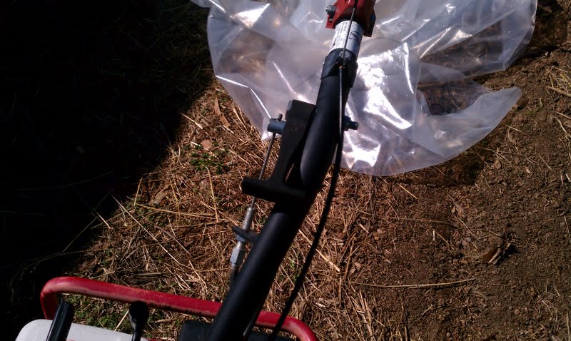

Another question: How do you turn it from mower to tractor? Which handlebar has the column control?
Here is a picture of left handle bar
Thank you!!

I was searching around the forums a bit and found where farmerboybill, you were saying you had several stuck handlebars that did not rotate. I think mine is like that too, I sprayed a bit of w-40 today but did not budge much. Gonna try some more tomorrow.
/ Just got a USED BCS 732 #11
The 605/737/830/850 handlebar system is considerably different than the 732. The 850's pin is completely enclosed in a piece of pipe. It is very susceptible to seizing, especially if it has been exposed to winter salt, and very difficult to break free if seized hard. I don't have a lot of experience with the 732 and 853, but they do not have the same design, it's more of a yoke around the pin than an enclosed pipe - much easier to break loose. I worked on an 852 last summer with a seized column and it took about 20 minutes and very little tear-down to break it free. It had spent all its life on a sweeper in snow (ah, salt).

Thanks for your help. I checked out the reverse linkage more and it is only moving 2-3mm when I move the lever. I took off the nut holding the cable to the linkage and the linkage dropped about an inch, to where now I can move it with my hand up and down about 1.5 inches. Problem is, the cable was terminated about 1/2 inch above where the linkage dropped to.
Anybody know how much clearance the linkage is supposed to have on top and bottom? Can I replace the cable with something easily available that will be long enough to have linkage set up right?

From the video, it looks like the lever down below is sticking. When you release the T-bar forward, that spring down below should pop that lever to forward or reverse (depending on the direction of travel). If it worked at Theros, it sure should still work now...

I replaced the steel cable running down, it was too short and would not let the reverse linkage drop down. With new cable it is able to move correctly and now that problem is fixed, as long as the clamp at the lever holds on. It took some adjustments but I think it is right now. There was some grinding when i put it into gear, so i adjusted the clutch like you mentioned and fixed that.

But there is no video for how to adjust the cable going from the black t-bar on handlebar to the steering column, which would let me swivel the handlebars. Right now it is so tight that it will not let me move the T-bar all the way up. I adjusted the nut all the way out making it as loose as possible at handlebar but not enough.

Do you see the cable move at all when you pull the T-bar? The distance needed to move the pin that locks the steering column is less than an inch. I don't think you'll pull the T- bar all the way back like you do the reverser or the diff lock. Once the pin is released, the handlebars will swing. They only go one way. If you can't swing it once the pin is released, or if the pin doesn't release, you'll need to take the pivot apart. This is much easier to do on the 732 than it is on an 850. remove the bolt that goes crossways on the pivot. From there, it's a simple matter of popping the column off - but, the steering column will still be connected by the various cables. You can then get to the pin if it's seized, or just break loose the pivot and use some anti-seize on it.

I took off the steering column like you said, lubed and freed the pin, and adjusted the t-bar cable length. It works great now! I think it is all fixed up, you guys rock! Thank you!! Ill post a video asap
