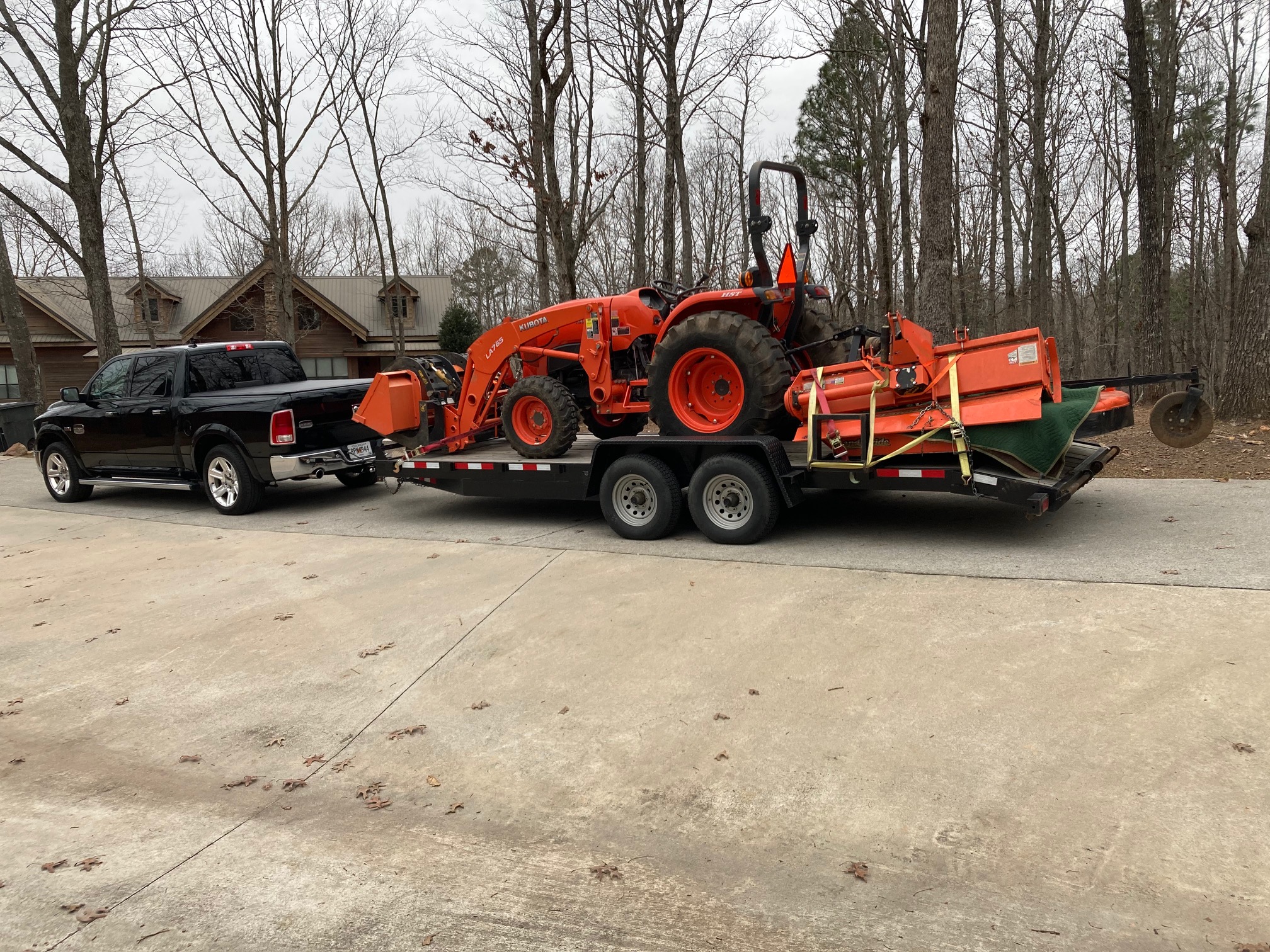

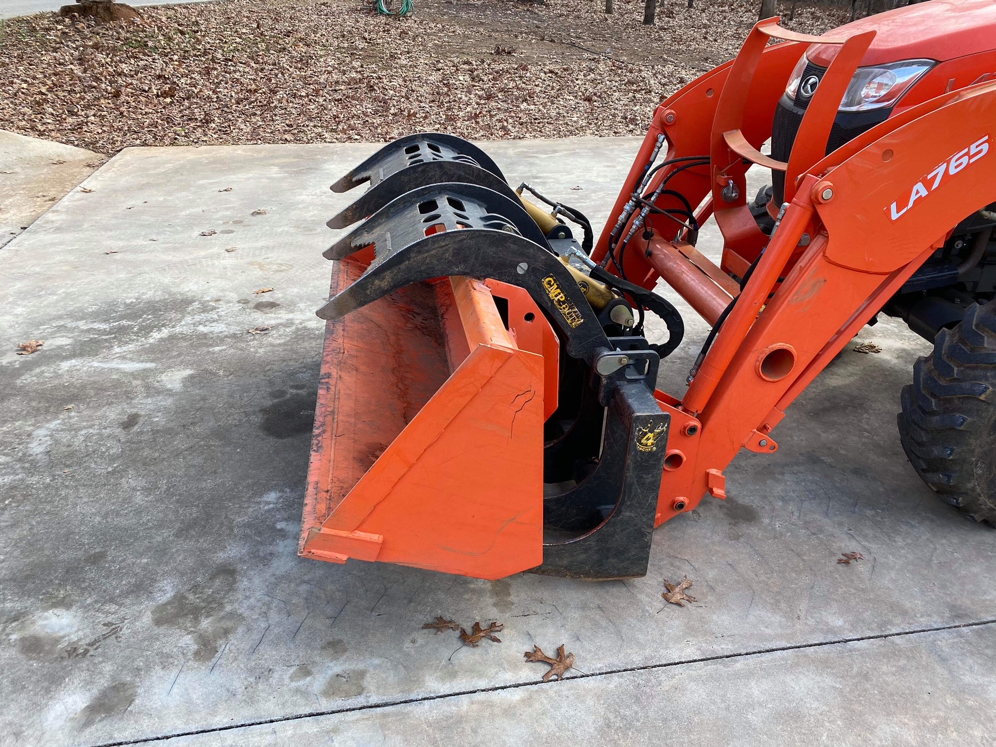

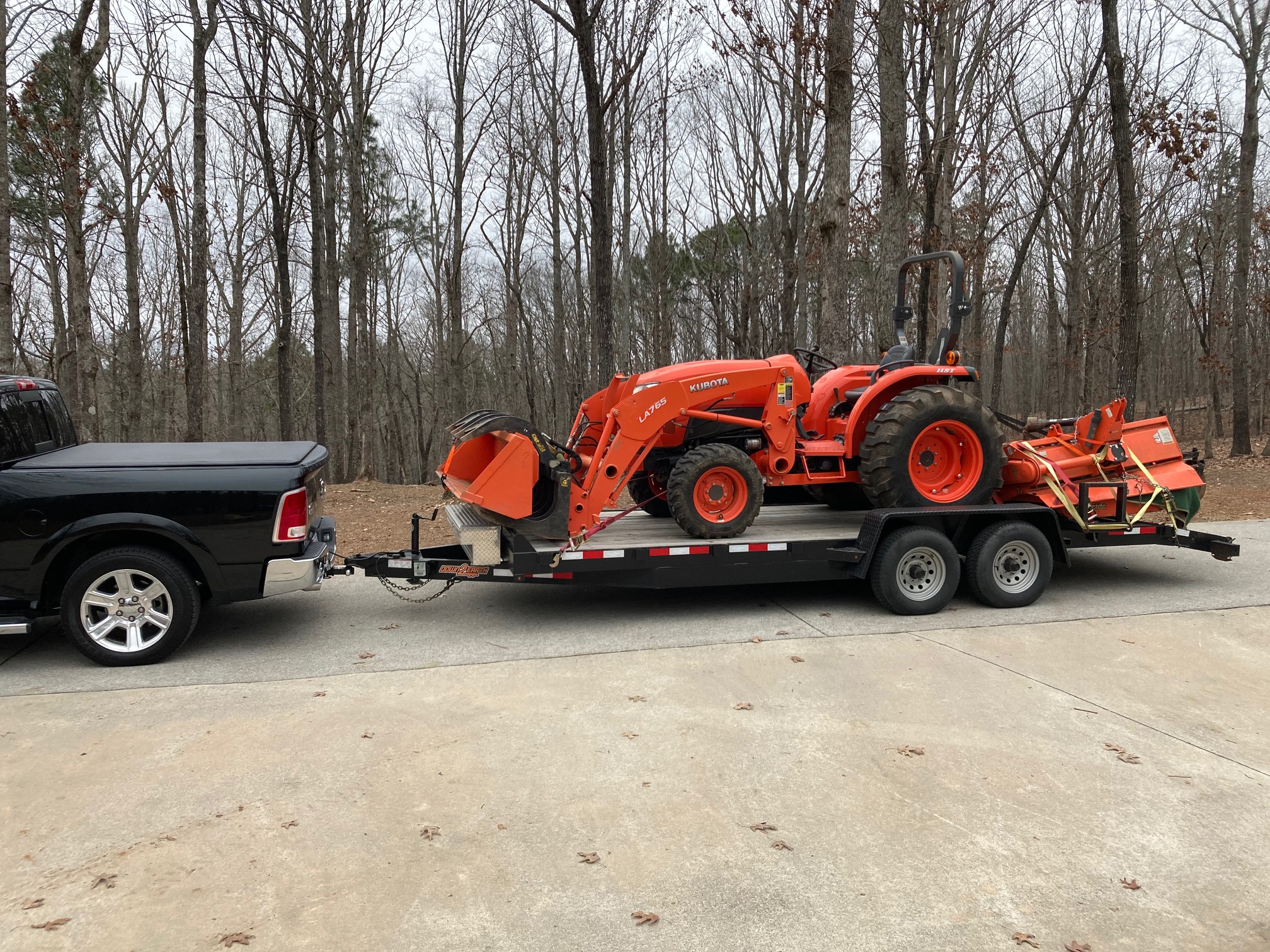

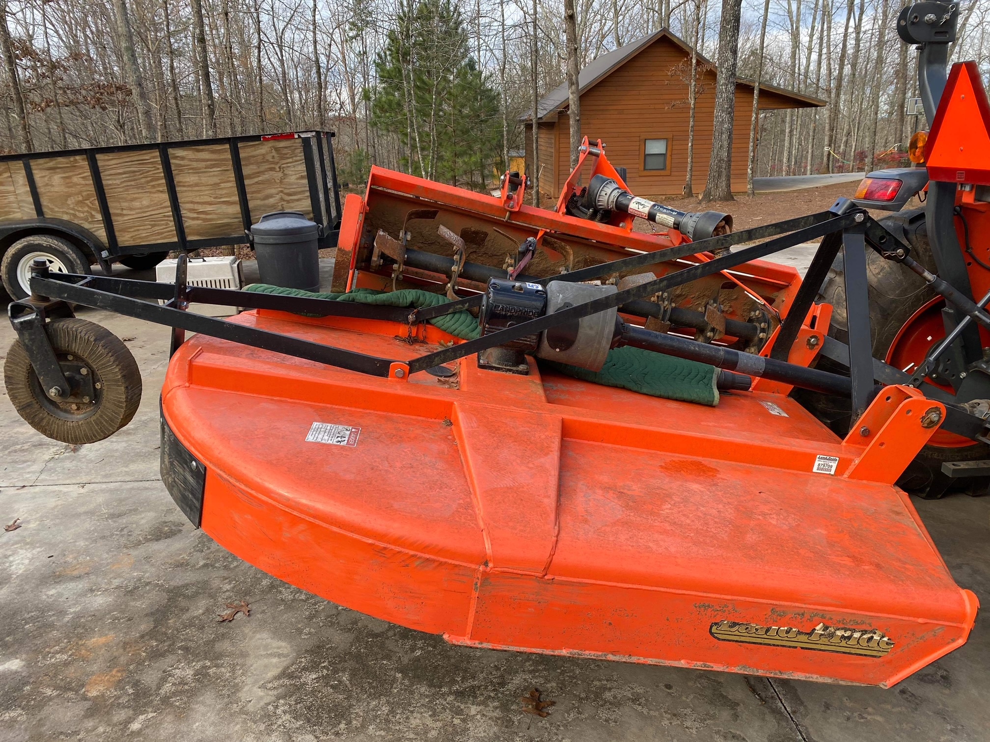

I've been shopping for a Tractor for around a year and finally got lucky yesterday. 2015 L4701 HST with 125hrs, Grapple, Bucket, Brush hog and tiller. I'd been looking at new L2501's, but was concerned about lift capacity with the grapple, and the Kioti CK2610 but didn't love my local dealer. This popped up a couple hrs away on FB marketplace and I sent the guy a deposit immediatly. Decent tractors sell instantly around here. I ended up with a lot more tractor than I ever though I'd have, but I don't ever hear anyone complaining about having 'to much' tractor...

Damnnnn, that poor RAM truck! You need to throw a couple air bags inside the rear springs.
Actually i`m surprised you didnt blow a rear tire by the looks of that first picture. Thats some SERIOUS weight!
