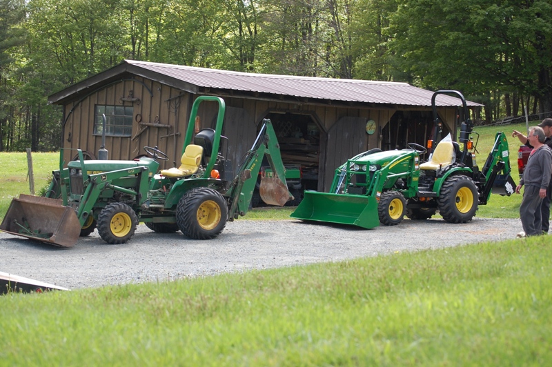

Pictures! First tractor is my old 650, new one is a 2320

Gizmo2:
Nice Pictures :D! Jay :)

I had not seen the safety section. I'll become very familiar with that. My property is sloped so I will be sure to get a good feeling for this thing before I do anything on the hills. Mine looks just like the one in your picture Gizmo, without the FEL.

PaulChristenson said:
Thanks Gizmo...I always wondered what an FEL was for...To carry spare parts or is that your 3 pt hitch??...:D
LOL! It's the 3PH in the bucket. Really thought hard about keeping the 650 for a backup tractor. Dealer delivered the 2320 and took the 650, a sad day that day had the 650 for 20 years. But now...don't miss the 650 at all and my wife really likes the 2320, gear vs HST, power steering vs manual. If you don’t have a FEL loader how do you hang xmas lights and paint the house?
/ Just bought my first tractor #19
Gizmo2 said:
LOL! It's the 3PH in the bucket. Really thought hard about keeping the 650 for a backup tractor. Dealer delivered the 2320 and took the 650, a sad day that day had the 650 for 20 years. But now...don't miss the 650 at all and my wife really likes the 2320, gear vs HST, power steering vs manual. If you don稚 have a FEL loader how do you hang xmas lights and paint the house?
Look at the Bulk Bag Hopper-Dispenser System picture...and then imagine a person where the Bag is...:D
