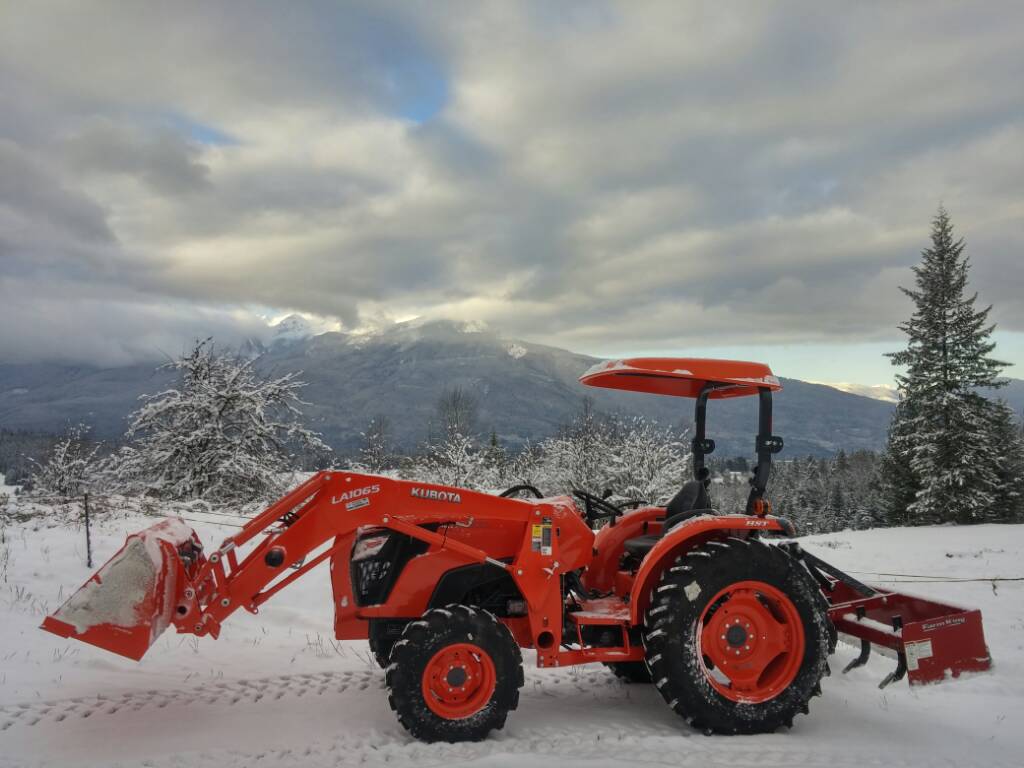

Tractor came in yesterday and I'm confident I made the right choice. Mx5800 with HD bucket, rear remote, third function, hyd top link, rear LEDs,and canopy. 84" farm king box blade as well. Off to burn slash piles😀

Good looking machine! Have fun with it.
   / Just Bought My First Tractor - MX5800 #37
Congrats... You bought one of the best tractors out there. You will love your MX, they are beasts..
